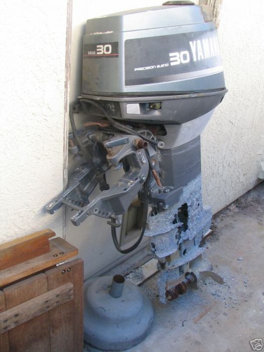

heres some saltwater damage lol
Re:Salt water outboard 13 years 5 months ago #67691
wow, is that eaten right through? how long was that in the water?
