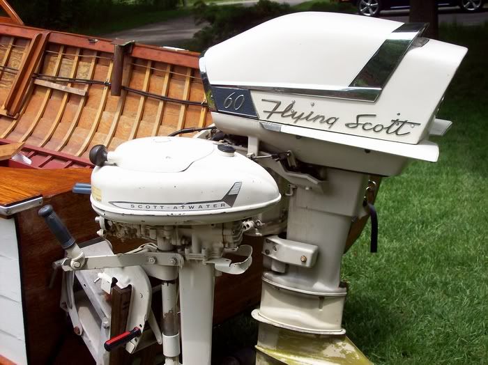

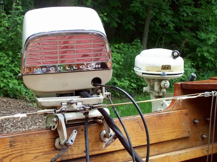

Someone asked about the kicker on my boat. It's a '58 Scott Atwater 3.6hp. Came original painted same color as the Flying Scott. I have another badged as "McCulloch" trimmed in dark green. Sweet little motors...you can almost count the RPMs at low idle!
Re:Complete 1962 Flying Scott 17' 13 years 11 months ago #69873
Ponyboy,
Mine pees fine straight out of the hole. I'm not picturing how you did yours. But you are right, mine was clogged with dirt. Just poked it out with a finishing nail. Shoots water about three feet to the port side.
