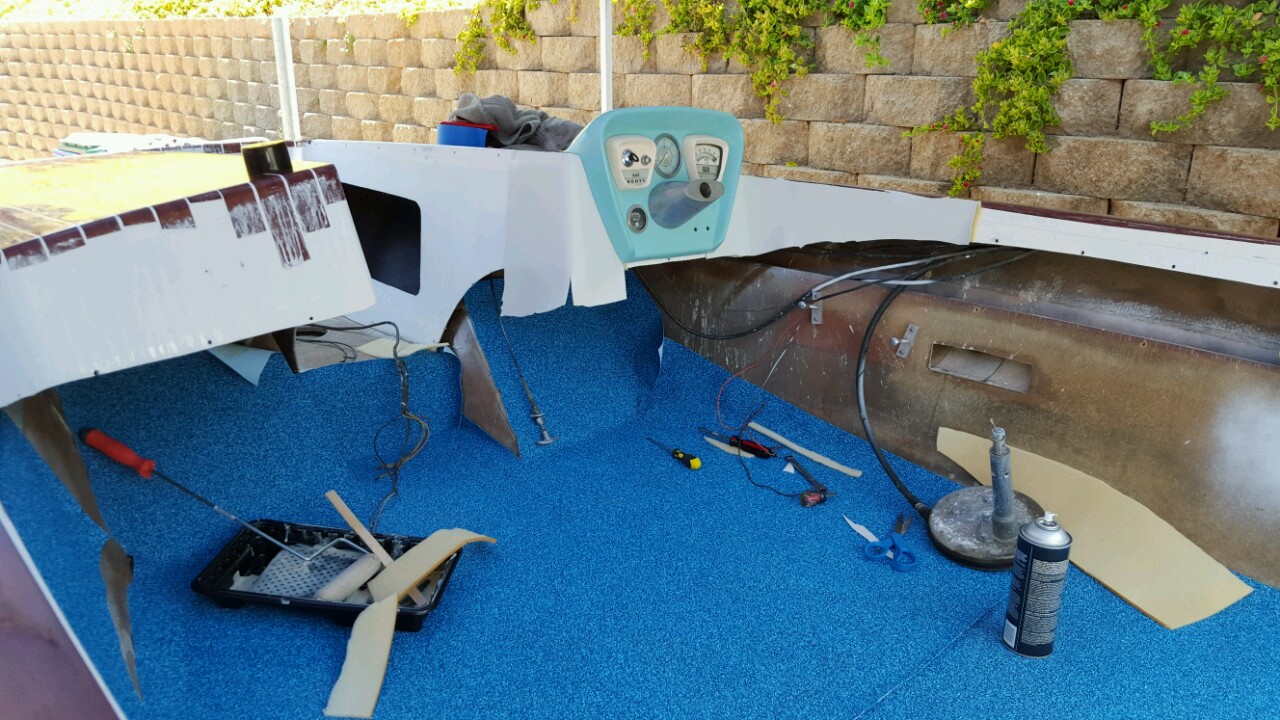

Re:Complete 1962 Flying Scott 17' 11 years 2 months ago #111439

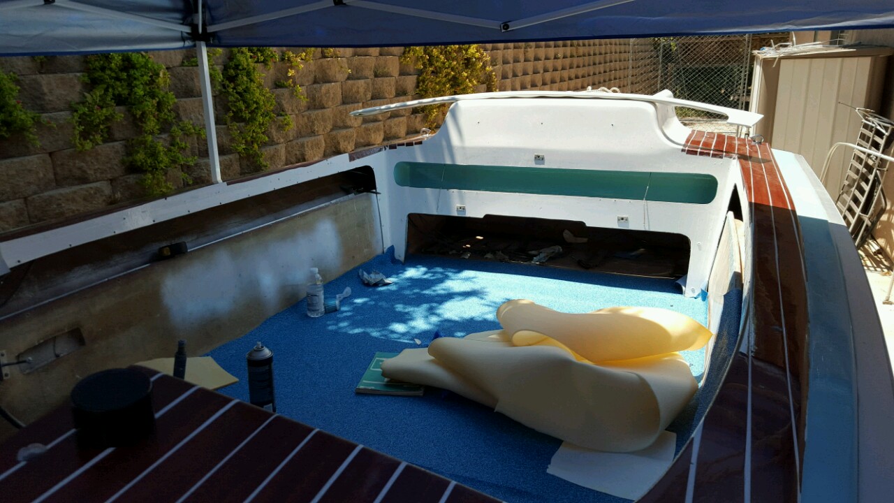

Well after all these years and a 10 month Navy deployment I am happy to say that work on the Scott is going great! The interior is almost finished, the seats are in the shop, new flooring is in, the deck has new mahogany, and today I am finishing up some turquoise paint.
The lower unit has me a little stumped though. I posted a question the the outboard section if anyone had any help I would appreciate it. Pics coming soon I promise!
Tyson

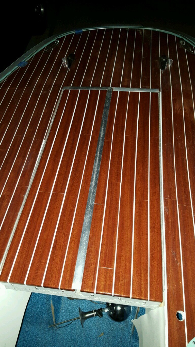

Re:Complete 1962 Flying Scott 17' 11 years 2 months ago #111448

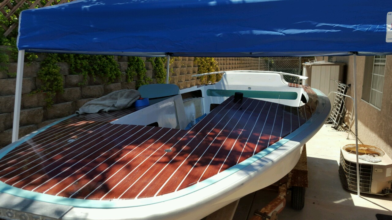

Deck
Re:Complete 1962 Flying Scott 17' 11 years 2 months ago #111449
Interior
Re:Complete 1962 Flying Scott 17' 11 years 2 months ago #111450

Re:Complete 1962 Flying Scott 17' 11 years 2 months ago #111453
Good to see you back at it! She looks great! The deck is outstanding!

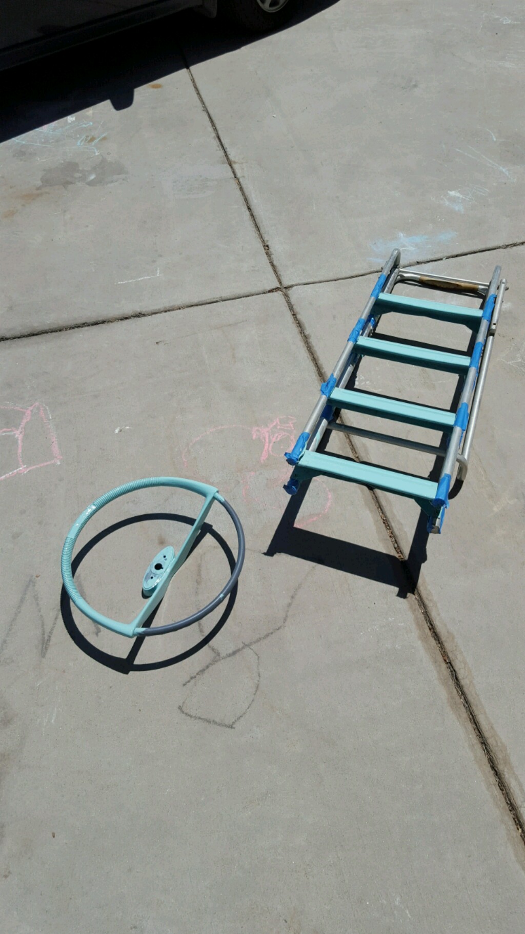

Re:Complete 1962 Flying Scott 17' 11 years 2 months ago #111519

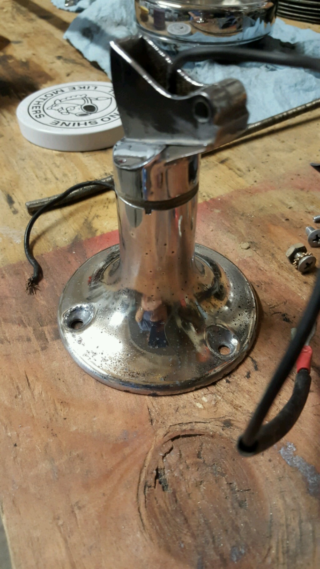

Spent time today repainting my steering wheel since I didn't like the way it turned out. Also polished a bunch of stuff, here is the spotlight before pic:

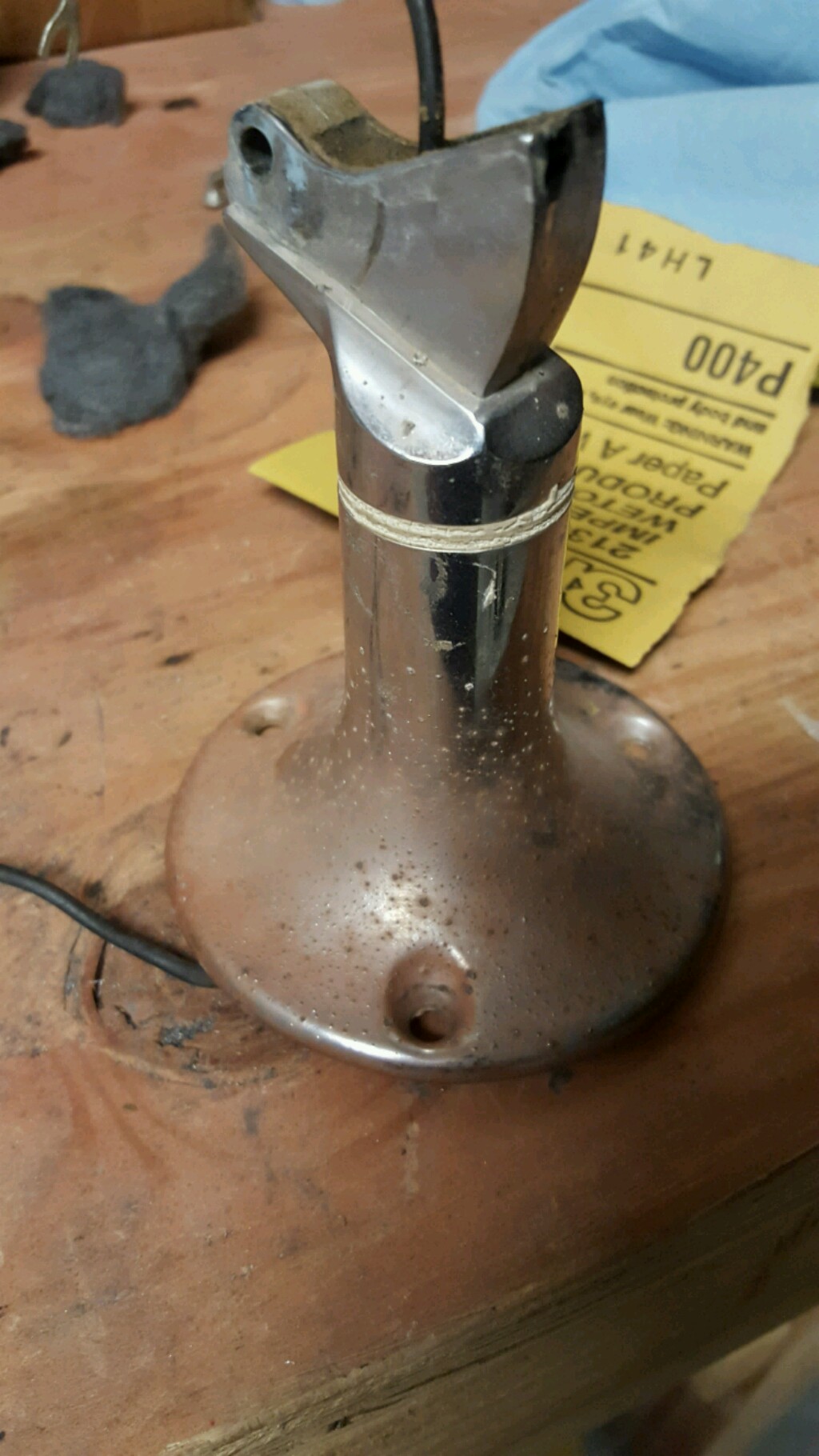

Re:Complete 1962 Flying Scott 17' 11 years 2 months ago #111520

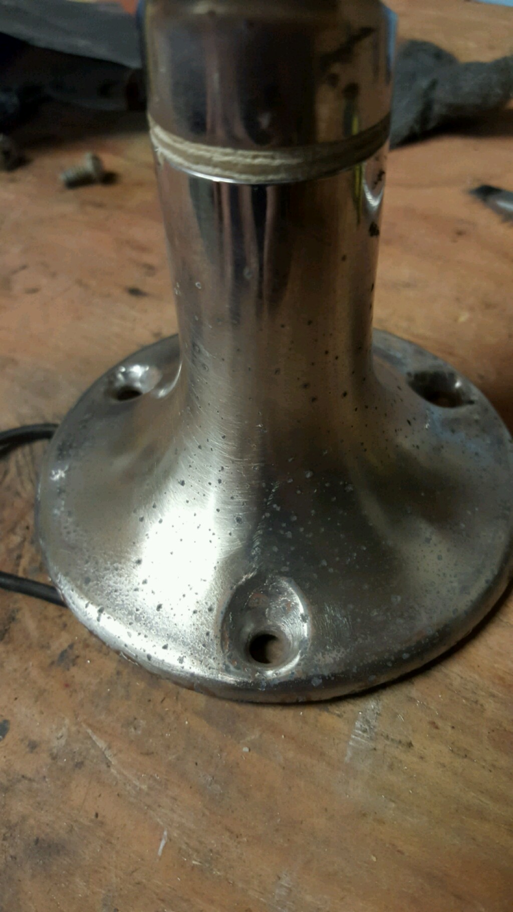

I sanded the base with 220, 400, 600, 800, 1200, and 2000. Then I used 0000 steel wool to get it some shine. Here it is after the 1200:
Re:Complete 1962 Flying Scott 17' 11 years 2 months ago #111521
And after polishing
Re:Complete 1962 Flying Scott 17' 11 years 2 months ago #111523
Excellent, she's coming a long nicely, great job!

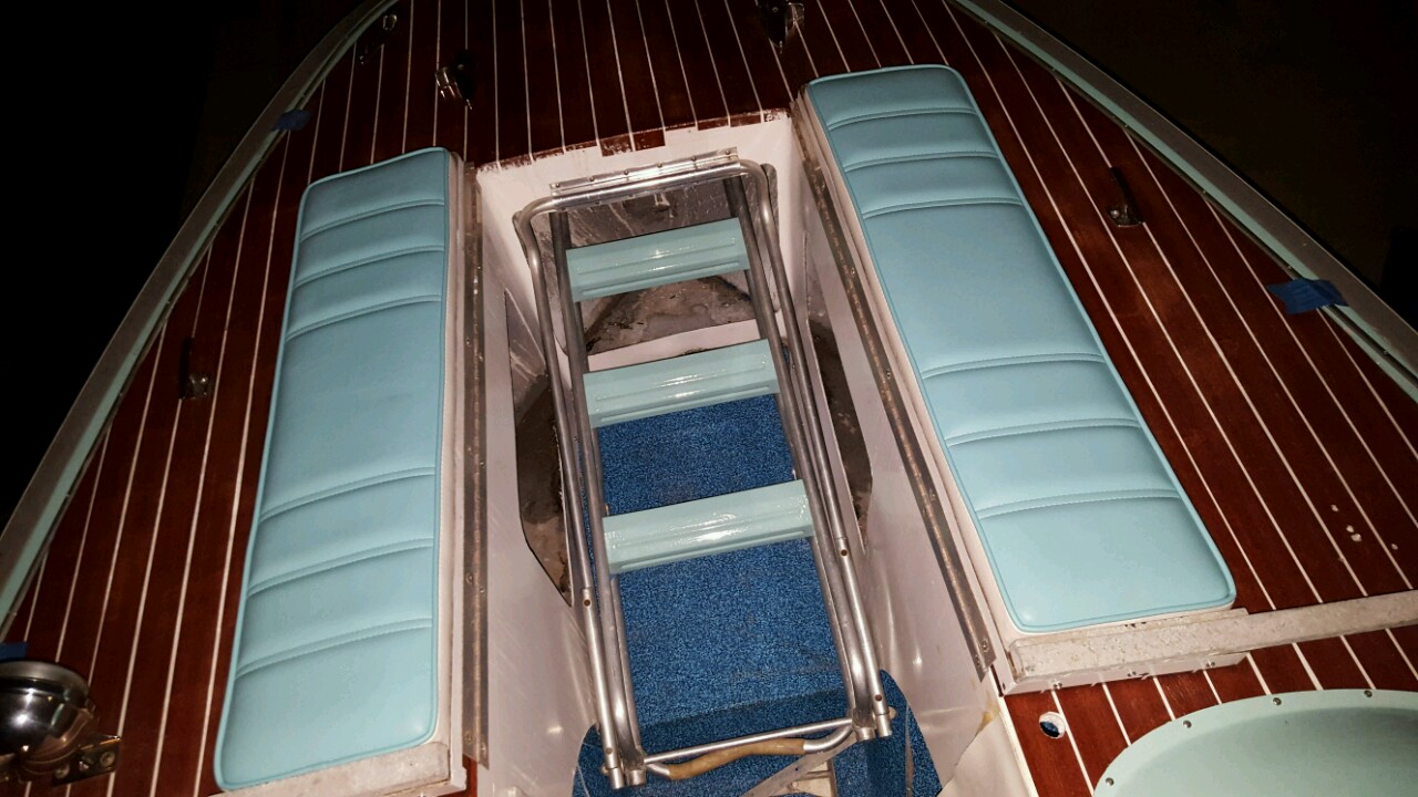

Well the good news is that, although slow, she is making decent progress. I got the motor running well, finished the bow hatches and the rest of the mechanical, got the seats in it. Here are a few pics

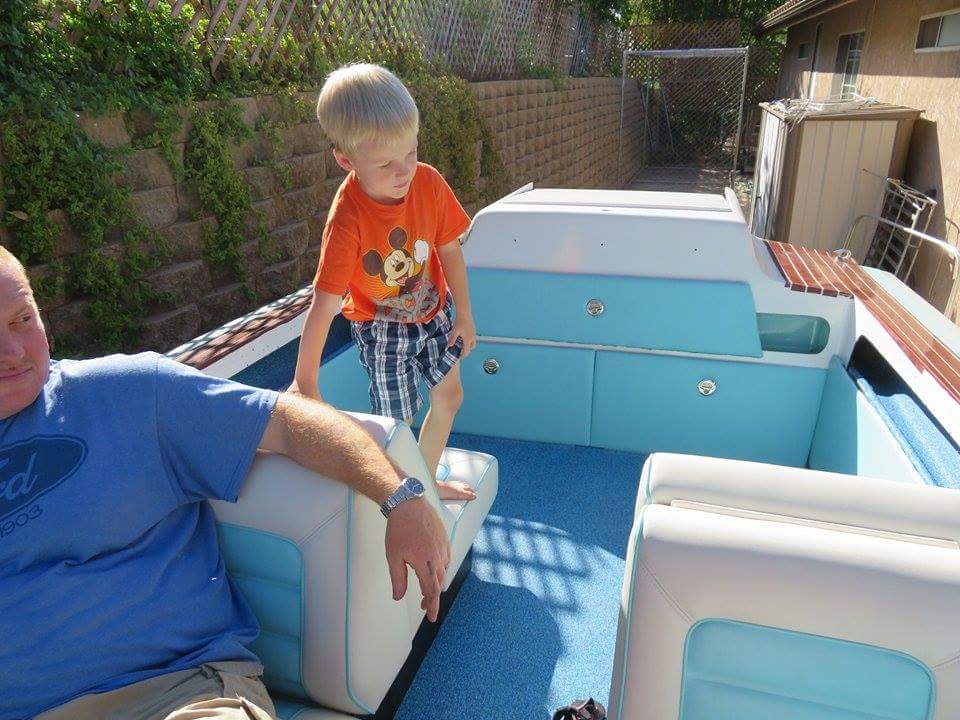

Re:Complete 1962 Flying Scott 17' 11 years 1 month ago #113101
The kids enjoying the new interior.
Re:Complete 1962 Flying Scott 17' 11 years 1 month ago #113102

^^^^Pretty much nothing I do can get these pics of my kids playing in it to show up. More to follow on that...

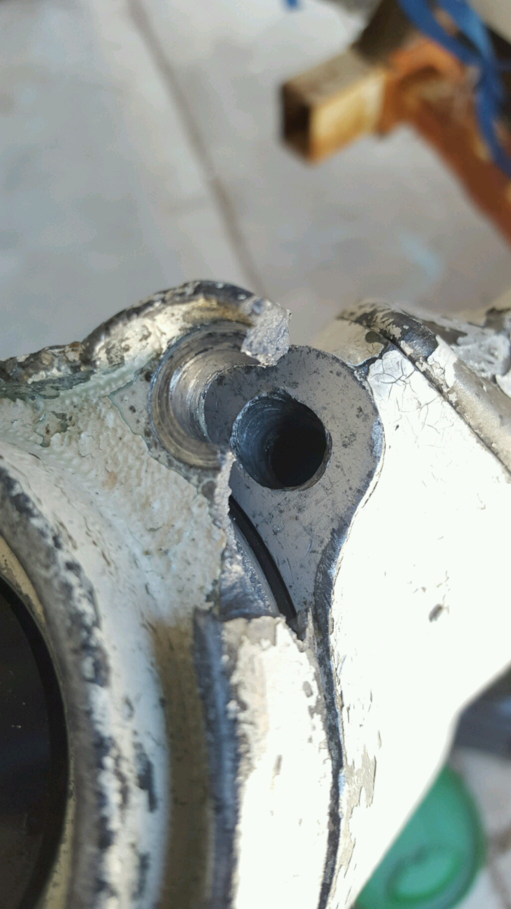

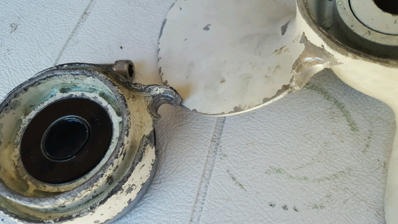

So today I took the boat out on its maiden trip and it ran okay, except for a little carb adjusting. After about 30 minutes of tooling around the motor would lose all power at high RPM and cut out. I thought it was a carb issue so started up a few times with minor tweeks. After the 3rd start up the motor would not engage the gears, only Rev up.
Upon pulling up the motor this is what I found:
Re:Complete 1962 Flying Scott 17' 11 years 1 month ago #113104
The upper screw in the prop hub had loosened itself up, the was banging against the prop until it finally snapped the ear on the hub (and made a nasty stripping of the threads.
Re:Complete 1962 Flying Scott 17' 11 years 1 month ago #113114

Sure did. With the help of eBay I purchased a good lower end. Now my gears all function as the should, the impeller gets a spare, and since I adjusted the shift arm on the motor everything seems to work fine...although when I put it into reverse the cable comes out of the tube too far so when it goes to shift back to neutral it gets caught onto the tube... more on that later

This was the culprits the first time. I neglected to shim the hub and thus, the screws were not tightened down enough and caused the top one to vibrate out. My replacement lower had these included.
Re:Complete 1962 Flying Scott 17' 11 years 2 weeks ago #113928
Flying Scott,
I have attached a procedure for correctly shimming the prop shaft bearings for a three cylinder Scott.
Because of manufacturing tolerances and differences in bearing race thicknesses, each motor needs a specfic amount of shims as shown in the overhaul manual. I believe the shims come in three sizes, .005, .010, and .015.
The procedure shows how to set up ther correct endplay using an inch pound torque wrench.
The shims that came out of your newer lower unit look like a mixture of cardboard and metal shims. Only metal shims were used at the factory. The cardboard may have been used because the correct metal shims were not available when someone rebuilt the lower unit previously.
If you used the procedure and your endplay falls into the specs, no problem, but it's rare that shims from one lower unit set the endplay correctly on another lower unit. Also it could be that requiring the extra shims was because the rear bearing race is not pressed in correctly, or the shim for the race was not used.
If you do need shims I have a few extras or they can be made from brass or stainless steel shim stock. Email me.
This procedure was taken from the 1957-1959 Scott rebuild manual, but is the same for all 60 and 75 HP motors.
Don
Re:Complete 1962 Flying Scott 17' 11 years 2 weeks ago #113935
Thanks that's useful info. I have the cap torqued down and there is almost no torque on the shaft.
Re:Complete 1962 Flying Scott 17' 11 years 2 weeks ago #113936
Oh and I forgot to mention that I used the new cap and gear housing as a pair....I sorta had to.
I used the new gears also because the prop shaft didn't lock up when I tightened the cap down like the old one did.
