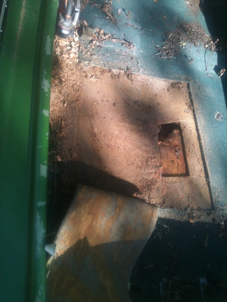

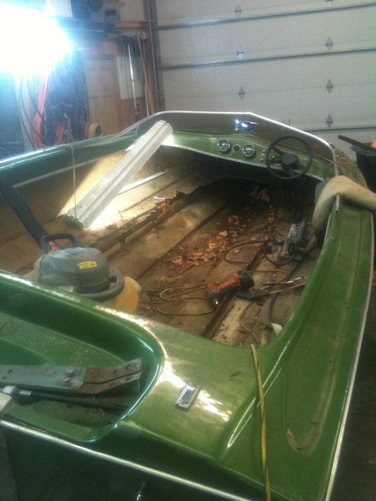

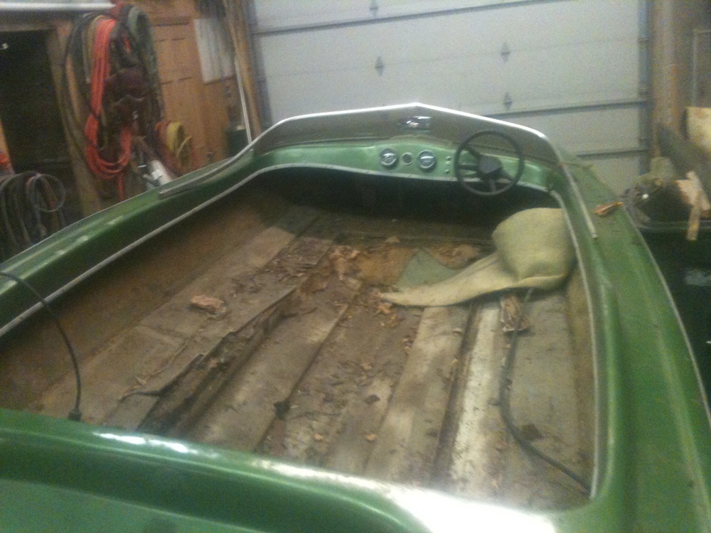

I started messing with the old 17' pointy looking boat, not sure what it should be called. Looks somewhat like a knockoff of the James Bond Glastron, but made by Reid Marine in Ft. Walton Beach, Fl in '73.
At any rate, the foam under the floor, and there was a lot, was all waterlogged. Along with the plywood. The boat itself is very well constructed. All hand laid, good construction, deck and hull glassed together all around.
Now, here's the thing that puzzles me. I've stripped half a dozen boats like this. I've hauled away truckloads of soggy foam. This is foam that is supposed to keep the boat afloat, and of course it wouldn't. So, when rebuilding, what do you use? The 2 part foam that is poured in? What is the difference between that and what I just took out? Have they changed it so that it doesn't soak up water now? Can you leave drainage below the foam, and maybe keep iT from absorbing water? What's a guy to do?
