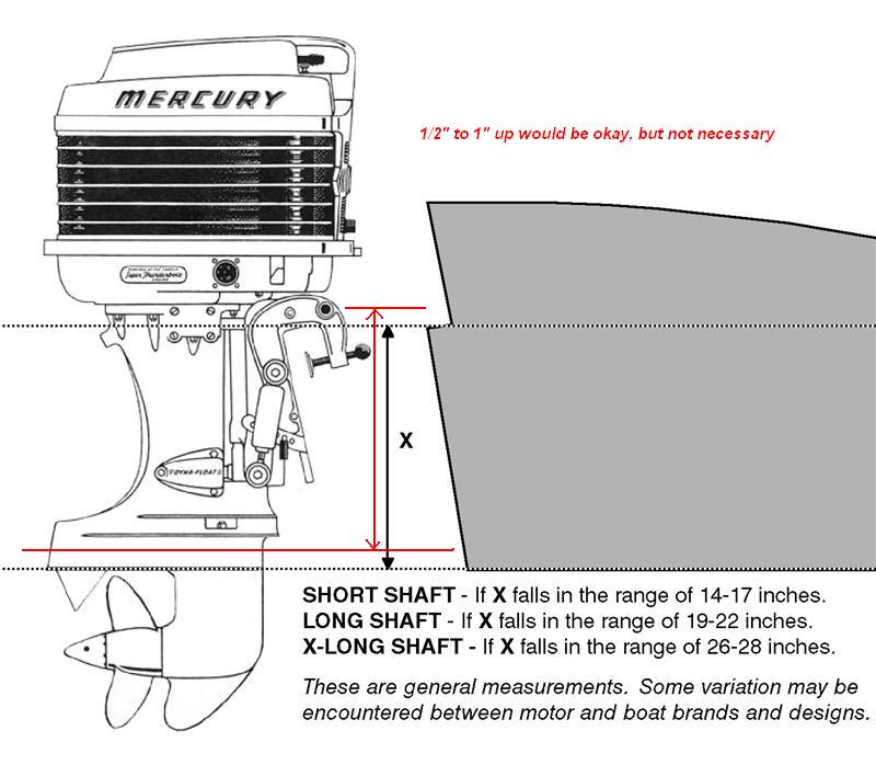

Sounds to me like you need a 15" shaft Delirious, are you taking the measurement in a vertical line (with the boat level) from the top of the transom to the bottom of the hull? Scott "Chinewalker" (I think?) did a great drawing on this, I'll have to see if I can find it). Generally short shaft is 15", Standard (sometimes called long shaft) is 20", and a true long shaft is 25" I believe.

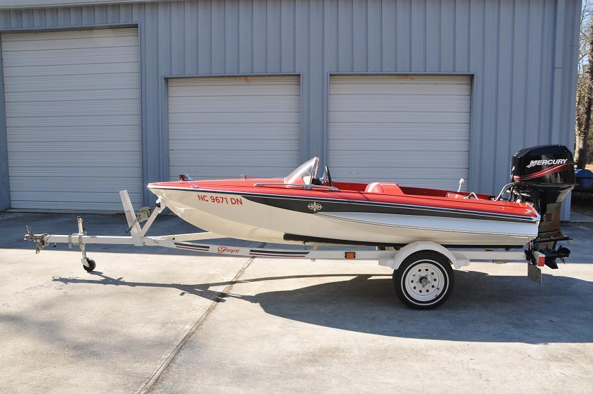

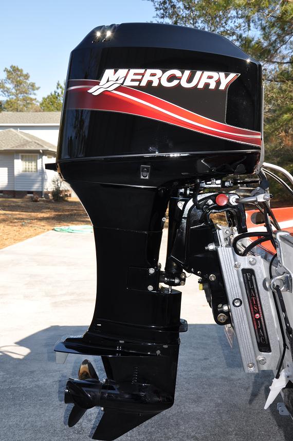

Delirious:
I have a 1960 Glasspar G-3 Skiboat with a short 15 1/2" transom.
I like the original lines of the old G-3's but wanted a newer outboard motor and they all have either 20" or 25" lower units.
I bought a new old stock (NOS) "Mercury" 50 H.P. Two-Stroke. To mount the engine, I purchased a "Bob's Machine" Hyrdraulic Jackplate and then mounted the engine to the jackplate so I could have the new motor with the 20" lower unit. Here is a photo for you of the set-up:
Re:outboard short/standard/long 13 years 6 months ago #66293
Photo of the boat, motor and trailer:
Re:outboard short/standard/long 13 years 6 months ago #66294
Delirious:
I have had NO PROBLEMS at all with this set-up Sir! It has worked excellent even though I was told by some it would not work. You also don't have to go with a hydraulic jackplate as they make fixed jackplates too. They are cheaper than the one I bought. I liked the hydraulic jackplate because I can raise or lower it when I want to and it is real nice when you get into shallow water! ;) This unit has been on our G-3 for three (3) years now.

Here is what Mark S was referring to.
Neil and Mary Ousnamer
Re:outboard short/standard/long 13 years 6 months ago #66388
  • Thank you received: 5
That's the one, thanks Neil!

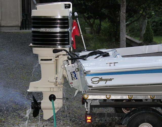

Re:outboard short/standard/long 13 years 6 months ago #66453
Hi Guys,
I grew up with the cav plate at the bottom of the hull rule. I get it. Very conservative and solid rule.
But with my recent experience squeezing performance out of a boat, I've seen (what lots of others have seen before me) that rule isnt necessarily correct, with the goal of maximizing performance/speed from a boat. Merc says in my service manual, that for every 1" you can raise your motor, you see 1-2 mph increase in speed... for sure, I've seen it.
I have the same boat as 1960RedG-3, 1959 G3 with a 15-1/2" tall transom. If my motor was clamped to the transom, it's 15" shaft length would put the cav. plate 1/2" above the bottom of the transom.
Keeping in mind that a boat doesnt run... even on a plane, parallel with the surface of the water. The bow rides at an upward angle, meaning the water surface plane is at the same upward angle in respect to the transom. In the case of a jack plate, or my CMC tilt and trim unit, where the motor is mounted 6" behind the transom... the water surface plane (coming up at an angle) is much higher than the bottom edge of the transom.
On my boat with the 6" setback... I ran my short shaft Merc (15") cavitation plate at 2.5" above the bottom of the transom, and never cavitated. This year I have it now 4.5" above the bottom of the transom... where it breaks loose when the boat drops onto a plane for only a few seconds... and no loss of water pressure even with it trimmed way up at high speed. Soooooo... from my recent attention to setup, I have found that at 6" behind the boat (like a jack plate) 2.5-3.5" there is no cavitation, at 4.5" up there is about 4 seconds of cavitation, as the boat drops onto a plane.
At 45 seconds into this video, you can hear the motor cavitation and then grab traction at 4.5" vertical, with no trim (cav plate is parallel with bottom of hull).
...no big statement here, its just my experience this season and maybe something to chew on. :)
Dean
Bandit - 1959 Glasspar G3
