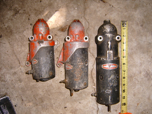

how about a pic of this starter-engine. and could you mesure the lenght of the black case. I have some nos parts Im not ever going to use for the earlyer motors.

here you can see the different starters they used on the 3 cyl from the left is the 60hp starter then the 2 ,75s
Re:Original Flying Scott... should I even try? 13 years 6 months ago #69347
the issue is that the ports for the fuel pump tubes are in the way. they will however bolt up.

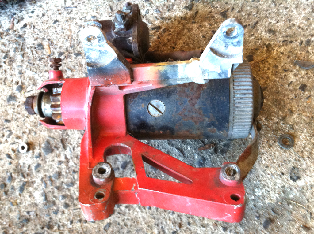

Hey. I found I have 2 of these short 60hp starters and 1 NOS armature. I dont have any way to test them other than to ck with a battery, they both spin quickly, If your interested send me an email. or PM

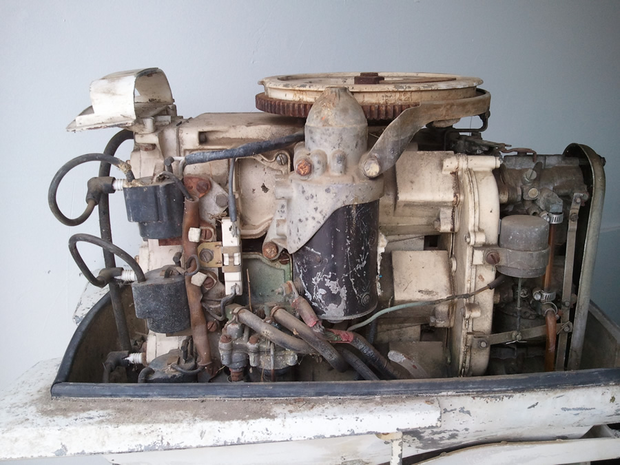

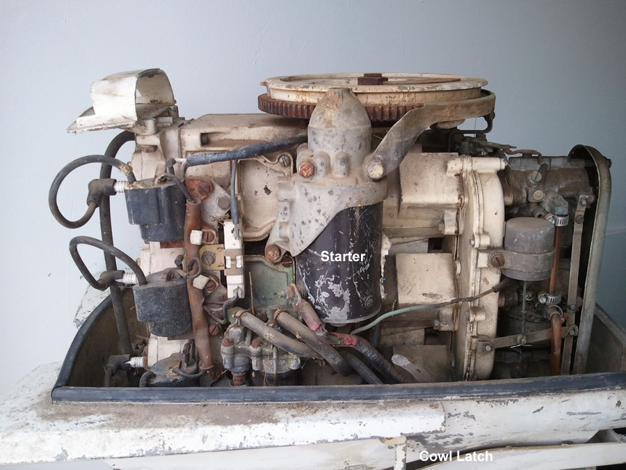

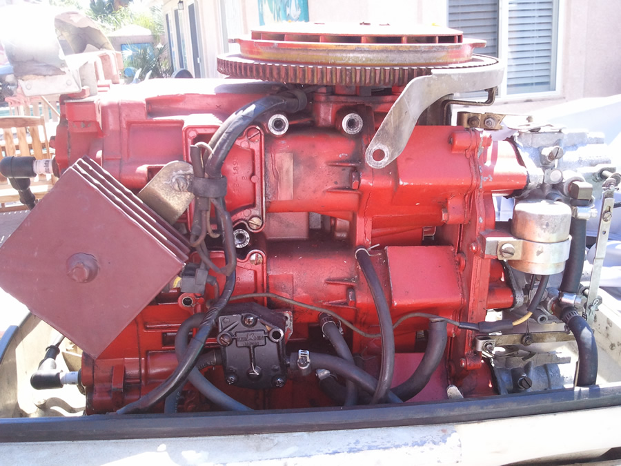

Do any of you have photos of the starter side of the 60-61 red-head assembled? Here's what I have right now:
1960 Dorsett Belmont w/ 60 HP Flying Scott aka \"Whisky Tango\" dorsettbelmont.blogspot.com/ Read my Jerky Blog at JerkyAficionado.com
Re:Original Flying Scott... should I even try? 12 years 11 months ago #77189
  • shacomm
  • shacomm's Avatar Topic Author
  • Senior Boarder
  • Senior Boarder
  • Posts: 161
  • Karma: 10

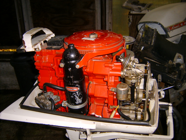

Here's a photo of my 58-59 donor motor. But the setup is all different because of the 3 coils.

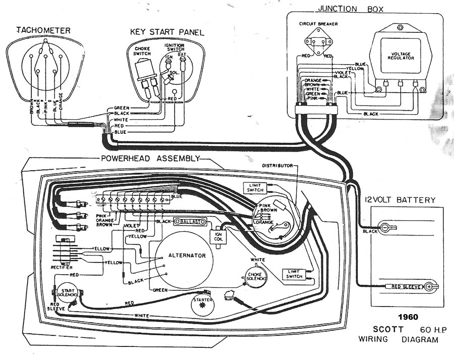

Here's the Flying Scott 60 Wiring Diagram 12 years 11 months ago #77334
  • shacomm
  • Senior Boarder
  • Senior Boarder
  • Posts: 161
  • Karma: 10
Located this in the service manual...
Re:Here's the Flying Scott 60 Wiring Diagram 12 years 11 months ago #77345
do you have the big box with the voltage regulator?
Re:Original Flying Scott... should I even try? 12 years 11 months ago #77400
  • shacomm
  • Senior Boarder
  • Senior Boarder
  • Posts: 161
  • Karma: 10
Sure do, its behind the back seat mounted to the transom.
I hooked everything up today. New starter, new battery, new starter solenoid, new battery cables. I have 12V at the starter and it spins great with the plugs out. Put in the plugs and It turns about a 1/2 a turn and stops. I checked the plug wire order and everything is in place the points look great.
When the plugs are in and you turn the key the voltage drops to 9.5v when the starter loads up. I've got my buddy coming over tomorrow and we are going to step through the systems.

Sorry if I've missed this, but have you tested or replaced the battery? It sounds like you have a bad cell.

The beast roared to life. OK more like a Breapp, Brearpp, Berapp... but it was spinning. The new battery required a full charge and I kept it on a charger over night but it turned over the motor. Then we dug through the fuel system and got it to fire. Once, my el-cheapo starter relay stuck and the starter just kept turning and turning and I had to disconnect the battery. We put the old made-in-the-usa starter relay back in and it was just fine. So much for the "insolvable" starter issue.
On to fuel, I decided to pull all three carbs and found one to have a messed up metering rod spring and pin. I pulled a carb off my donor motor but it is a different so I couldn't steal the parts. Here's what I need anybody know where I can get one? (It's a pretty simple part so I will make one if needed.)
The motor has an aftermarket fuel pump on it so I pulled then one from the donor motor and I'm going to go through it and might put that one on. Looking forward to burning some fuel soon!

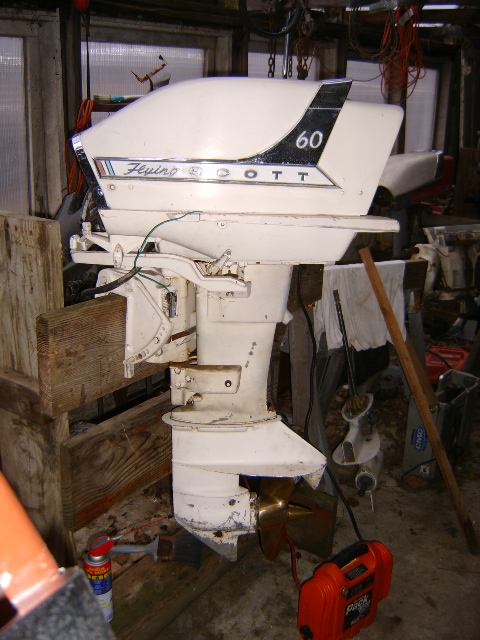

Re:Original Flying Scott... should I even try? 12 years 8 months ago #80903
I am working on getting a '59 Flying Scott 60hp up and running and this thread and your blog have been very helpful! keep it up, the boat looks great!!
Even with your list of interchange part numbers from your blog, I still have not been able to locate a starter. I am posting a WTB on aomci now.

Dan... Welcome! I don't have an extra starter (that works) but I believe Ponyboy does. PM him, he's a great guy.
I do have a '59 parts motor (that I took the starter and fuel pump off). I'm holding on to it in case I need any lower parts. If you need anything else let me know.
Re:Original Flying Scott... should I even try? 12 years 8 months ago #80916
I can fix starters, so if I can find one I may be interested in your non working one. I am working with The Scott Guy on getting a starter but it may not include the nose piece. do you have that?
