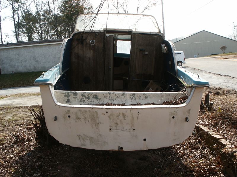

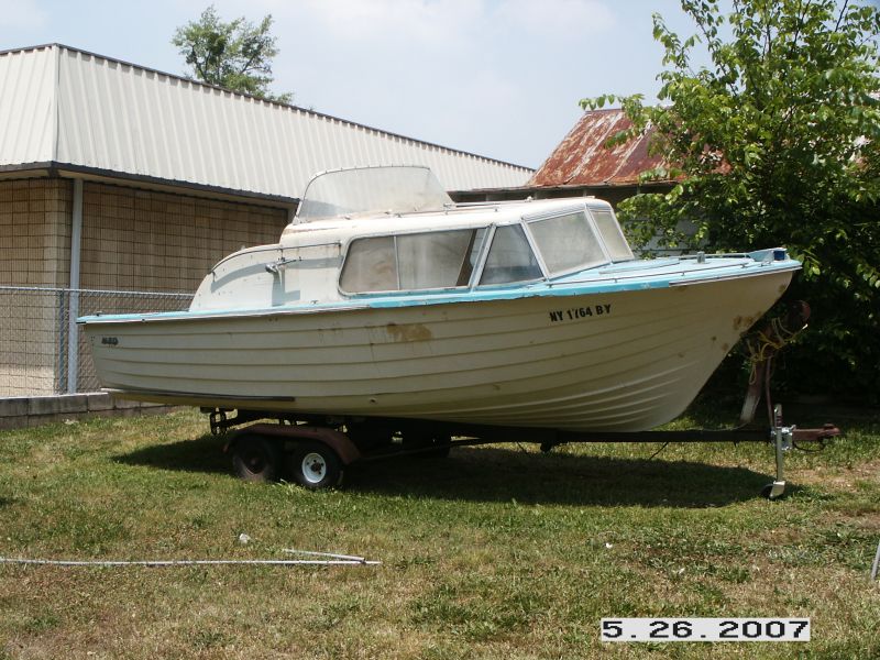

ok guys and gals im back after a long drought spell just too busy i am measuring for my transom pour and i can't make my mind up which product to use there are a few dealers here in Georgia i might be able to get the material from without having it shipped from Florida .. that might make the difference in what i use.... so any suggestions will be appreciated.....
here are a few pictures to refresh your minds on what i am working on.

I cannot completely disagree with MyFlamingo, but there are more considerations. The size of the boat. That thing looks pretty big, and separating the deck from the hull looks difficult and time consuming, as MyFlamingo mentioned. Another consideration I just thought of is a curved transom. I can't see if that applies to this boat though. In the end you have to make a decision no matter what and get it done.

It looks like your boat would be tough to take the deck off (can you get access to the transom without doing that?). If it had a curved transom as you described, I would definitely consider the pourable. Every boat and situation is different and you need to figure what is best for you. Nice boat, BTW.

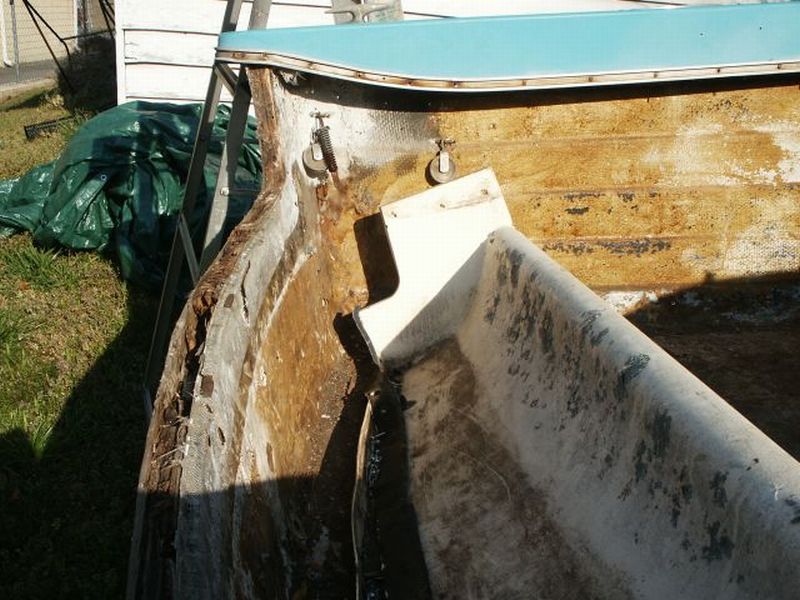

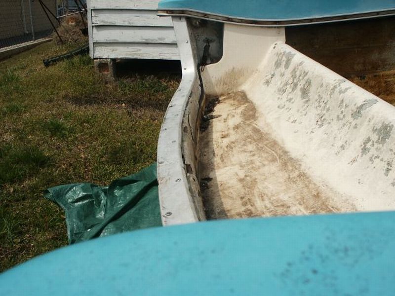

It is not necessary to remove the topcap of the boat in all cases. In the case of this boat the gunwales can be cut just in front of the splashwel and just the rear section of the cap can be removed. The glass repair to the gunwales is a very simple repair and is completly unnoticeable once done at the finish. It looks like this...
On extremely RARE occasions you can even cut the transom out from the stern and replace the wood and repair the glass from the back. Usually NOT recommended but can be successfully done. The above is done quite frequently with great success. If the top cap is large and cumbersome, I usually recommend cutting the gunwales and using this described methodology. Again, just my 2¢ worth.

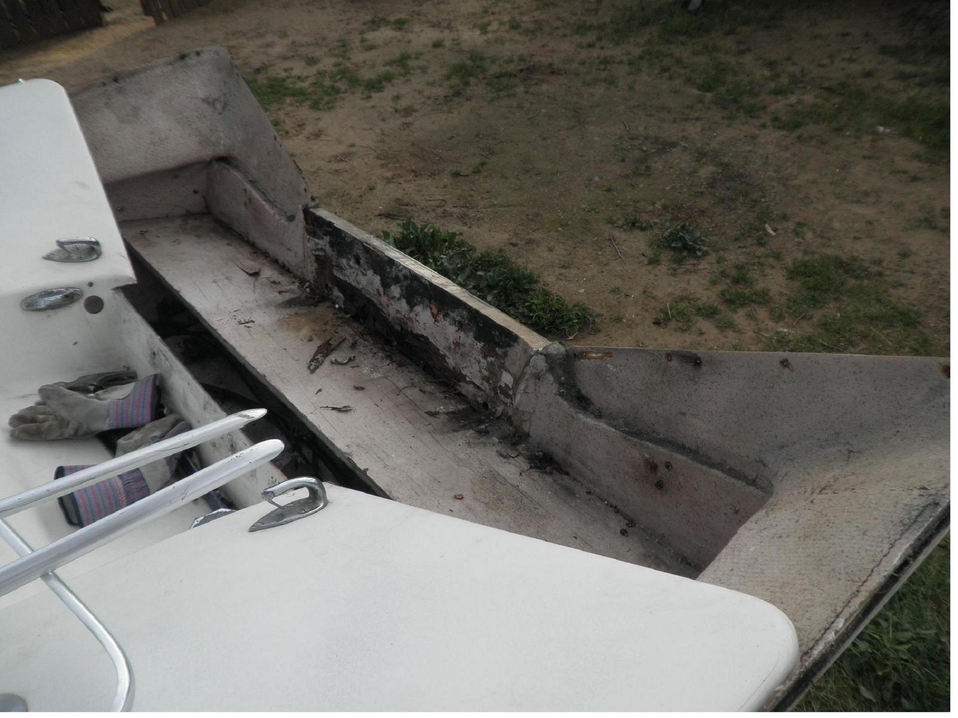

i appreciate the suggestions .. the main reason for my inquiry is the transom is curved i have gotten it close to true, the boat is 21 feet long i am doing all this in my back yard and under a canopy ... and i have to formed for the pour. from the floor up. i also have a good inner and outer skin that rotted from the bottom up . i did not know the two products were the same. good to know. i am sending a few pictures for the experts to look over and hopefully give me a good grade under the circumstances .
Re:seacast or nida bond ????? oh woah is me 13 years 5 months ago #68388
Nice Job! You can laminate a new wooden transom using 1/4" or 3/8" ext. grade plywood epoxied and clamped to the transom in individual separate laminations to keep the curve. Fairly easy to do and it will be strong as the dickens and will last for decades. You could use Polyester resin too, but I'd recommend epoxy in this case. Gives you more working time and much more forgiving.
