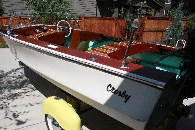

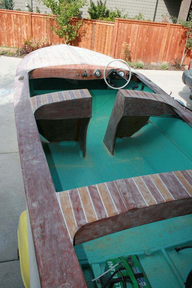

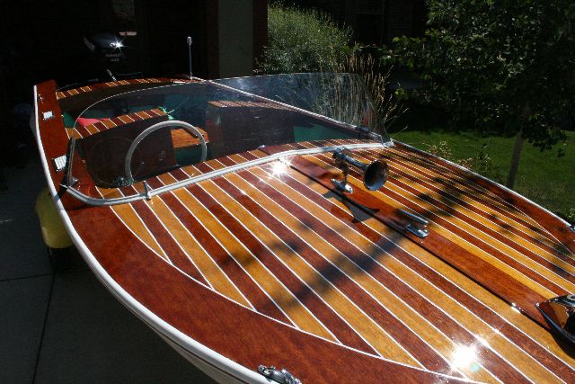

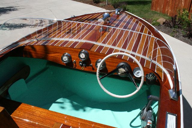

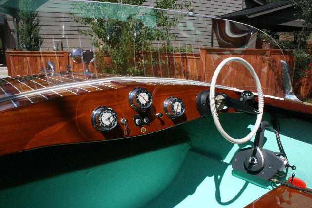

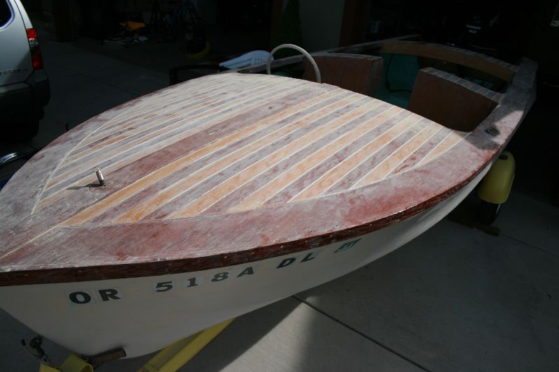

Not sure if this should be in Member Projects or not, but I'll post here. I finally finished the varnishing job on my 1957 Crosby Capri that I started last fall. While I was at it, I added new window moulding, rubrail and step pads. I was able to re-use the original red insert for the rubrail. I also added two vintage Airguide gauges (clock and barometer) to compliment the original speedo. I color matched the original interior seafoam paint. I didn't paint the steering wheel because the patina on it was made by my dad and grandpa. Couldn't bear to touch it. I would really like to thank everybody who chipped in to help me out with advice and parts (Cal, your Buegler pinstripe kit will be on the way soon!. I really had no idea what I was doing as I have never done any kind of boat restoration before, but with all your help, I got 8 coats of Captain's/and Epiphanes varnish on it, fixed two pretty big sections of wet rot under the rub rail, and painted new stripes on it. Here are some pics of mid sanding and some final shots.

Brian, she's absolutely gorgeous!!!!!!!! How did you like using the Epiphanes? Did you end up rolling and tipping or brushing?

Bob, I have to say I really liked the Epiphanes over the Captain's. It layed out nicer, looked glossier when it dried, and didn't produce near as much strong fumes in my garage when I was varnishing. The Captain's was really strong. Just my opinion, as I'm certainly no expert. As far as application, I used Wooster foam brushes for all of it.
