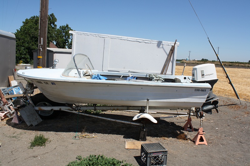

It's a fiberglass Starcraft. Kind of a bastard child, I'm getting the feeling. But here it is:

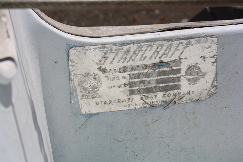

And here is what is left of the boat plate. In real life resolution the model is "14' COB" then something was clamped on top of it. Can anyone tell me what I have?
I'd really like to turn this into a pretty fish and beer chaser in the delta and mountains around Sacramento here. Any help in identifying this boat would be appreciated.

Well the first thing you did was post here, and that was a smart thing to do.
Welcome!
Hopefully a few will chime in on what yours really is, because I don't know.
The engine though is perfect. I am a big fan of the OMC three cylinders.
Go over it with a fine toothed comb, and have some fun.

Looking at the '64 catalog in the library, it appears that I have a Cobra. It's the top one on the cover , and the name appears in the caption on the top of page 5. 'Cobra' fits with the 'COB' text in the model number on the boat plate. (It's probably not called that, but I don't know what it's really called).

If you MUST proceed - you need to know that California has one of the most robust and active groups of classic boat owners on the planet. Go to goldenstateglassics.com/ and have a look around. I personally know a dozen or more old boat junkies right in the Sacramento City limits. They are a great bunch of people. The engine on your boat looks like a Johnson 55 or 60. It also looks like a short shaft - those are hard to find.

That motor looks to be a 1969 Johnson 3 cly 55 hp Electro Shift.

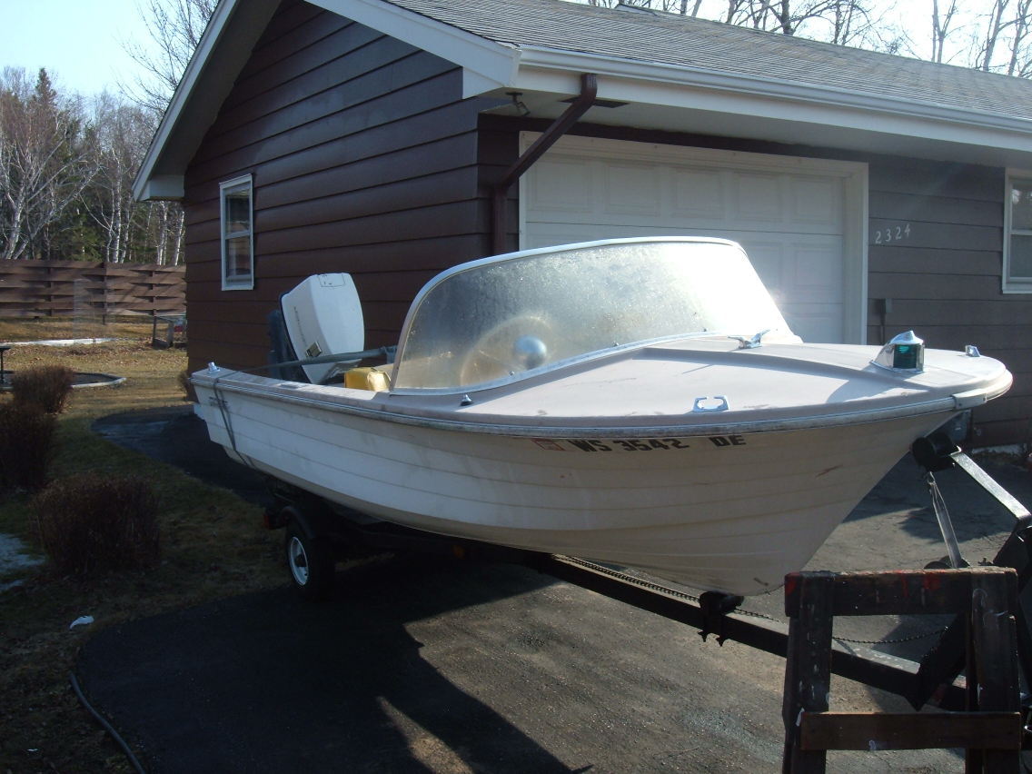

Be sure to use only Type C lower unit fluid or you will burn up the clutches inside. I have a 1963 Starcraft Ranger 14' with the same motor. Here is a link to my thread. You will find a lot of help there for your project.
www.fiberglassics.com/glassic-forums/29-member-projects/59941-1963-starcraft-14-ranger-project.html
You are going to love this boat. They attract a lot of attention when you take them to the lake, so be ready to answer questions about it.

Boy, you guys know your boat engines. I'm not sure how you could tell from the photo I provided but you're dead on. It is indeed a 3 cyl '69 Johnson 55 with electric shift. The model number is 55es-69a. Does that make it a short shaft? Anyway, it looks like a PO did some work on the battery cables and the fuel lines. The fuel pump looks new as well. The rest of the wiring is going to need some work. See the pic -

P.S. That is a short shaft (hard to find)
