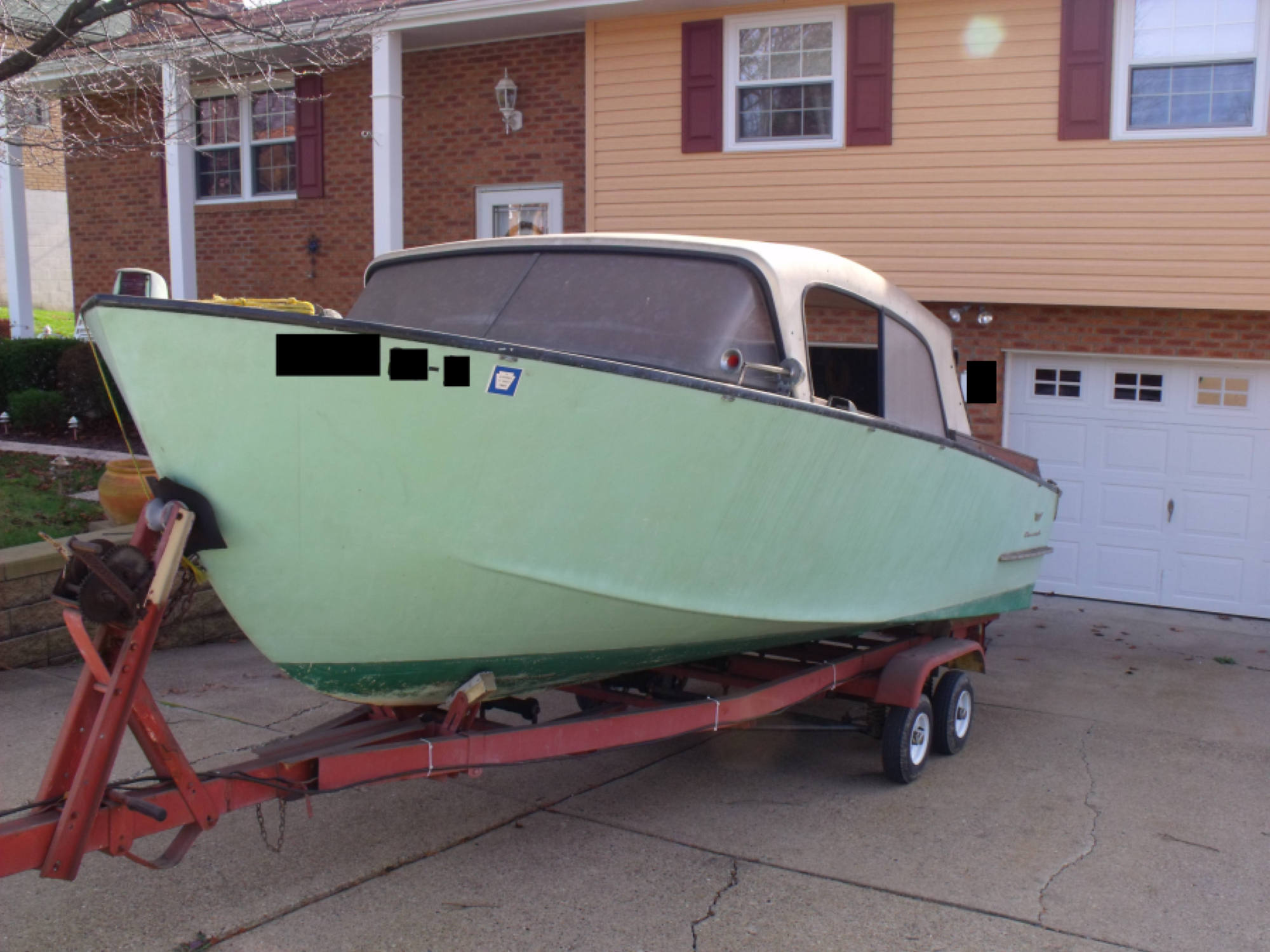

Well today was the day here in Pittsburgh, PA. It was a beautiful sunny 85 degree day with a slight breeze and moderate humidity (87%). My buddy Frostie and I got busy on the Botved Coronet.
This boat sat in the corner of a building for almost 27 years waiting for someone to come along and take her home (me). We brought her home last fall waiting for the day when we could finally get her going or at least try to. Today was that day.
Opened up the boat, removed the engine cover and had a look see.
Drained the oil and replaced it with new.
Cleaned the spark arrestor.
Pulled the fuel line and drained the tank. It had about 8 gallons of 27 year old gas in it and it took about two hours to drain it all. The fuel line is probably 8mm. spliced a piece into it and ran it out the spring loaded drain plug hole into a 5 gallon safety can/ Man it seemed like it took forever.
Pulled the glass bowl off of the fuel pump, cleaned the screen and scrubbed the base to remove a lot of old sediment.
Reattached the fuel line but first we put a modern see through fuel filter in the line itself below the floorboards to supplement the old glass bowl style filter on the top of the fuel pump. Put about 3 gallons of fresh fuel in the tank.
Attached a garden hose to the water pump intake (the headphones would not work since the water pickup was located at the bottom of the boat).
Turned the water on and we had a lead in the starboard side of the engine. Seems that wen it was last winterized 27 year ago the petcock had been removed and not replaced. Frostie was able to find a brass bolt that was short enough and had the right threads to suffice. Once installed no problemo.
Installed the battery.
Frostie went up front and turned the key on and engaged the starter. A few coughs and pops and the old girl fired right up. A little rough for the first 20 seconds and then she she settled into about an 1100 RPM idle without the choke being engaged.
Oil pressure went right to 60PSI and settled in at about 52PSI once the oil warmed up and thinned out a bit.
Temperature came up real nice too well within the safe range and a bit on the low side to boot.
Frostie adjusted the screws on the carb and the idle settled in at about 600-700 RPM with no choke involved.
The little 1600 CC Volvo motor just ran as smooth as glass.
We ran her for about 20 minutes and shut her down.
Hooked her up the the Silverado and headed about 3 miles down the road the the Ohio River.
Got to the launch and sat her behind in the water. Solid as a rock, no water in the boat and we all know that is a very good thing.
I parked the truck while Frostie warmed her up a bit. The plan was for him to take her out while i stayed on the dock and took some video of her on the water. I did that and I will be posting video once I convert it from analog to digital format. I have video of Frostie moving along at about 35 MPH with the Botved planing along nicely.
There were a lot of people in the parking lot and on the launch area and they all were making comments about how cool she was and they wanted to know what year she was and what make. Lots of compliments on her even though she needs a good cleaning, paint and the plexiglass windshield and side windows replaced.
Frostie came to the dock and I got on board and I got my chance to drive her. She was fantastic. Having been awakened from a 27 year nap she performed like a champ.
All in all though a very good day and a lot of fun for me, Frostie and for her. Just awesome!!!

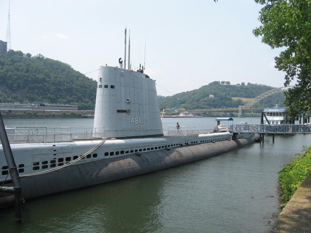

Shucks just was down there a few weeks ago for the Carnegie Science Center and the Requin. I posted pics in the awesome boats pics at the top. I'm sure you been there.
Re: Botved Coronet Hits The Water 13 years 6 months ago #65239
Been there done that with my kids a few years ago. I can ride my bike down there on the trail. I live one block off the Allegheny river. It kind of spooked me out being inside and feeling that very light rocking motion and a bit of disorientation caused by it. Can't imagine going to sea in one of those boats, brave men one and all.
