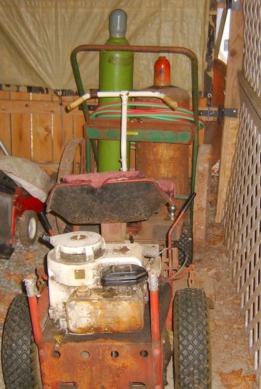

HA! Ya can't beat, a old "beater"! I bought a USED, Snapper "Comet"
rider in 1986. That sucker just won't QUIT! Goes through foot tall
grass no problem. Been through a few drive disc, and after the 26
YEARS, the blade drive belt finally snapped in two. $30, and ready for another 26 years! They don't make them like they used too! OK me, as new NOT needed!
And the "do what ya gotta do to make it run"? Before I went to Nam after HS in 69, had a 650 Triumph bike. Had a Magneto, so no need for anything to run the motor. Had the generator, batt, for the lights. Well, of course "Lucas, Prince of Darkness", electrics. Gen's would go bad, and long story short, one day I let all the smoke out the wires. Said the hell with it, ripped everything out, and just ran a straight lights, off the battery. Had about a 3 hour window, for riding at night, and get home. Lotta fun back then, a stupid kid! Pic my old Snapper. And those tanks in the rear? I have a big set in the shop, and a small tank portable too. But got this for $100 a G Sale. BIG Acet tank, has 190 LBS, and the OXY was M/T. $27 a fill. New hose came with it, and I have a extra set of gauges. Not a bad deal for $127! Sorry if the long story, but I simple like old stuff, that will, and still does "work"!

Also, forgot to mention, the Snapper..see the trailer ball I mounted on the front, right side? GREAT for moving some my trailers, and lighter boats around! (Never stop thinking!)
