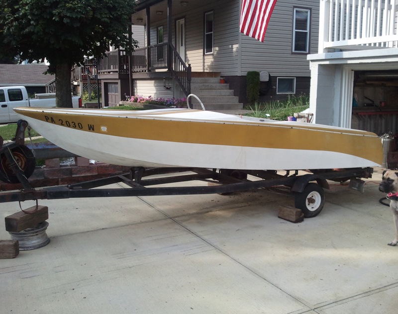

Heres a pic of it somewhat cleaned up after sitting outside

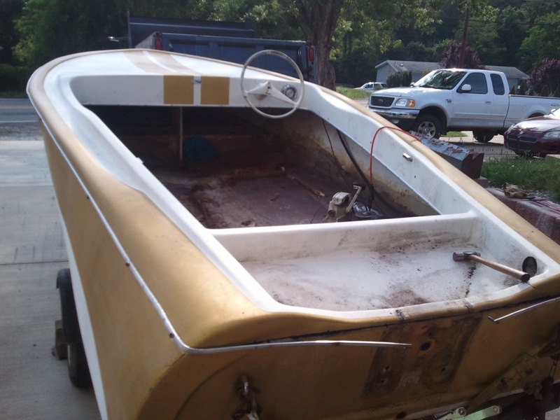

One of the inside ..notice the square cut out where I cut to check out how rotten the floor was...there are 6 bolts there that hold on the bottom fin on and let water in and got underneath and made the wood soft

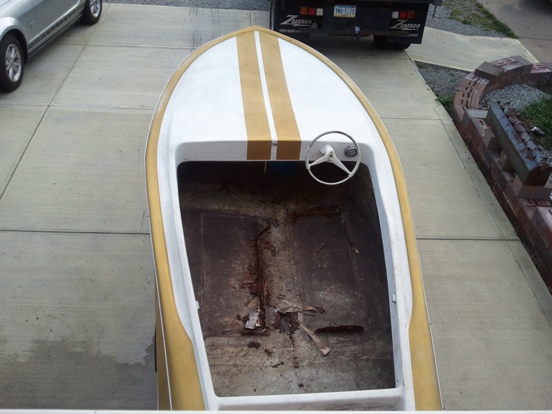

Heres another of the back and the worst of the repairs thats gonna need redone. New wood on the transom and floor and glass work, but hey its only hard the first time !!!

1.. What type of plywood should I use to rebuild this animal..is there actually marine grade or do i get regular and treat it?
2.. What type of adhesive should I use to adhere the plywood to the fiberglass... epoxy ? resin ? or ?
3... Is it ok to take the plywood off the floor and work on it while its on the trailer? or should it be supported better..I was thinking putting plywood on top of the rollers to support it from underneath.
4.. What is the bottom of the boat classified as since it starts as a V hull and flattens out about half way under to the back?
K I think thats it for now.. lol but I'll have more as Iget deeper into it..THANKS Jim

I used regular ply wood with an A side finish (smooth). All recent plywood comes with water proof glue. You will more than likely be re-glassing it to the hull so that should seal it up. But hang on the others are much better at this than I am.

1 & 2) yes there is a marine grade plywood, it runs about 100.00 bucks for 1/2" 4 x 8' in Canada not sure in the good old USofA. For a transom I'd use it as it has no knots or voids which trap air in when sealed therefore will be the starting point of rot. You can use regular good one side for a floor to save a few $$ but I still use the marine stuff. Coat the entire sheet with with a regular resin a couple of times before installing then a layer of glass over the top side with the glass extending 6" or so beyond the ply to hold the floor in place ( before covering in glass you'll have to fill the voids / feather in between the edge of the ply and the hull of the boat with a bondo or similar product cause glass won't go around corners. Anytime your putting new glass over old glass it's a good idea to use vynilester ( sp? ) resin it bonds much better. Sorry I forgot to mention you hold the floor in place with small blobs of bondo at various points on the underside and let dry before fill voids.
3) If the bottom of the boats flexing you'll need to support it by building a cradle, but if the hull is solid you should be OK as the floor shouldn't be the main source of strength maybe others will chime in here ??? If it's just a glass hull ( not cored ) I'd think you'll be fine without.
4) I would think that hull would be called a flatty, usually used for the big inboards like a Mandella.
