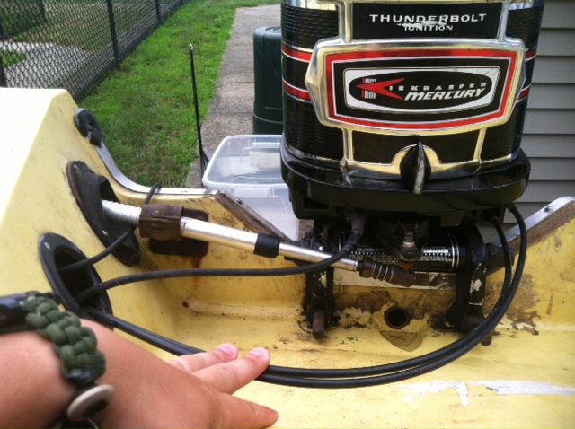

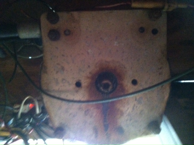

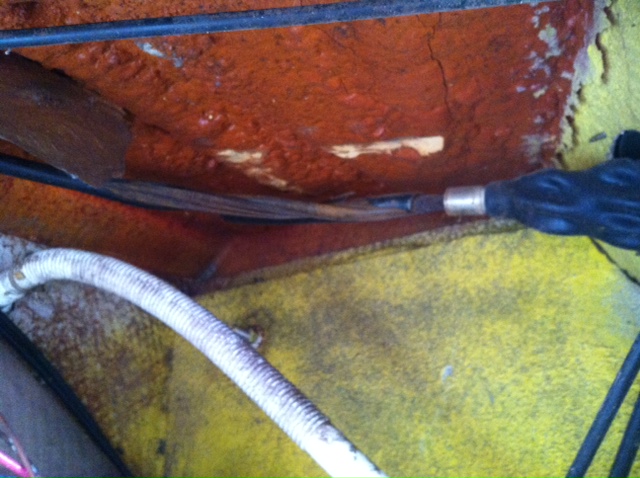

I do know that it is not a cable and pulley steering system. I couldnt find any type of of brand name, but it was raining so i didnt want to have the boat uncovered for too long. The first picture is of the telescoping rod that pushes and pulls the motor, the sencond is the steering cable that splintered, and the third is the steering housing that is up under the dashboard.

Docstark, welcome to the group. Looks like you are going to need a new cable. The casing is shot and the cable has rusted in the rear of the boat where it goes into the tube . It is a teleflex system. You need to diconnect it from the motor. The end with the balljoint on it should screw off of the cable then you can pull it back through the metal tube. You will have to diconnect it from the control box also. After you get it disconnected you will need to measure the entire length of the cable. If you go to the teleflex website they will show what to measure. then you can just order one off the web or a local boat shop. Off the web will most likely be cheaper. Do not go shorter than the cable you have.The secrect to a long life for these cables is to make sure that they are properly lubed . You cannot repair these cables once they are shot.Well good luck on this and keep us posted, Skip.

I'm still trying to figure out what kind of helm that is! (I know the pic is upside down shooting up under the dash, but I don't recognize it.) There may be a part number or at least a length stamped into the old cable on the metal sleeve on one end or the other, Doc. If not, there's some video on Jamestown Distributor's website that shows how to measure for a new one, how to install, etc.....

the picture isn't upside down. I was down on the floor looking up at it.
