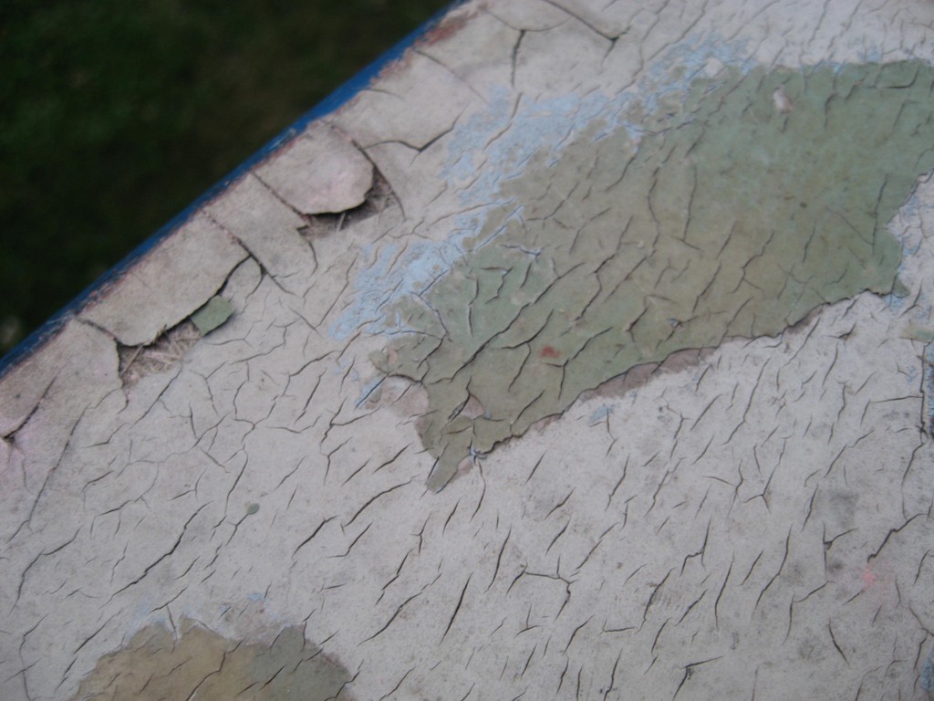

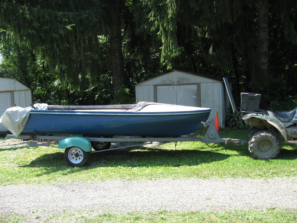

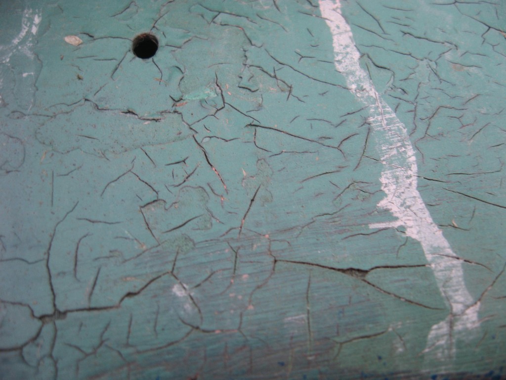

I plan to paint my boat instead of gel coat. i also plan to use a sealer instead of a primer but i have major cracking in the original gel coat and i was thinking about a body filler or bondo to fill all the cracks before i start sealing it. is body filler or bondo the right thing to ude or is there a better product that has more flexability. let me know what you think and thanks.

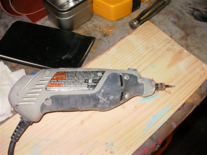

Re:PAINTING MY BOAT AND NEED SOME ADVISE 13 years 7 months ago #64478
pix

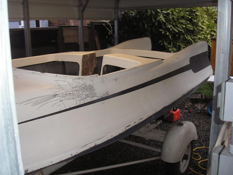

I'm doing my Winner right now where the top half is in horrible condition. It was cracked badly and someone painted it. I'm sanding the gel coat off now after someone else failed at the filling repairs. I don't know what all they used. The cracks were large and deep going into the fiberglass mat. Paint went through the cracks and into the fiberglass mat. I'll see about some pic today. I'm going to use some regular body putty and glazing putty and regular enamel. My boat does not sit in the water and is in just for fishing. I feel you will not get a good solid repair with the cracks. Getting your product to the bottom of the cracks is very hard. I tried a small section with resin. Didn't penetrate into all the cracks. I'm counting 4 layers of different color paint but one layer is red oxide primer. Then I'm sanding the gelcoat and at 54 years old it is HARD. I already done the bottom half.

I would reccomend a different filler other than automotive bondo. It's a pain but you can grind out the cracks with a dremel drill with a Carbide bit then fill - sand -fill till smooth.

Alot of the cracks can be sanded out, the ones that can't we used a dremol along the cracks and then filled with Cabosil before priming, 4 years later still looks good....

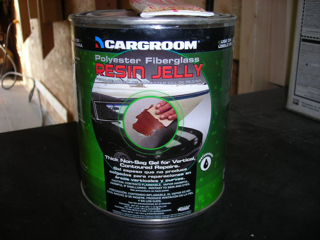

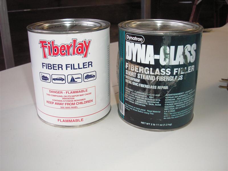

this a good product,its a fiberglass resin jelly,for filling spots,it is just like using bondo,only better for fiberglass,john

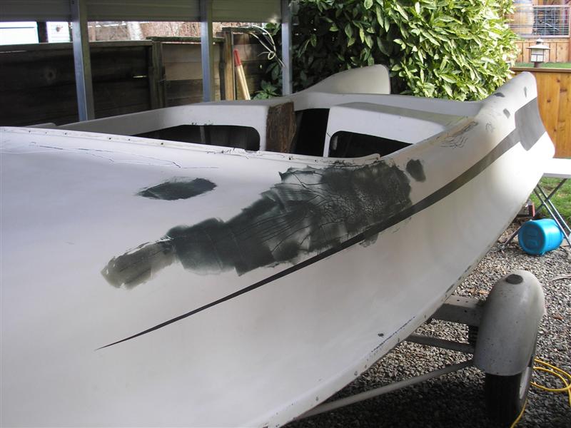

I sanded all the cracks out in my Power Cat, and then depending on how deep, used mat and resin, tiger hair, or lightweight body fill. On the deeper cracks it was a succession of all three, and for the most part, lightweight body fill was final before primer.
Here's a web site with just pics of what I did: www.powercatboat.com/Group/FA_14t/FA_14t01.html

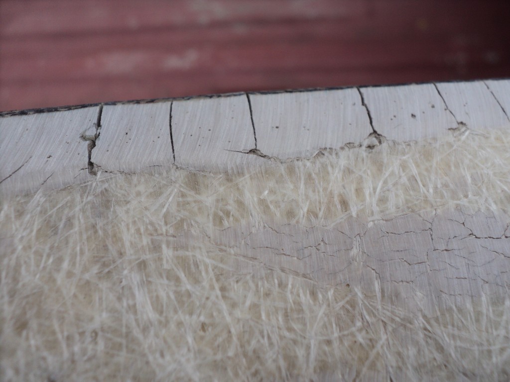

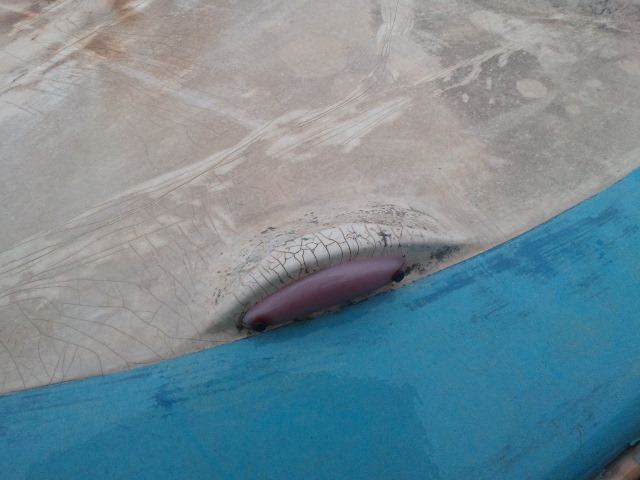

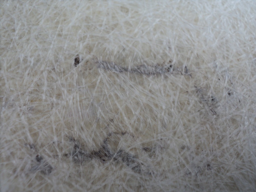

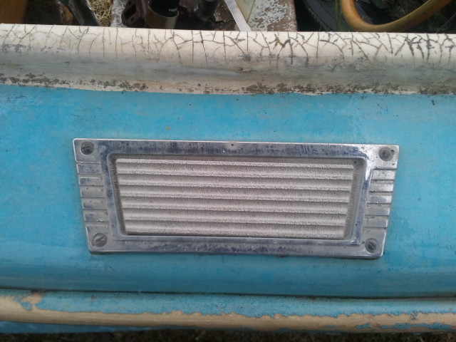

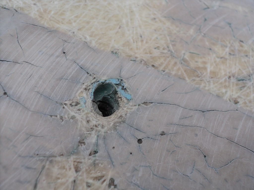

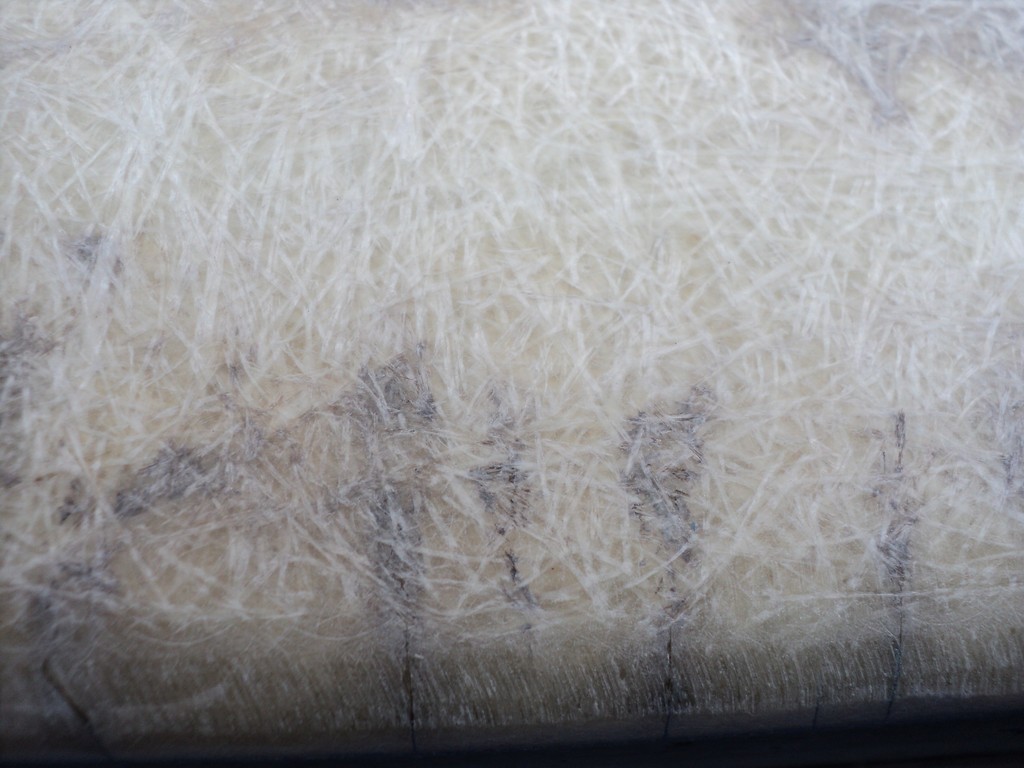

The top of my boat is almost all down to the fiberglass. No more cracks for me for sure. I'm exhausted. :S Here are a few pics of the paint that soaked the whole way into the fiberglass matt. A hole. Gelcoat while sanding. This is the edge so you can see how deeply cracked it was.

3 years ago I used a roller & epoxy and I coated a badly cracked glass boat (just as the pics shown here are ) with 2 coats of epoxy, sanded that to level out the cracks then I filled a few of the larger scrapes and cracks before primer & paint, this boat has taken a beating and the cracks have not re appeared

I have Rustoleum on the bottom. The top was originality white. Then it was painted yellow, then a lot of red oxide primer, then light blue, then dark blue. It appears the cracks may have gotten worst each time. That is a lot of paint over damaged gel coat. That is the biggest reason for stripping it to fiberglass. It has had way to many failed attempts at repair. What a mess it was.
