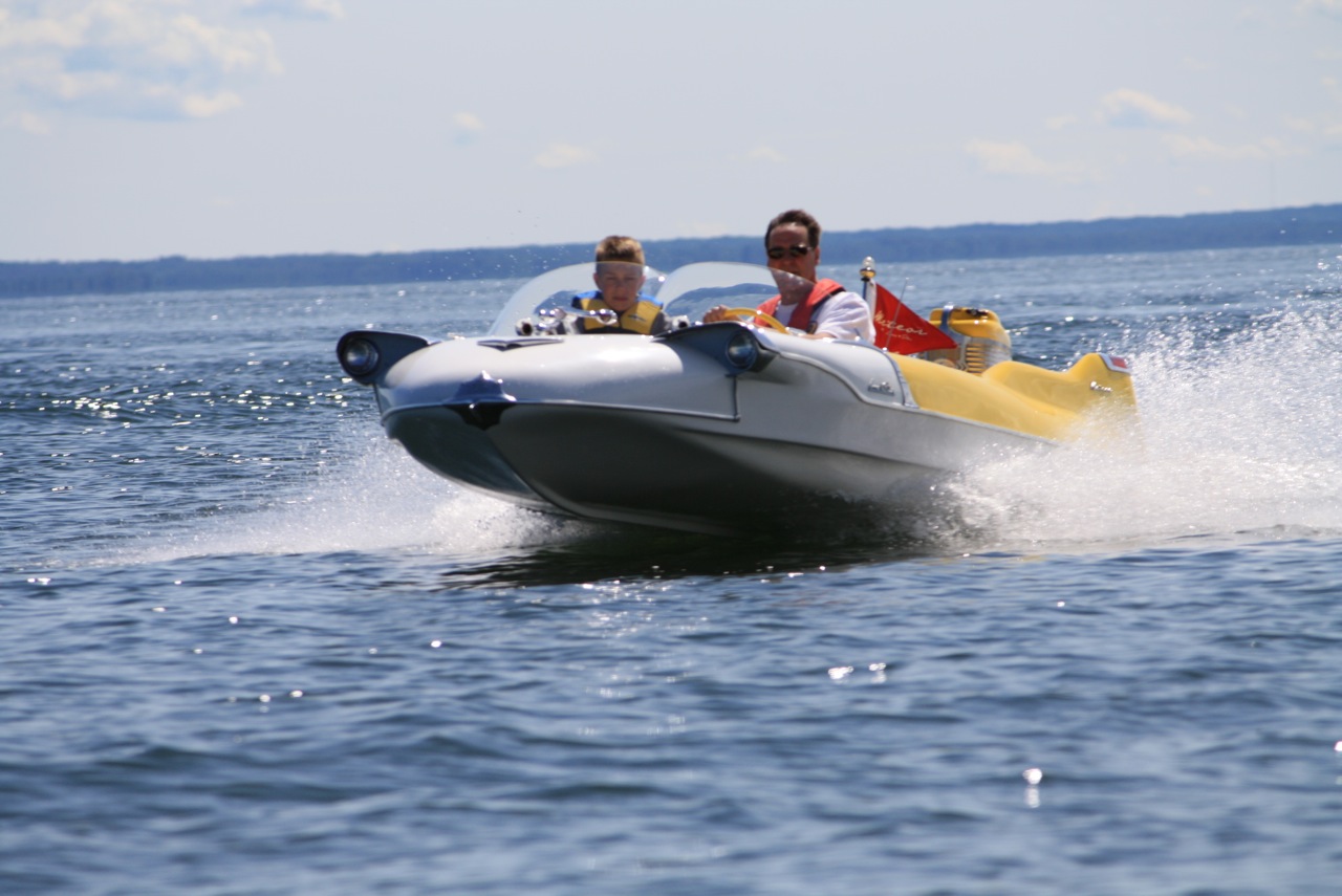

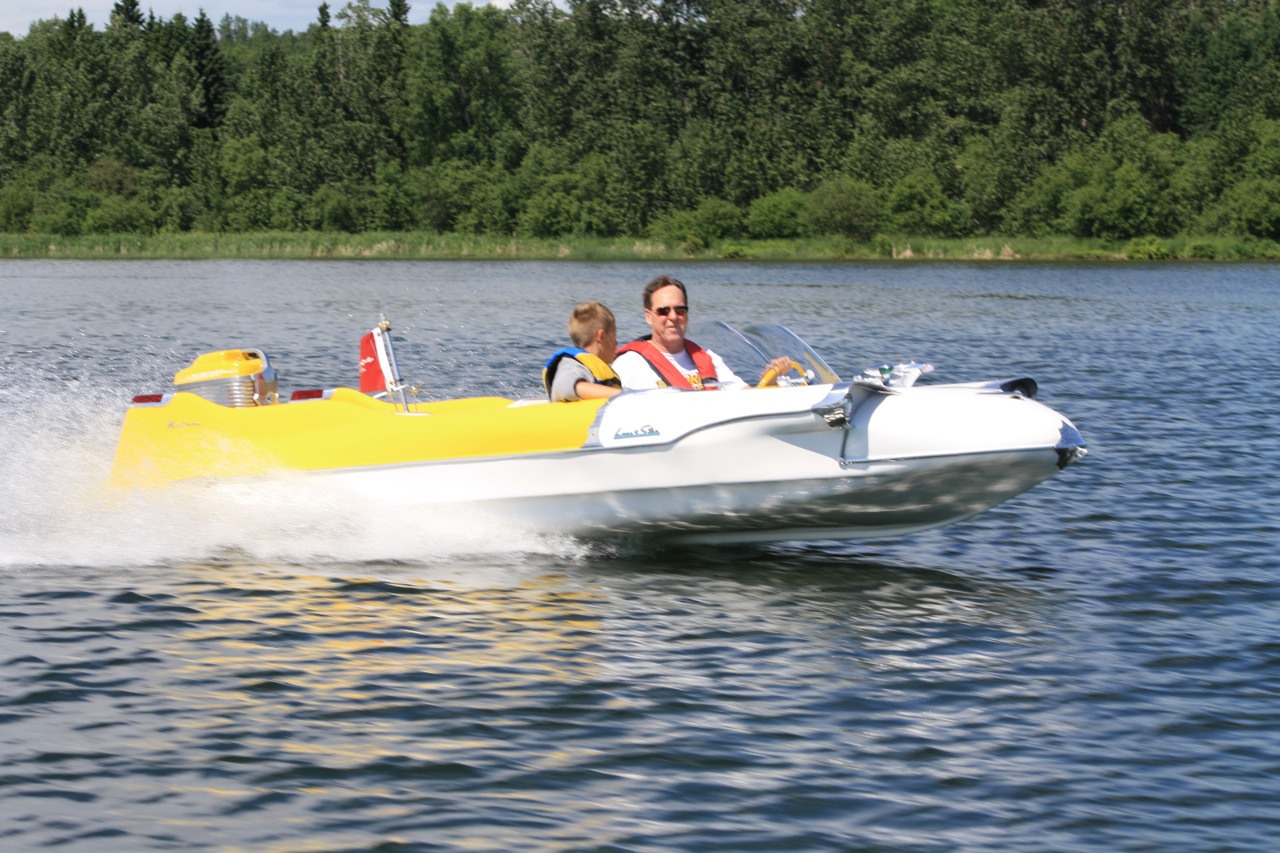

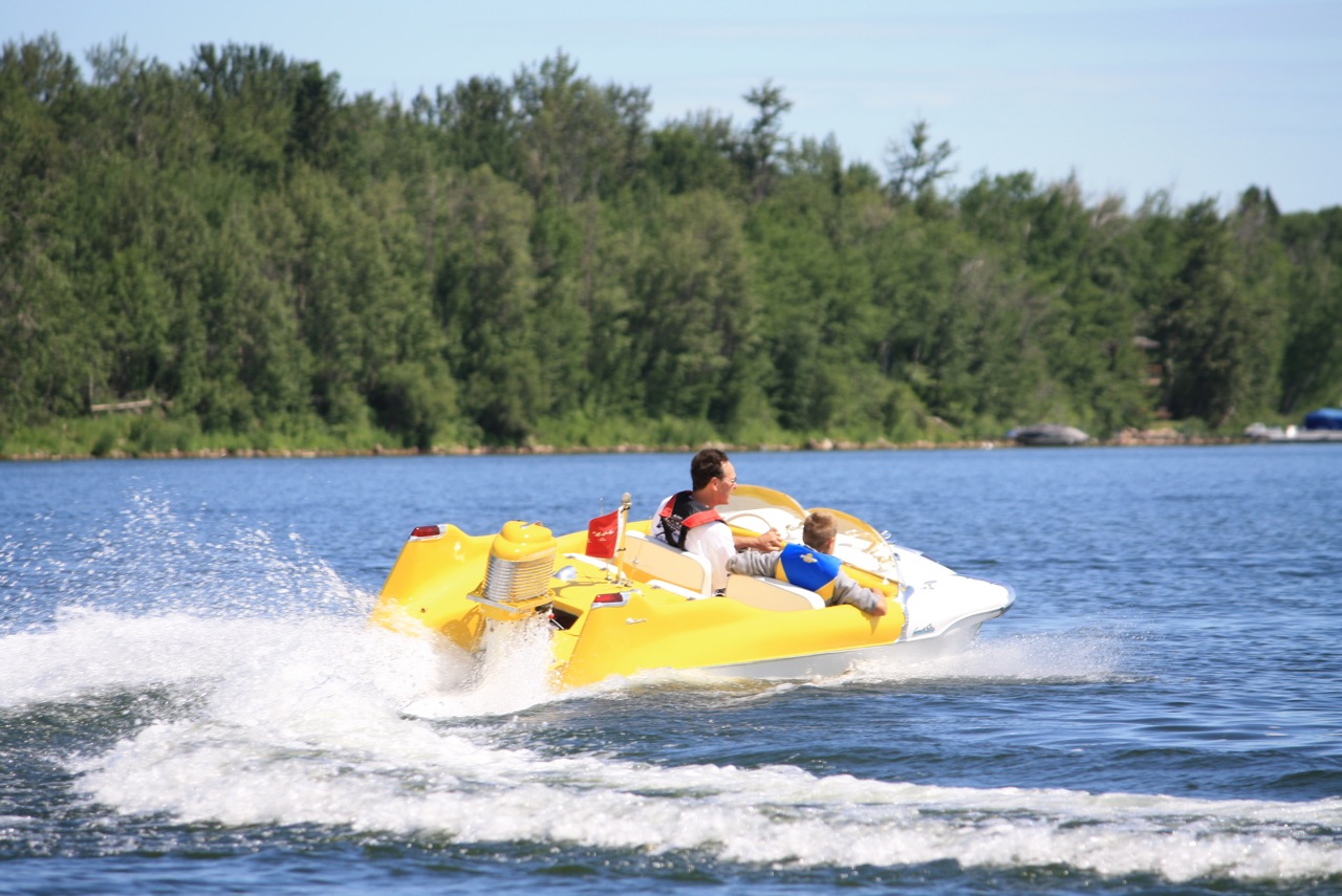

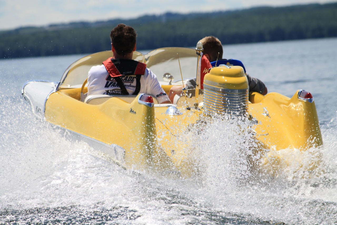

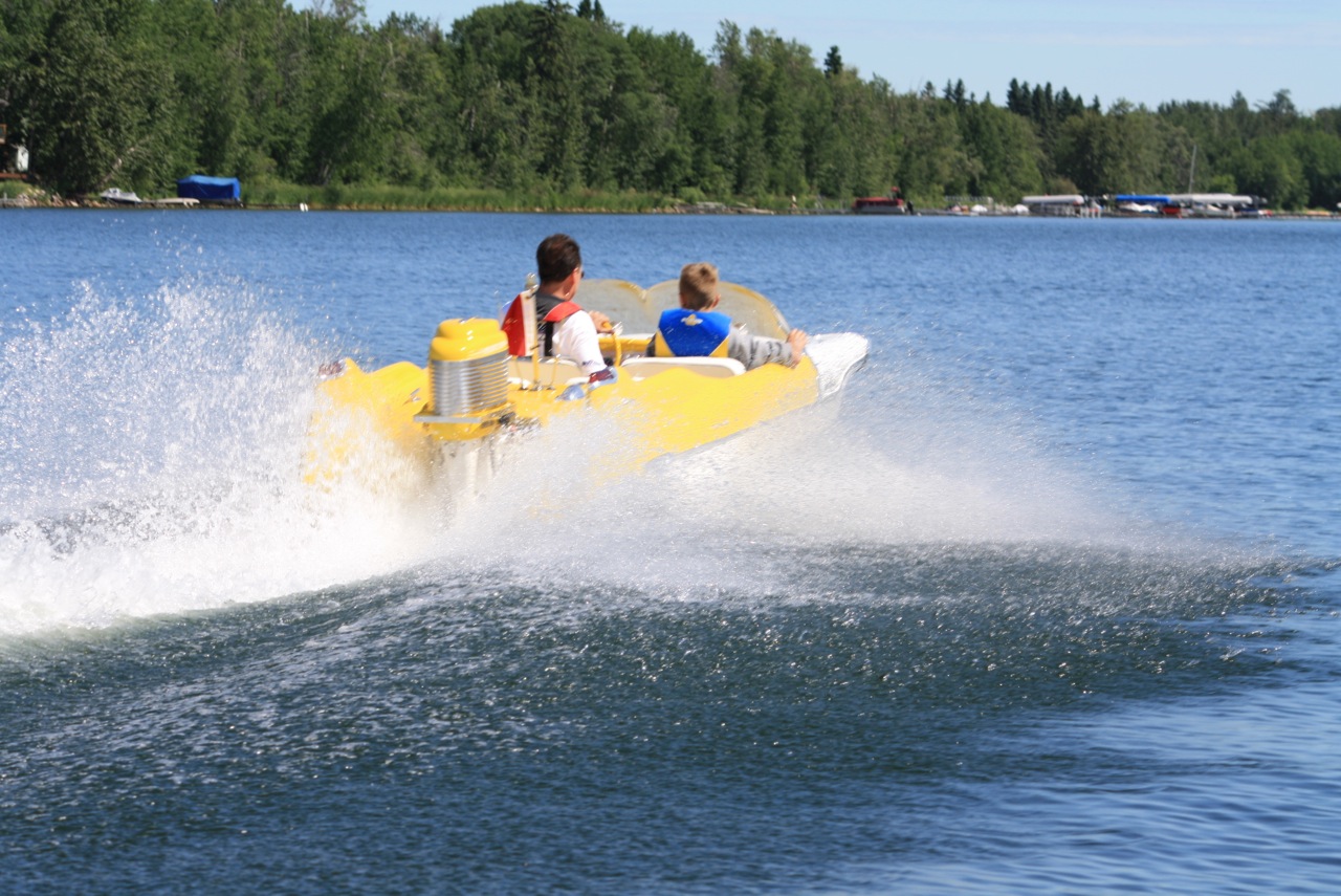

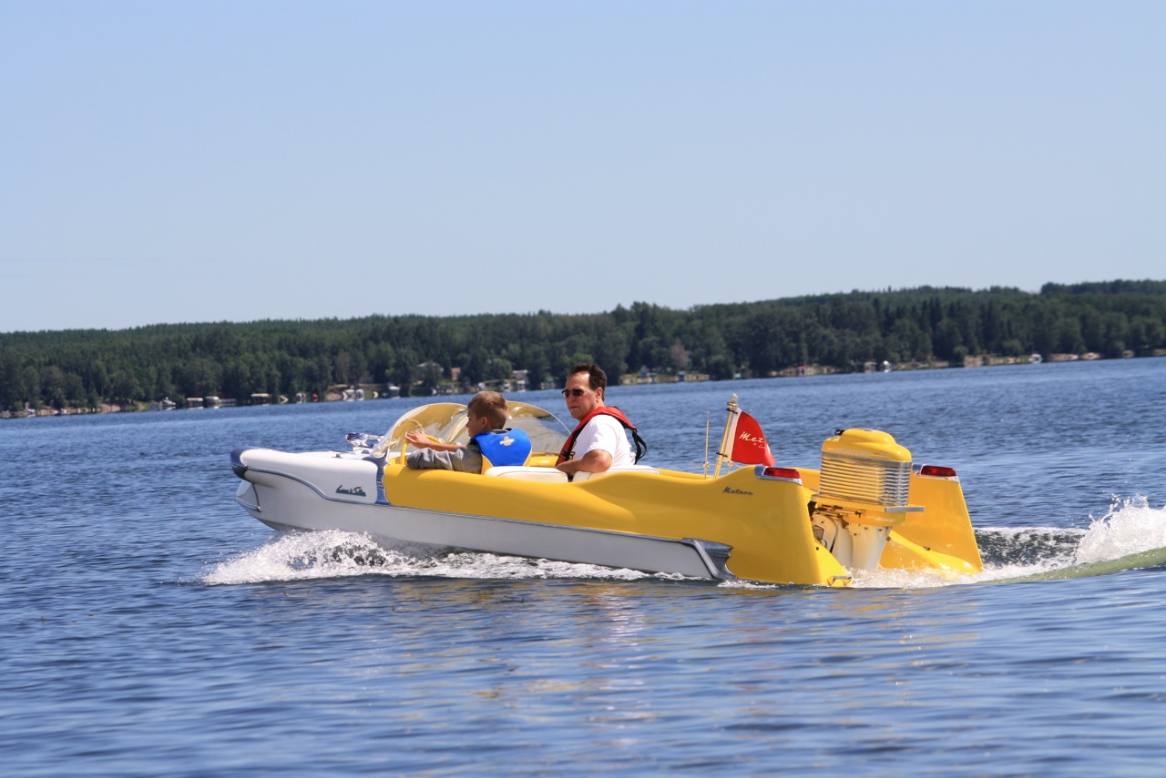

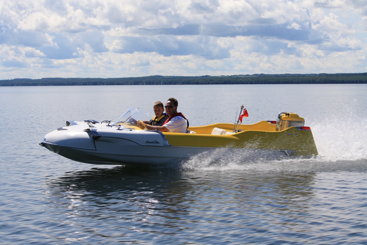

Hello, Mitch (13) and I put our father/son winter restoration project in the water for the first time last week. After a few tweeks it worked beautifully as we put many tanks of fuel through it over 9 days. Our 45hp Mercury Mark 58 with an 11 pitch prop pushed it through the water at just under 30mph. The Meteor even with 4 people in it worked well with no bad habits or problems. The rear pontoons lifted the rear of the boat to safety from rear approaching waves even on fast stops not allowing water even close to the transom. We had a ton of fun using this boat and meeting people out on the lake wondering what the heck it is !! The Meteor when used with common sense (no white cap waves) is a pleasant family boat with no bad habits.We look forward to using it allot over the summer...Brad Lake

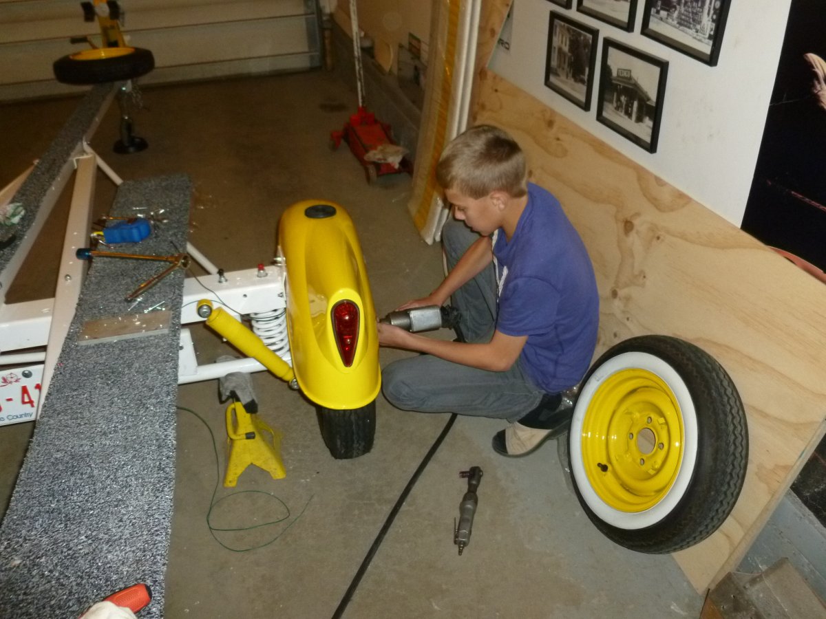

Wow Brad, beautiful boat! Do you have any photos of it before and during the restoration?

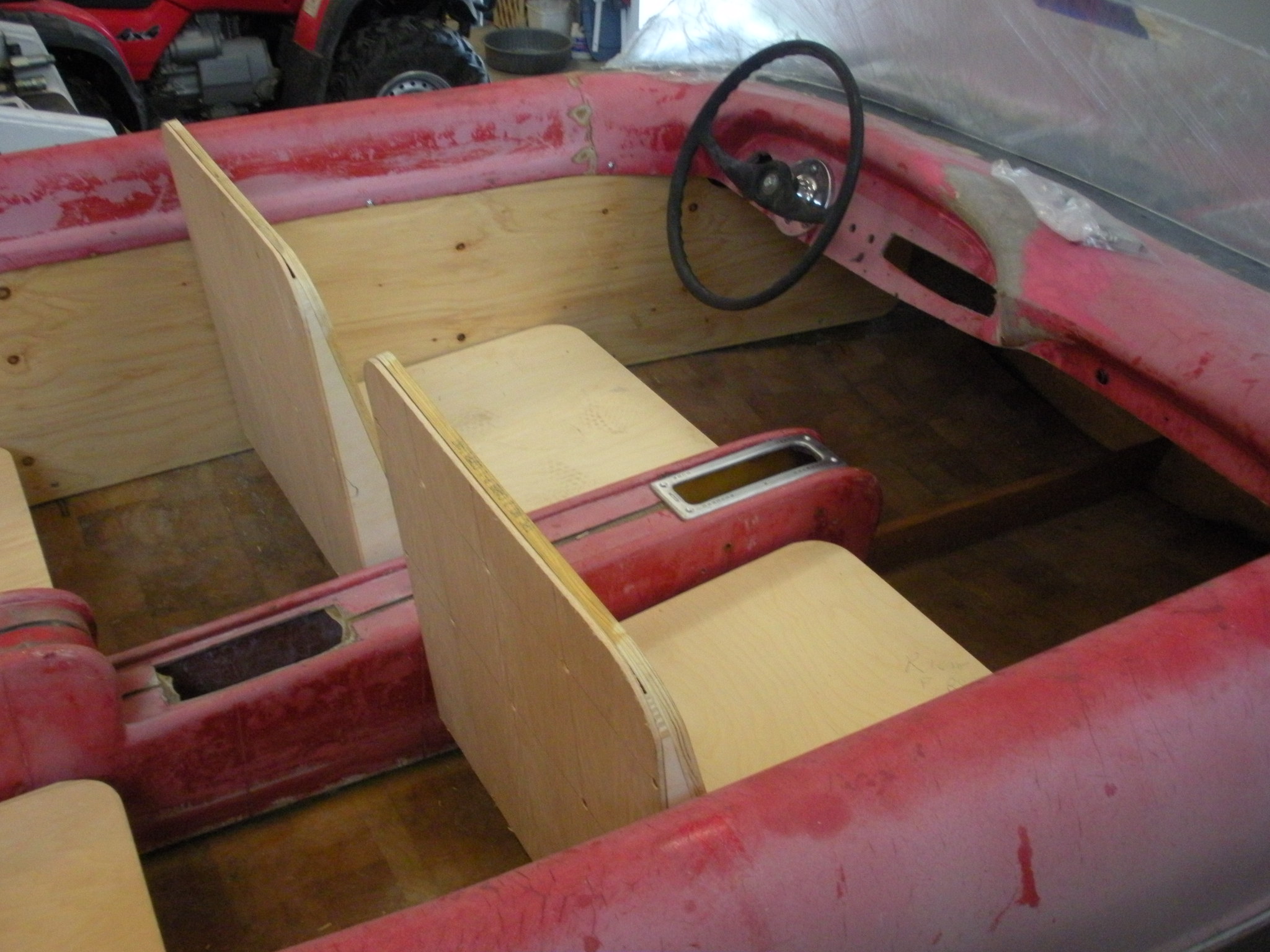

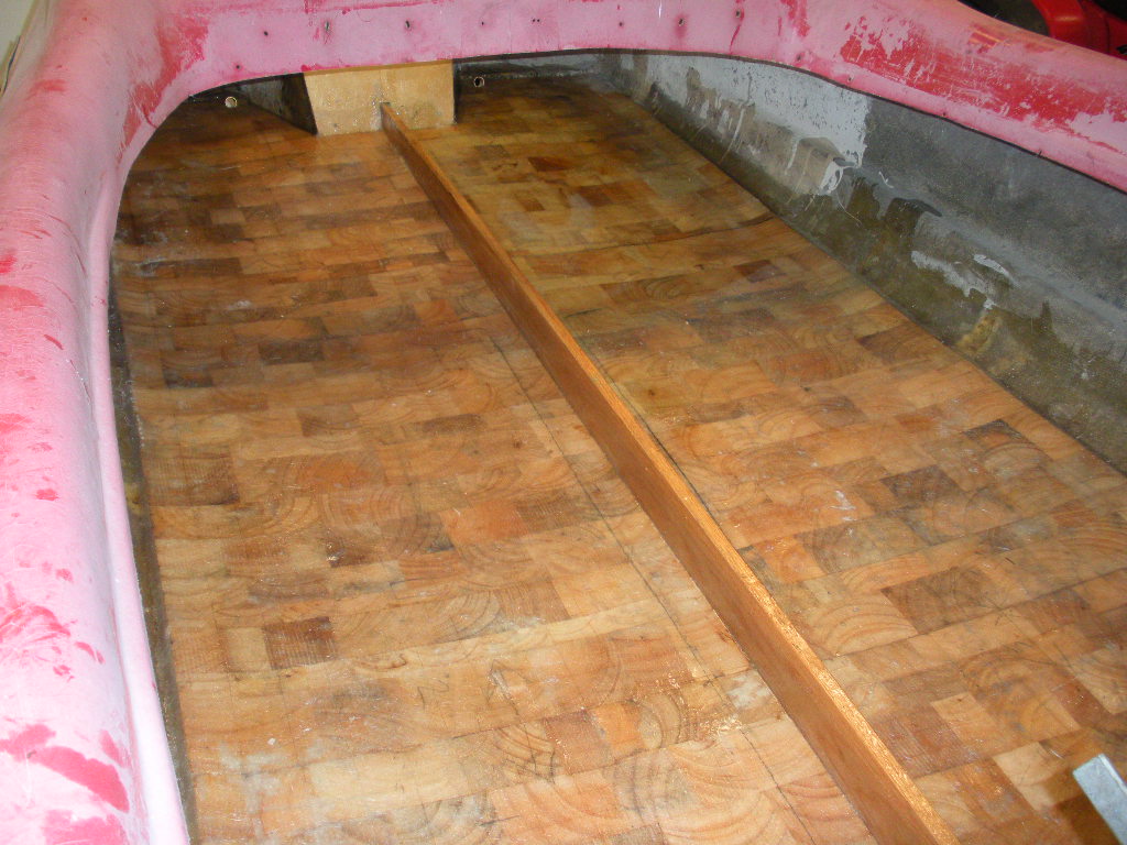

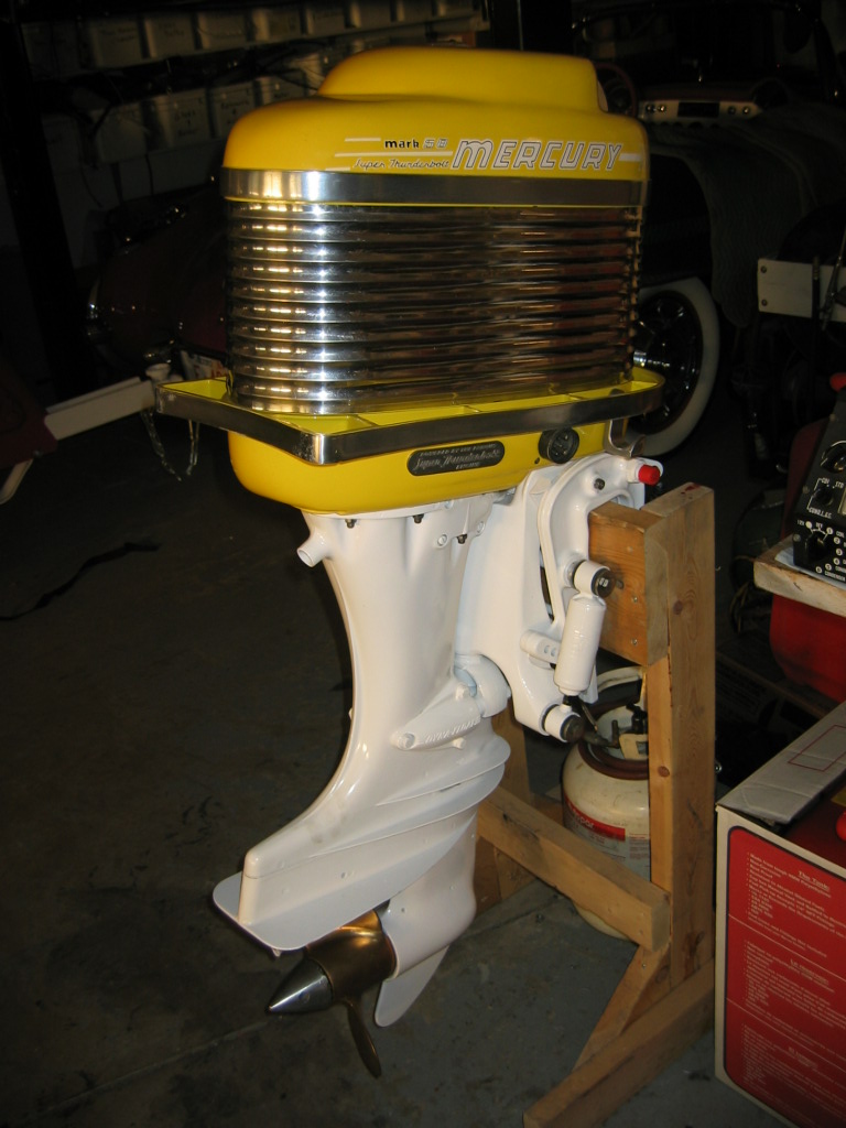

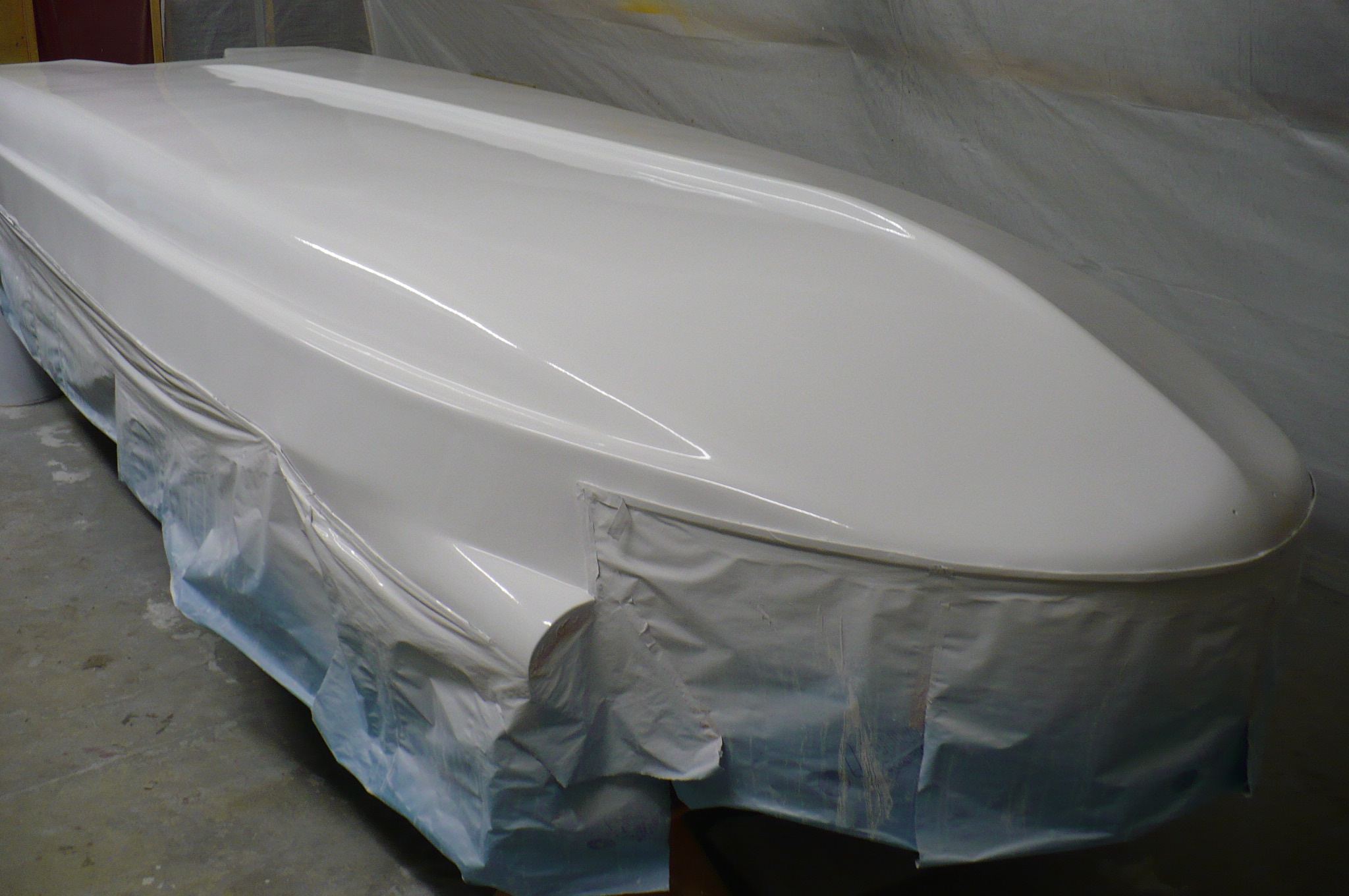

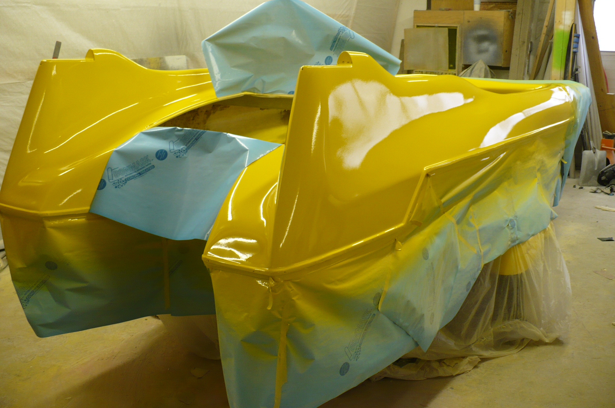

Hello the restoration took us about a year. The boat was completly striped down , we built a new interior and re did the gel coat. We improved on the ergonomics by moving the front seats back 6". We installed a balsa core floor with a 6" center beam front to back . The motor was completly stripped down , we re built the power head and the leg. Mitch wired the entire boat himself, and hooked up the air horns. Brad

That Balsa wood floor you have. Did you seal that up with resin? How well does it conform to the contours? I like the looks of it.

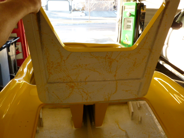

Hello, the balsa comes in 2' x 4' sheets of small 2" x3" blocks that has webbing on one side holding them together. They are very flexible and conform to the curves of the boats floor easily. I first sandblasted the floor for adhesion, then belt sanded it flat as possible. I next rolled a heavy coat of resin on the back side of the balsa and it's area of the floor,installed the balsa sheet and weighted it down with about 20 sand bags made from freezer bags filled with sand. Once the entire floor is installed in this mannor 2 layers of heavy mat was resined over the whole balsa floor to the center spar making a super strong but thin floor. ..Brad

Hello, we now have a number of weeks using the Meteor. The more we use it the more we like it's handling and ease of use. As a family we have put many tanks of fuel through this boat with nothing but good experiences. This boat has great manners when used on calm water, as i previously said it is not a boat to be used on white caps. I would highly recommend any collector to use their Meteors in the water as they work very well and that is what they were built for !! Happy Boating !!!!!Brad Lake
