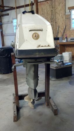

What's your thoughts? ON 35 HP Lark 13 years 7 months ago #63917
Any thoughts? Unknown condition he wants $150.00. I'm going to look at it this morning.

Re:What's your thoughts? ON 35 HP Lark 13 years 7 months ago #63927
robert,thats a 1959 golden jubilee,i saw just the ignition plate with the gold meddalion, go for 200 bucks on ebay that might not be typical,but the badges and cowling are worth something.

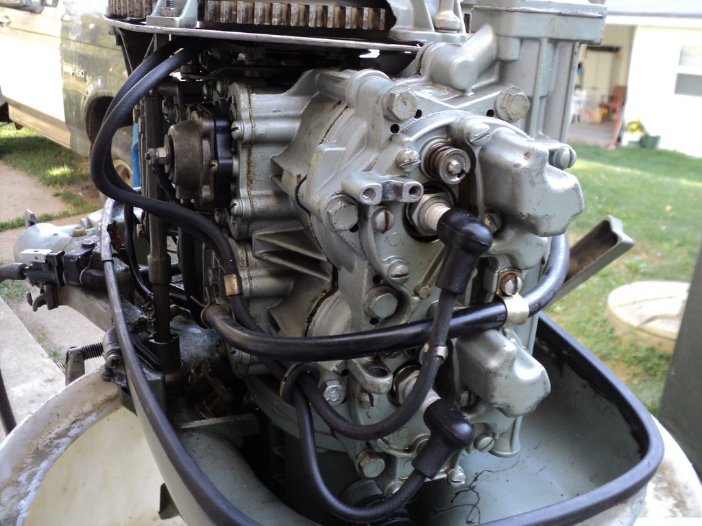

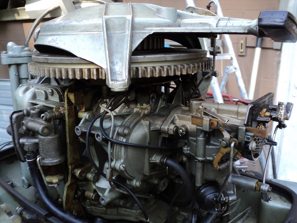

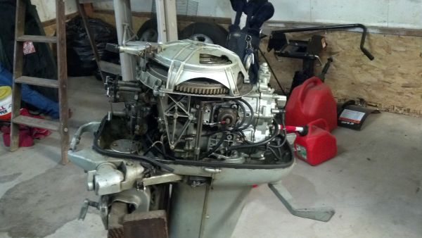

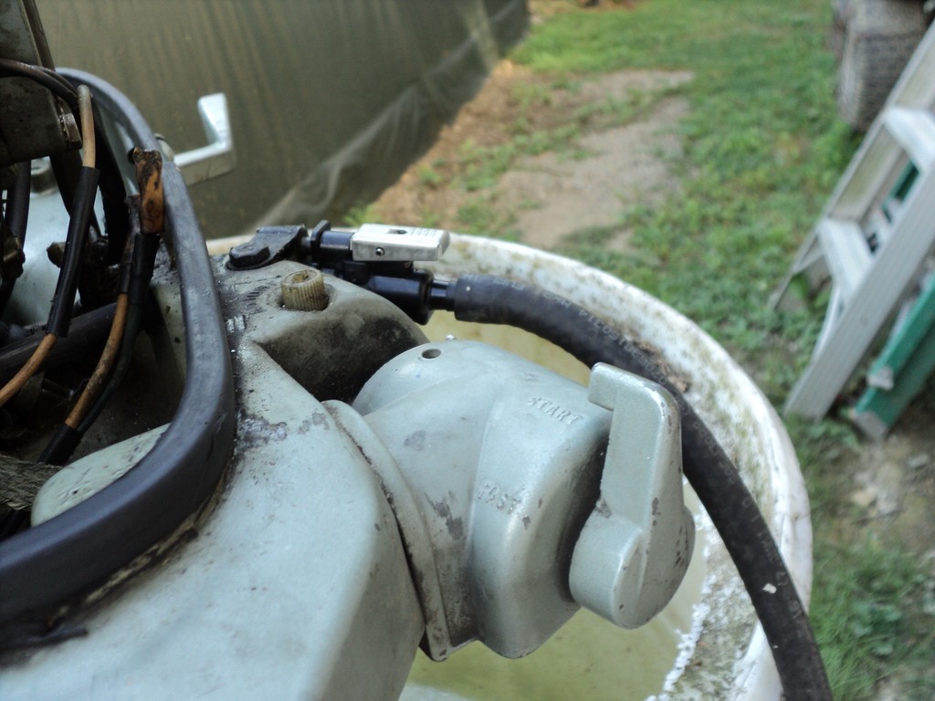

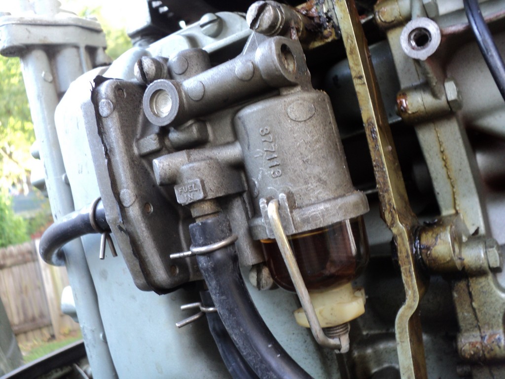

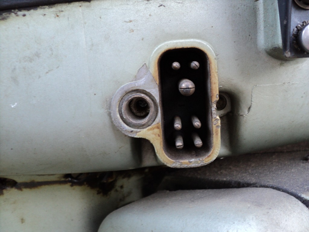

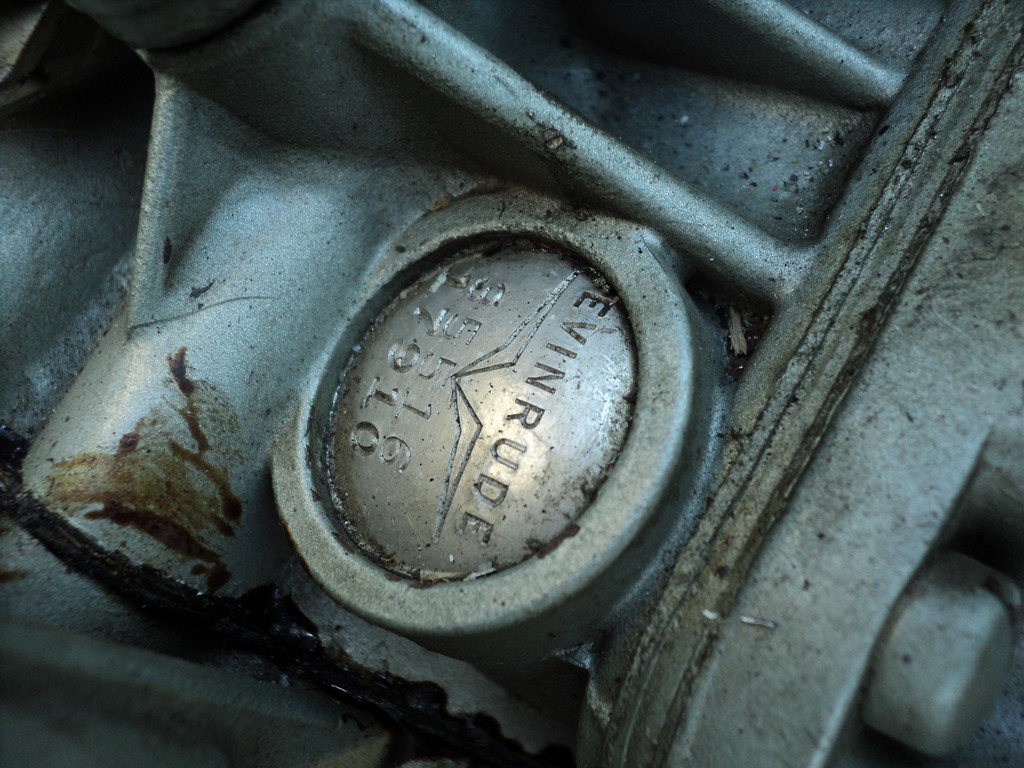

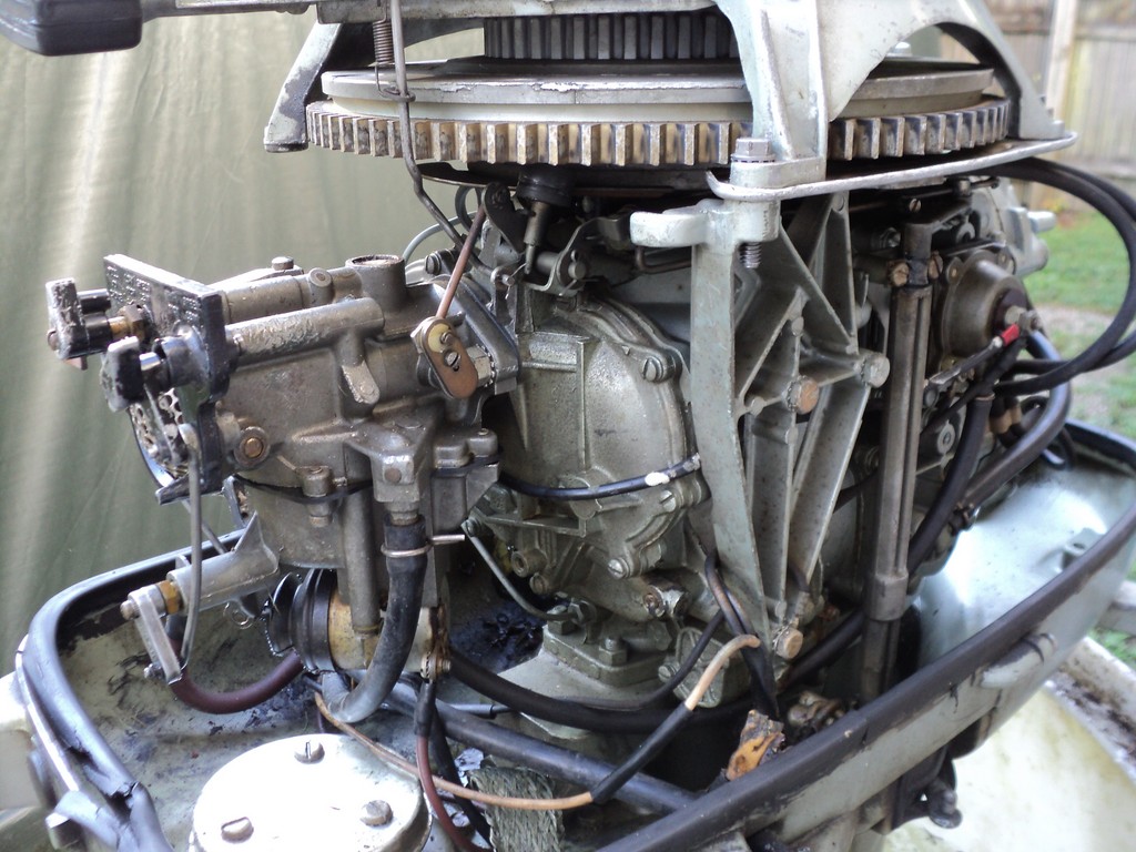

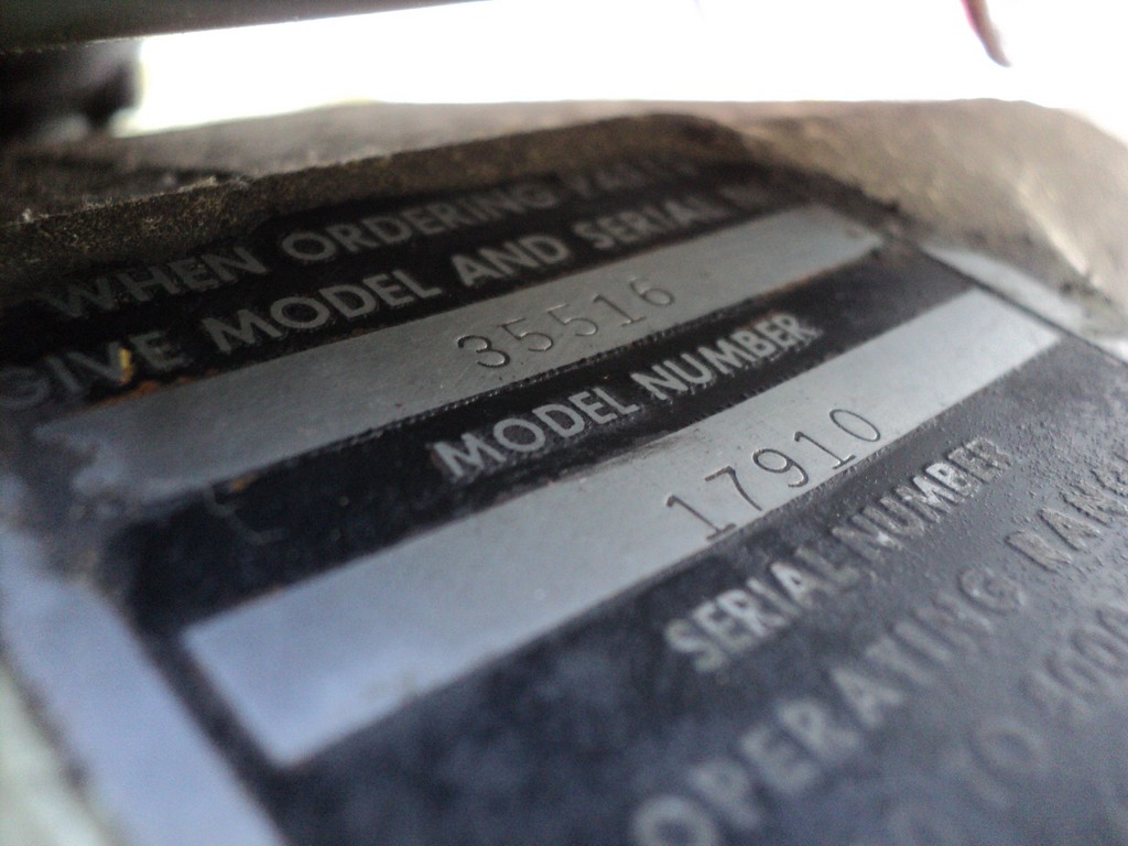

Re: What's your thoughts? ON 35 HP Lark 13 years 7 months ago #64159
Some pics. Starter is off. Any have any info from the numbers for me.
Re:What's your thoughts? ON 35 HP Lark 13 years 7 months ago #64176
  • Andgott
  • Andgott's Avatar
  • Posts: 1245
  • Karma: 72
Looks like a great score- Price was right. Those starters are easy to come by and pretty cheap if you look around. Should be an easy fix- The tough part, compression and spark, sounds like it's already been covered!
