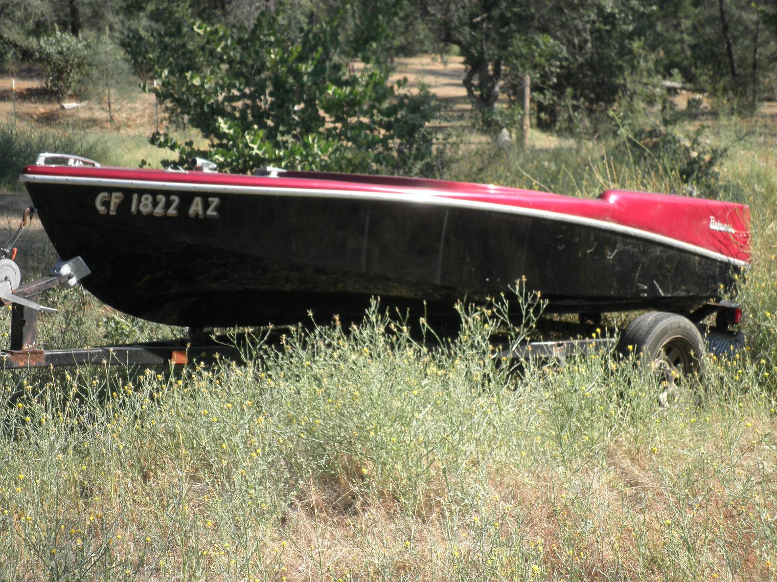

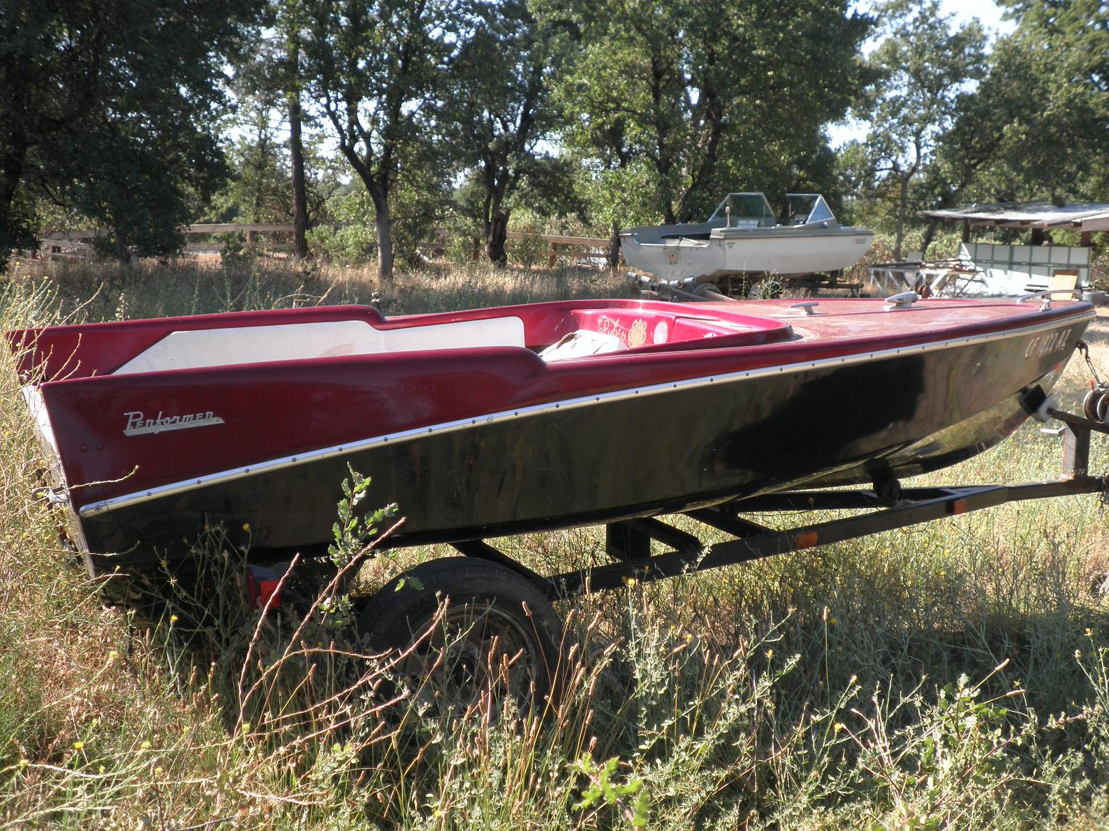

Here is the real crazy part; I had a beautiful little 1958 Performer "Havoc" at the ranch, just waiting for some TLC. A sure sign of having too many boats is forgetting what you already have. I snatched the little rocket from the weeds and dragged it home. It had been a restoration attempt by someone before I bought it 3 years ago. I bought the boat for 300 bucks. blown Johnson 40 motor, no electrical, no conntrols, no steering, no title or registration. It did have a decent set of custom made bucket seats and a paint job that looks awesome from 10 feet away. The transom, stringers, and floor were failing. But what a sexy little boat!

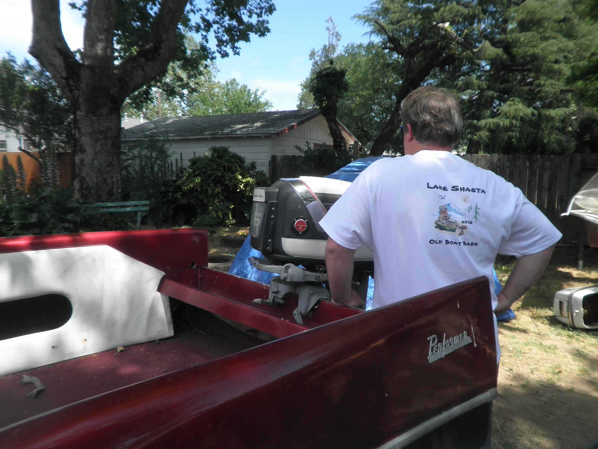

I pulled a beautiful little '57 Evinrude Lark out of the garage and put it on the transom. I had never tried to run the motor since buying it. I replaced the rotted fuel lines, and changed the lower unit oil. The seals in the lower unit were bad, so I put 140wt oil in for just the weekend I wanted to use the boat at Shasta. I removed all the throttle mechanisims and re greased them. Mounted the relay box inside the boat, installed the ignition assembly and herness that I had on hand in the shop. I had to rob the starter motor off another engine, as the one on the lark was burned out. I mounted the controls that came with the engine & hooked up the cables. I completely removed all of the old tiller cable hardware and replace all of it with good parts I had in the shop. I dug thru my stash of steering wheels and helms and found a match to the original stuff the boat was set up for. This prevented any new holes from being drilled into the dashboard. With the steering done, I dug through more of my stuff & found an aqua meter speedo & airguide pitot and equalizer pipe for the speedo. I used drip irrigation hose for the speedo line. Some tabbing under the bow had long broken away from the deck, so I did some glassing to get things back in shape for the water. I decided to reinforce the failing transom with a 4 ft. length of 1-1/2" square metal tubing I picked up for free. I drilled the tubing with 7/16" holes for the transom tow-eye bolts. I removed the tow eyes (which broke off when I tried to remove them from the transom) and replaced them with some good ones I had laying around. I used a little 5200 to seal the transom hooks before installing them. The bolt shanks passed thru the square metal tube on the inner transom face. The nuts and washers for the tow eyes were tightened down - and this drew the tubing tight against the transom wall. This simple step added much needed support to the transom - enough to make the boat safe to use. I tried to make a windshield out of some Lexan, but I ran out of time.

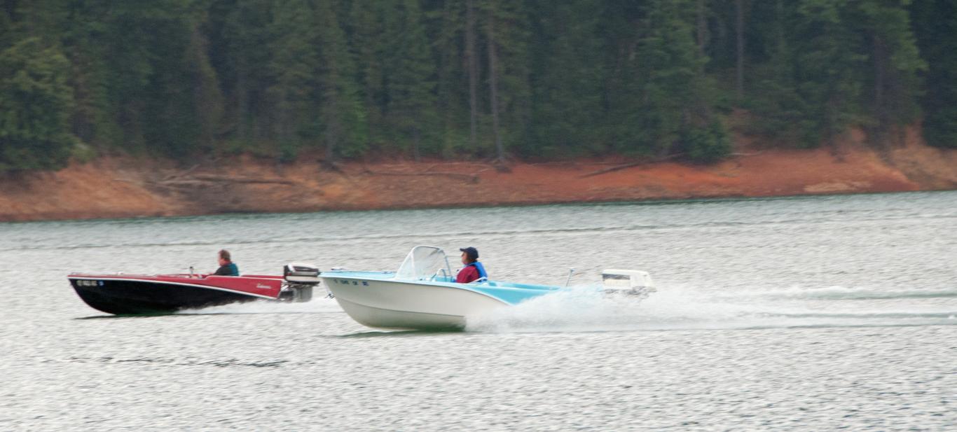

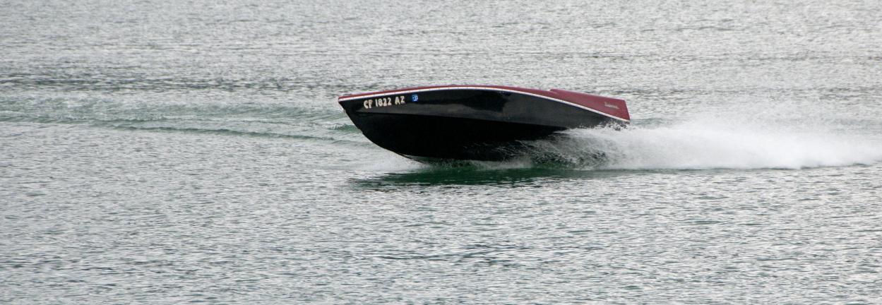

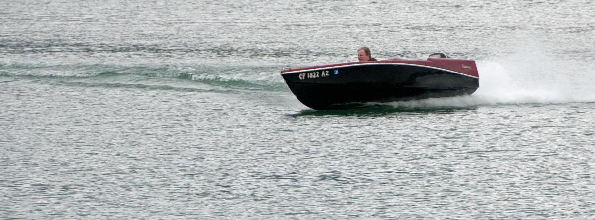

A couple PIX added - more to come. It's a little rocket. Look at the crazy turns it does...180 degree turns without cavitation. A blast to drive, even though the supports under the floor are wasted.
