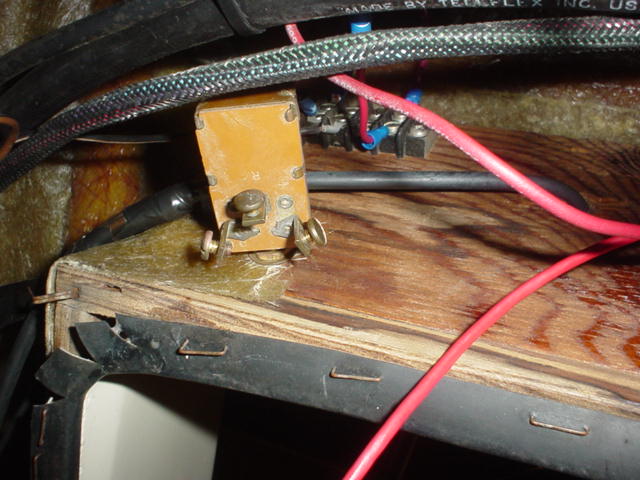

Can someone help me rewire the switch in the picture. Is it 2 reds and green or red/white/green?
I am assuming it's a 2 position switch. Do both powers go to busbar? where does green go?
When I get a new stern light-what's the proper way to add that in? thanks

Most Nav light switches are three position MrMitch. Off in the center, down for stern (anchor) light only, or up for both bow nav and stern light on at the same time.
Regardless, the power would likely go into the center connection, and the bow and stern each going to one of the outer terminals. If they are reversed, you could swap them out to make it as described above.
I would use some "liquid electrical tape" on those crimp connectors to help keep corrosion out of them, btw. ;)

thanks! I am just starting to do the wiring, so I will definately seal the crimps. There is a green and black(or brown) wire coming from the bow light-black(brown) spliced to switch and green to ??
BTW-the switch is the pull out type so there must be two positions.

One wire would be power (switched side) and the other is a ground normally. I think it's best not to trust the color codes if you don't know who wired it up originally, many times repairs and splices change the original configuration anyway!
They make push-pull switches in two and three position models as well, just have to check it out and see. A 12V test light comes in really handy on projects like this. :)

I can use my main power feed from the battery to the power block as my source of power correct? Then run a wire(what color?) to both lights-where does the diode go? Is it inline? The grounds go to the busbar?

Power can come from the battery positive.
Grounds all have to return to the battery negative.
I will try and find a SPDT Three terminal push pull diagram.
That is what your switch looks like. You can look on the Cole Heerse Switch Site at a 50082.
