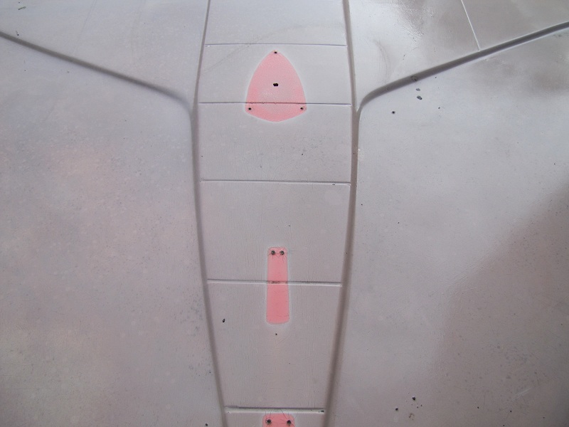

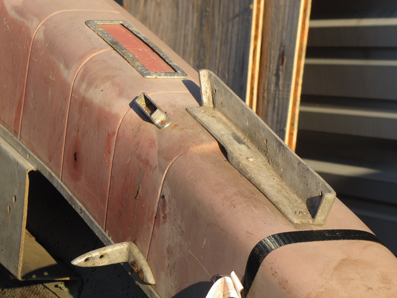

I am going to have the gelcoat on the deck of the Glastron media blasted off. Ultimately this will make the whole process a lot easier. The question I have is about a series of ribs, approximately 1/8" to 1/4" deep and 3/8" wide at various parts of the deck. These are in the gelcoat and could easily be lost after blasting. What is the best way of doing this? One thought I had was to grind this into the fiberglass. Since it is fairly shallow, I didn't think it would have a big structural impact.

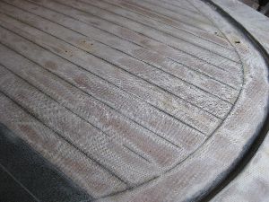

I have the same dilemma, only mine is the deck pin stripe pattern. I removed all the gelcoat down to the fiberglass, and am left with a very shallow pattern. I am going to fill and fair the entire deck, so I will lose the pattern alltogether. However, I did a pencil rub of the entire hull before I removed the gelcoat. So I have a pattern to go by. After I fill and fair the deck, I am going to try a very shallow router bit and cut it into the fairing compound. Any other suggestions out there?

You're going to loose it when the gel comes off- Or most of it, anyways. Lots of the 'details' on these boats is just in the Gel Coat.
You probably arent going to want to route directly into the fiberglass- Even though it's not that deep, the glass is often VERY thin. You can put a layer on the top of fairing compound or something like that, and route into that. I can't personally imagine doing that and having it come out right, but That's just me. My lines would be all over the place!
You COULD just paint on the details...
