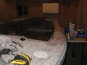

Ahhh yeah! Finally, after 7 hours of work, it has been accomplished! Feels GREAT! Tomorrow...time to install the front bench platform and then make stringers for the remaining portion of the floor. Pictures coming shortly.

Re:'61 Hydrodyne core finished!!! 13 years 2 weeks ago #62643
It looks great.
I am not far behind you. Just have to clean up the old glass and then lay the new core and glass on mine.
Andrew
Re:'61 Hydrodyne core finished!!! 13 years 2 weeks ago #62649
Thanks Andrew! A word of advice...just be patient through it all. I had to do it on my own, so it took quite a while, but it was worth it. After the core was resined in, I filled all the spaces between the balsa and white oak boards. Then I sanded it all and wiped down with acetone. I then pre cut the biaxial glass and layed it out over the core. I rolled it up and set it at the transom. As I worked from transom to bow, I wet out the core and then the fiberglass, continually moving forward 1 foot at a time. The key to keeping moving was having the West System available at all times. I set up a work station by the side of the boat, so I never had to get out. This prevented my feet from contaminating the core. When I did have to get out (and you will if you want to eat and survive :), I took my time to make sure my feet and clothing was free of residue. Hope this helps. Todd.
Dreams do become reality!
