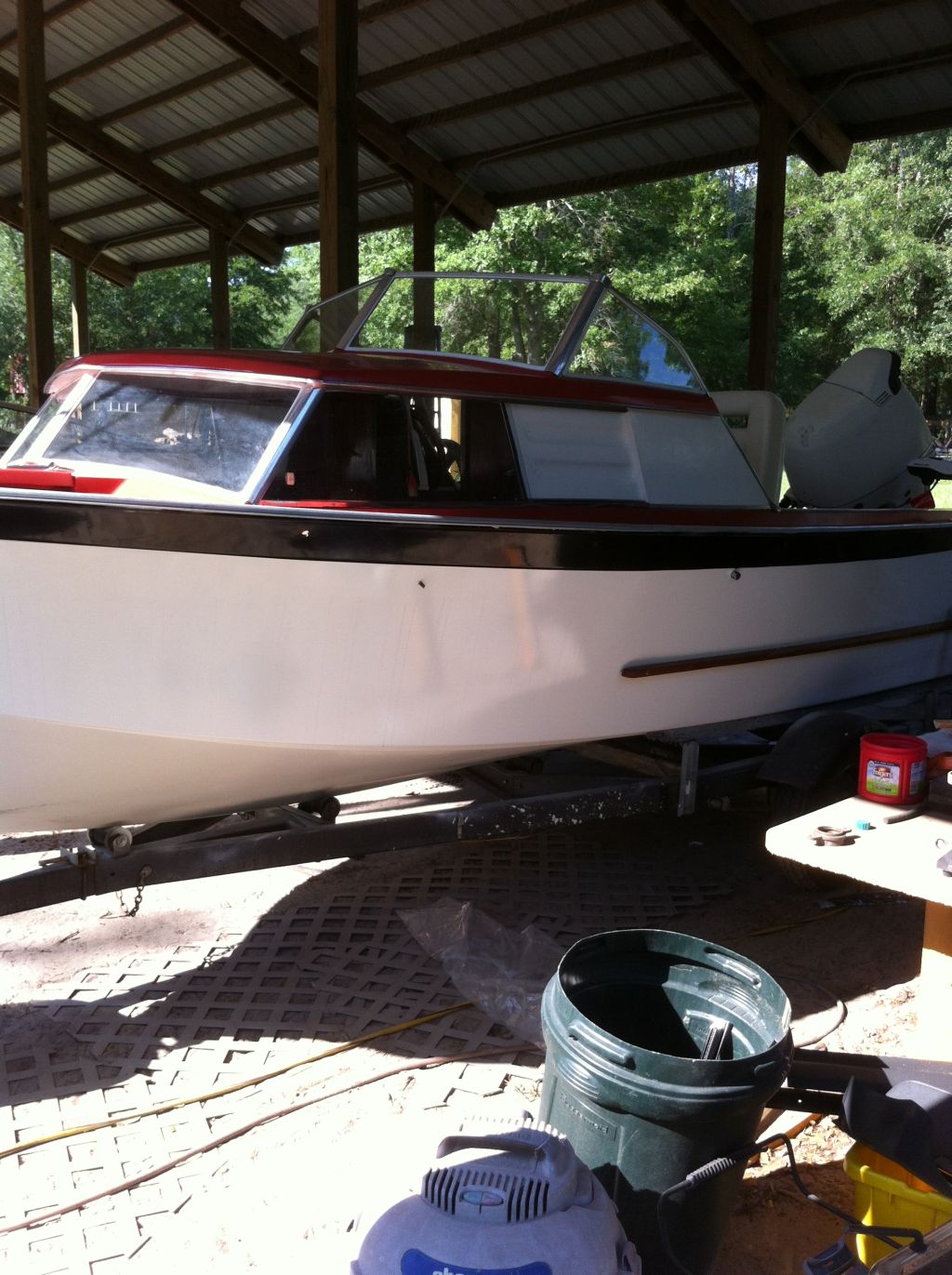

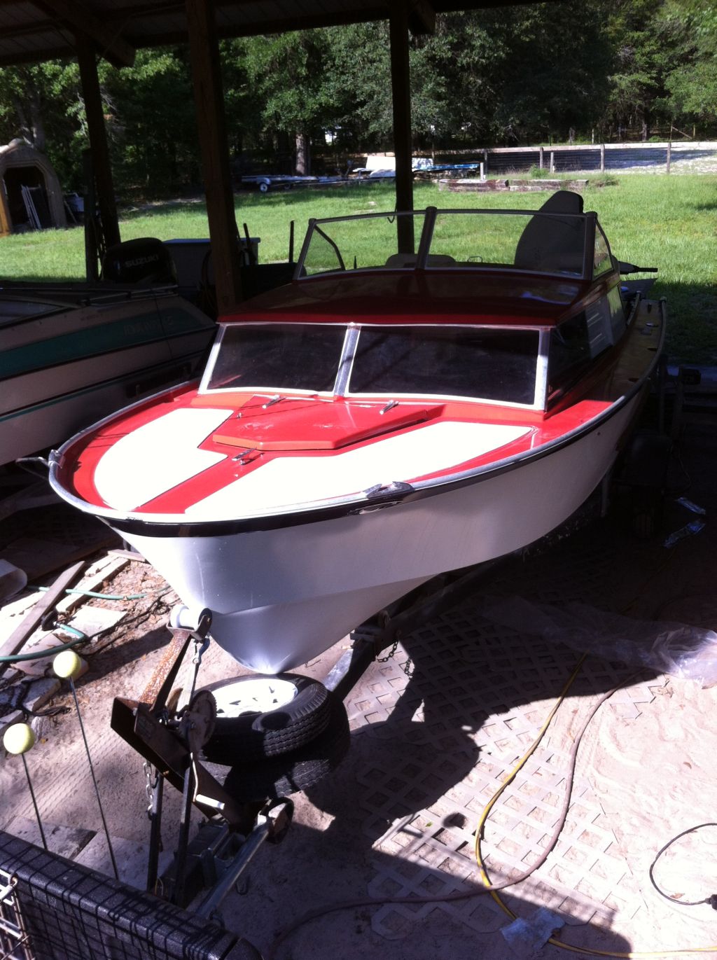

This is my very last boat project, so I want to do it up right!
PROGRESS SO FAR:
-Replaced floor and transom with Coosaboard.
-Replaced bad mahogany trim with new mahogany
-Replaced bottom sections of bulkheads with Coosaboard
-Cleaned up bottom and painted with two-part epoxy
-Primed topsides with two-part epoxy and painted with two-part polyurethane
-Stripped and polished all aluminum trim
-Used velcro to make new window channels
-Built seat boxes out of Coosaboard
-Epoxied teak and rubber plywood to floor
-Treated all wood with Smiths CPES
-Made new teak spray rails
-Primed cabin with two-part epoxy and sprayed with two-part polyurethane
-Installed hydraulic jackplate
-Installed LED stern light on motor cowl
-Installed LED running lights on bow flare
-Installed LED cabin lights
-Installed red LED cockpit courtesy lights
-Installed hydraulic steering
-Installed flush mount controls
-Rewired boat with new wiring and fuse panels
-Installed powered Pompanette seats/standing supports
-Filled in holes and refinished dash pods
-Made mahogany corner pieces to replace thin plastic corners
-Installed, plumbed, and wired stainless saddle tanks
-Refinished cabin footwell
-Replaced cabin seat supports with Coosaboard
-Made battery mount beneath port cabin seat and ran battery wiring forward.
-Removed toilet and filled hull holes
-Ground down damaged non-skid on deck and replaced with
-Replaced motorwell with early Seafair motorwell and reduced depth and setback
-Cut down and remolded side pockets to accomodate saddle tanks
-Replaced edge molding on side pockets, dash pods, and forward hatch
STILL TO DO:
-Replace rubber in rub strip
-Cover saddle tanks and seat boxes
-Reupholster cabin
-Install GPS/depth sounder
-Install hydraulic trim tabs
-Make convertible frame and get convertible top made
-Install boarding ladder
-Paint motor to match boat
-MAYBE build pad into hull
-Replace block in Suzuki 140 when water jacket patch eventually fails

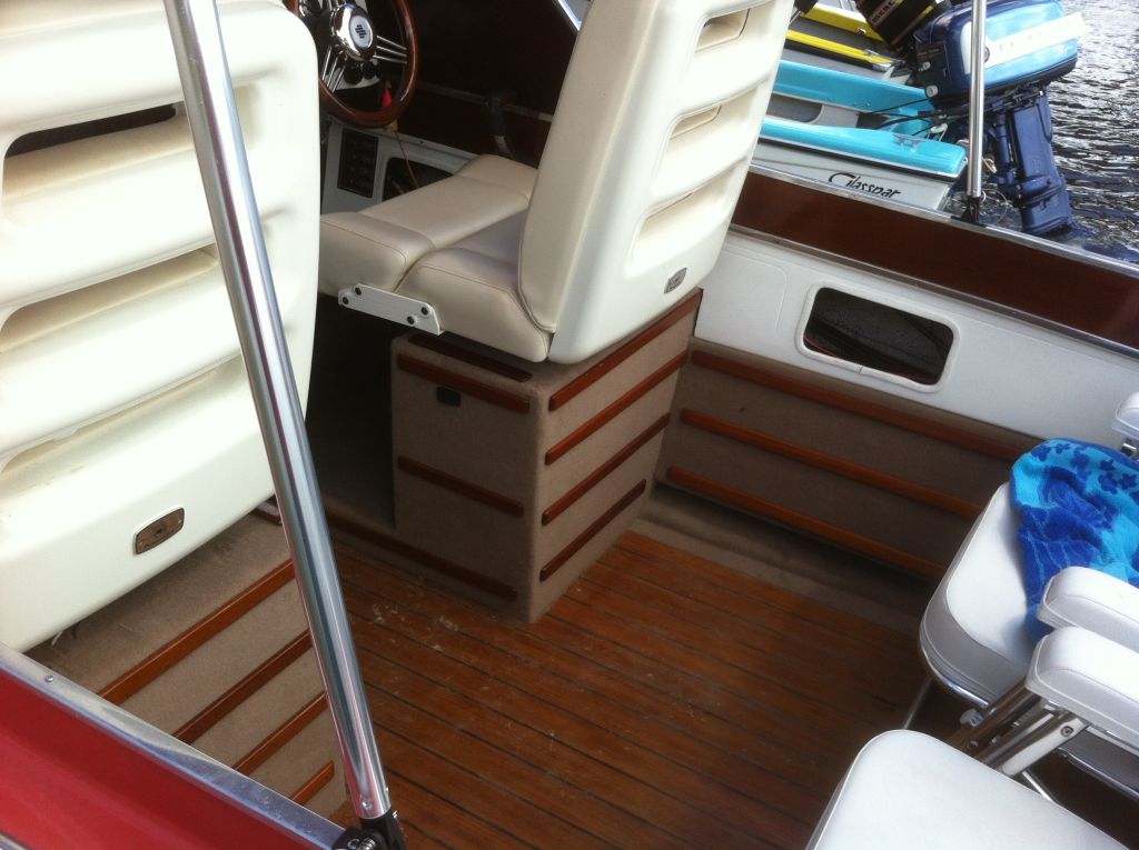

Re:Glasspar Seafair progress 12 years 7 months ago #71130
  • mtdoragary
  • mtdoragary's Avatar Topic Author
  • Senior Boarder
  • Senior Boarder
  • Posts: 223
  • Karma: 7

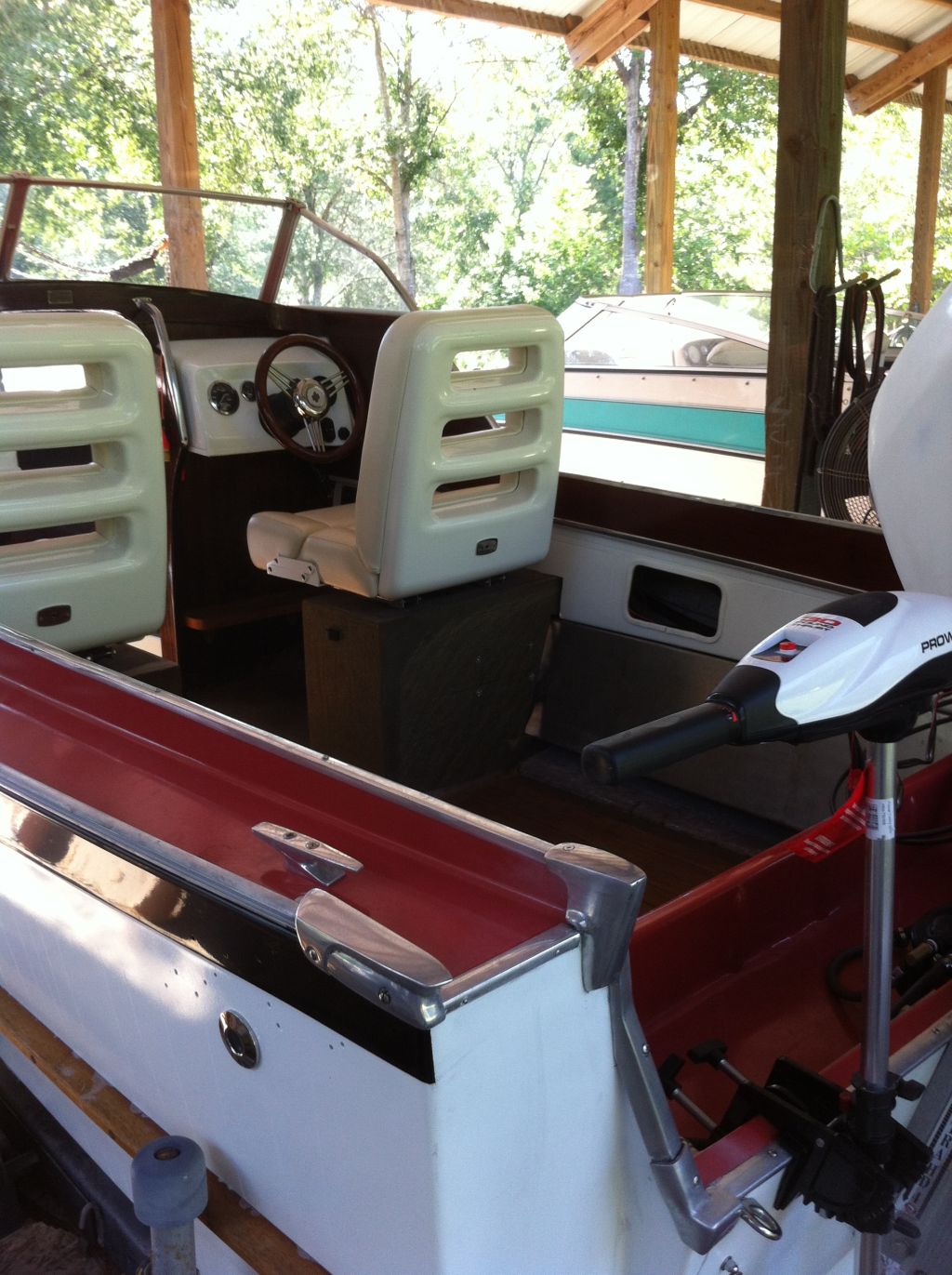

Did a little more work in the cockpit. Still have the cabin to do.

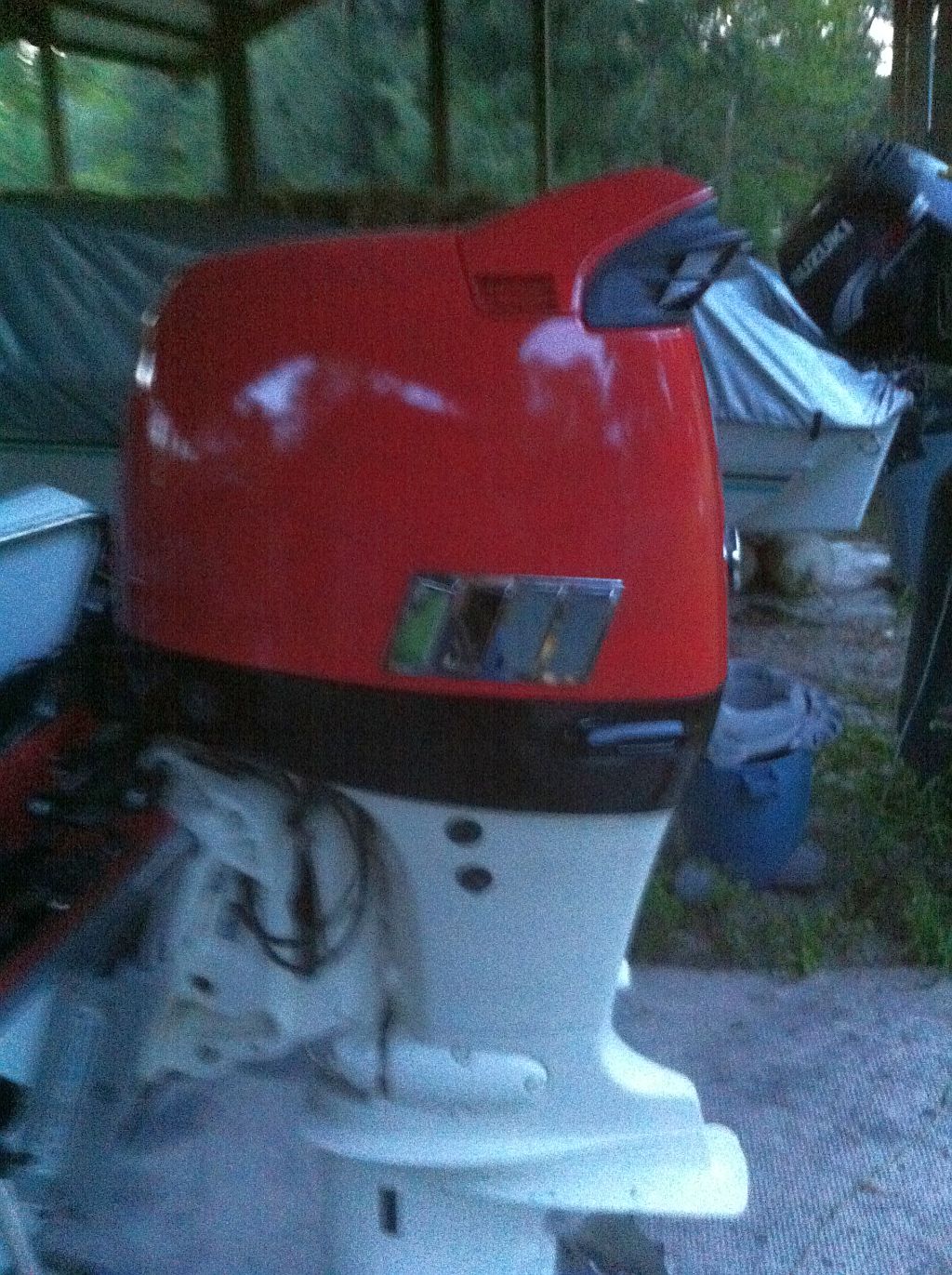

Re:Glasspar Seafair progress 12 years 7 months ago #71132
  • mtdoragary
  • Senior Boarder
  • Senior Boarder
  • Posts: 223
  • Karma: 7

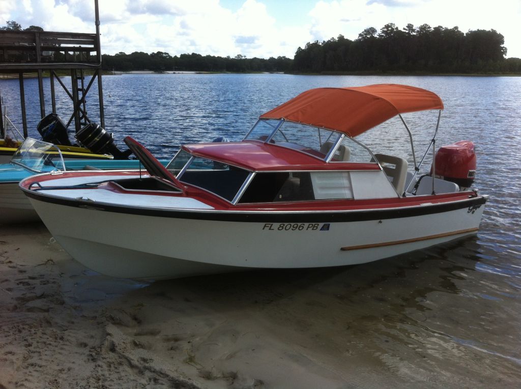

repainted motor
Blest boater

Re:Glasspar Seafair progress 12 years 7 months ago #71147
Your glasspar looks amazing. it has really inspired me to strive to new heights with my own sea fair. I really like how the interior looks, and the wood floor. I hope you don't mind me stealing some of your ideas :laugh:
Re:Glasspar Seafair progress 12 years 7 months ago #71193
  • mtdoragary
  • Senior Boarder
  • Senior Boarder
  • Posts: 223
  • Karma: 7
Go for it! That's why I post them. By the way, that's teak and rubber plywood epoxied to the CoosaBoard composite floor. Nearly the only wood in my Seafair is cosmetic!
Blest boater
Re:Glasspar Seafair progress 12 years 7 months ago #71209
Gary,....your Seafair Sedan looks GREAT Buddy!! ;)
Your attention to detail is commendable.

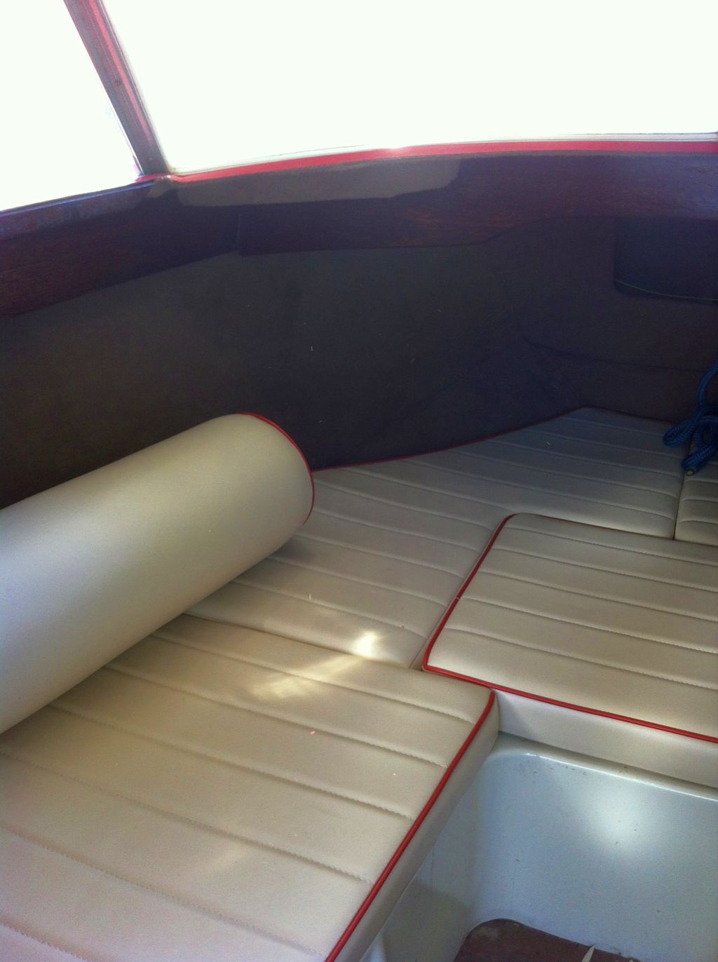

Re:Glasspar Seafair progress 12 years 5 months ago #73741
  • mtdoragary
  • Senior Boarder
  • Senior Boarder
  • Posts: 223
  • Karma: 7

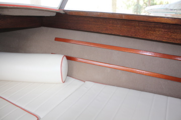

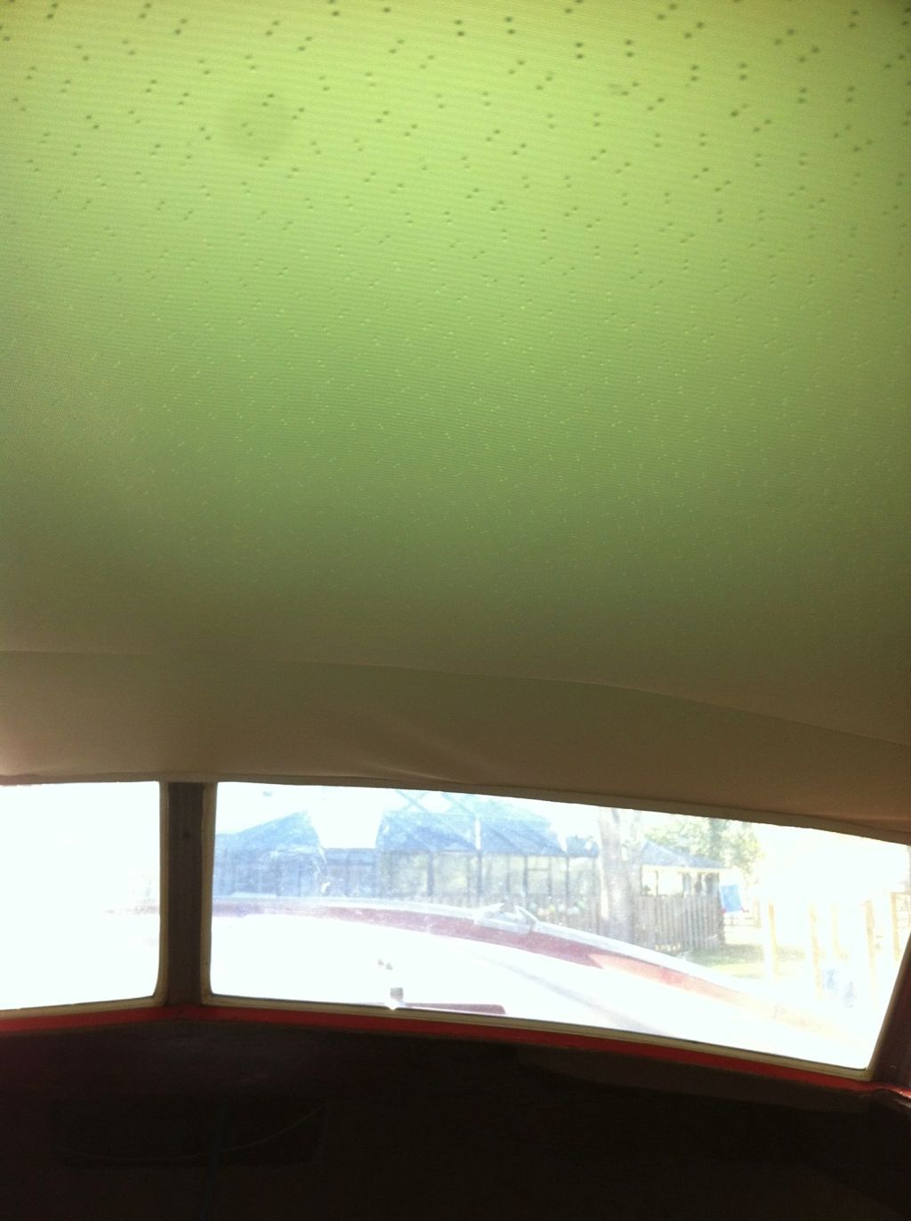

Dropped the Seafair off at the upholstery shop for the cabin redo. Rolled and pleated cushions to match the Pompanette seat upholstery. carpeted topsides to which I will attach teak as I did in the cockpit. Perforated vinyl headliner over insulation. Gonna be cozy! If only there were a way to air condition it during the hottest part of summer!
Blest boater

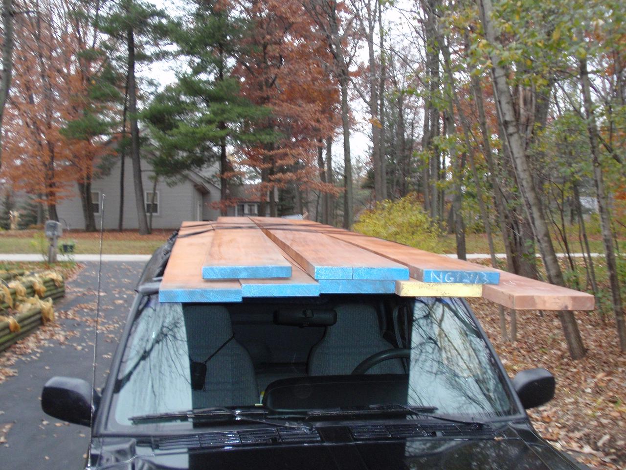

Re:Glasspar Seafair progress 12 years 4 months ago #73917
natuoregon wrote:
Phenomenal! Id be happy to get a repower in mine.
Did the new Mahogany set you back considerably? Mine is in pretty poor shape finish wise.
Looks awesome!
I don't want to hijack Gary's thread here but you asked about the cost of mahogany. Our East Coast Glasspar Owners Association is restoring a 1964 Glasspar Seafair Sedan and it needs almost ALL of it's mahogany replaced. New Honduran Mahogany here in eastern N.C.
runs $14.00 a board foot!! :ohmy: However, I was able to get some leftover boards from a job the company had recently done and those boards sold for half of what the brand new boards did. ($7.00 a board foot.) Hope that helps you some Sir. ;)
Re:Glasspar Seafair progress 12 years 4 months ago #73921
Looks awesome!
Mahogany was free. I loaded up my truck with it when a local boat restoration shop closed down.

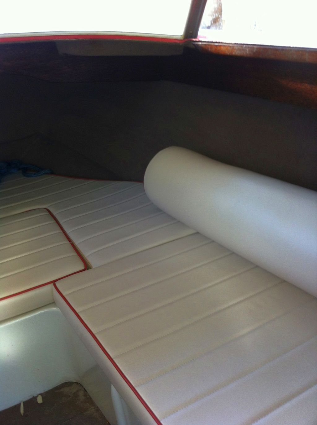

Just got her back from the upholstery guy.
Blest boater
Re:Glasspar Seafair progress 12 years 4 months ago #73988
wow gary,it looks great,i have been waiting to see the upholstery,wow.

Thanks guys! Now I have to find time to make the battens, and refinish the cabin woodwork that goes around the bulkheads.

wow i am really likeing the colors it really looks great!!

Looking great.
Summer enjoyment coming soon!!

Neil wrote:
Looking great.
IF I find some spare time while trying to sell my Florida home and make my Alabama home liveable!
In the last three days, i've resodded the lawn, repaired the sprinkler system, sanded, stained, and varnished the front door, got a puppy ready for shipping, bought plants and soil for planting a border. pressure washed the house, pressure washed the walkways and patio, repaired some plumbing, ...
