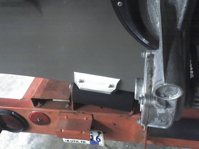

Here is a photo of the metal part I plan to bolt onto.
Re:Fat trim tab 13 years 7 months ago #64259
How is your boat for trim? mine was leaning to the drivers side alot. I moved the trim out onehole on my rude and it fixed the proplem and gave me 1mph more on gps.That looks like a zinc on the rear of your hull there. It doesn't make a good trim tab and i wouldn't be trying to mount one to it. They are made to corrode away so the alum on your boat doesn't. You may have to pick up a set of tabs for your boat if you can't figure out a cure. Skip.
