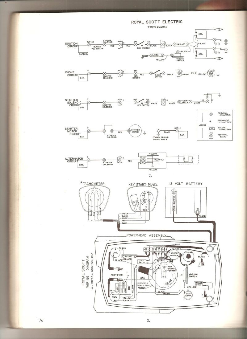

My '61 Royal Scott has a ballast resistor between the ignition switch and the ignition terminal at the motor. I can't get a decent idle, yet motor runs good at fast speeds. I measured the voltage going into the resistor at 12.4 V but coming out is only 3.4V and 3.1V at the ignition terminal at motor. Does not seem like the ignition runs at 3.1 volts, I was going to bypass the resistor to see if that helps. But I did not want to if the system really is designed for 3.1 V. Low voltage to ignition system would explain the rough idle.

There is a general Scott electrical guide in the Glassic Library section here: Scottmanual 007 pdf . And assuming the diagram matches your's, no there should not be a resistor there. The diagram does show a ballast resistor on the engine coming from the coils to the switch, but on the ground wire.

I have attached a wiring diagram for a 1961 Royal Scott and it shows the ballast resistor between the ignition switch and the positive terminals of the two coils.

From what you have posted I don't believe your problem is the ballast resistor. Resistors rarely fail and when they do it's usually open circuit and the motor won't run at all.
How did you measure the output voltage of the resistor? Was the the motor running or off? The only way to accurately check the resistor is to either have the motor running or to disconnect the resistor from the system and check it's resistance. It should be roughly between .75 to 1.5 ohms.
From your results it appears you checked with the motor not running and the points closed. That would probably result in a 3 volt output from the resistor.
To rule out the resistor check the output voltage at idle with the motor running. It should be somewhere around 7-9 volts. If it really is 3 volts with the motor running, then yes, go ahead and bypass the resistor, but don't run it permanently, or more that a few minutes or you could damage the coil and points.
