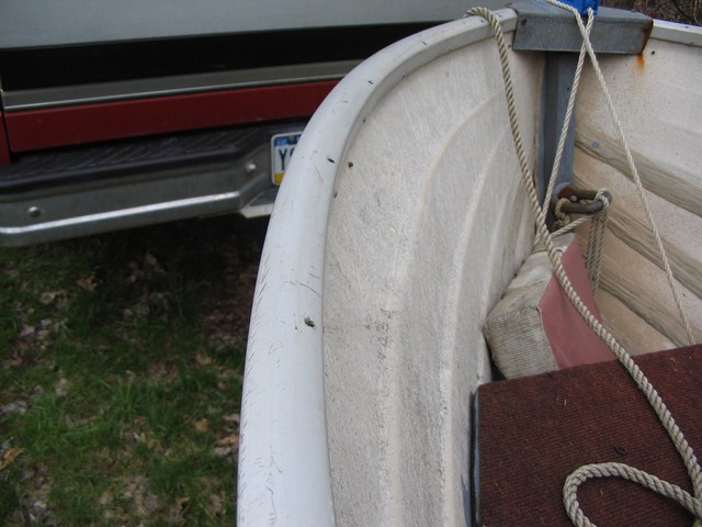

My 58 MFG has the wood bedded with fiberglass but not over it. It has a full wooden interior keel. I never had it off because it is in good shape but I did take the nut off and installed this to tie my anchor rope on. I thought i had a newer better pic. This one is old. My boat now has a fore deck on it.

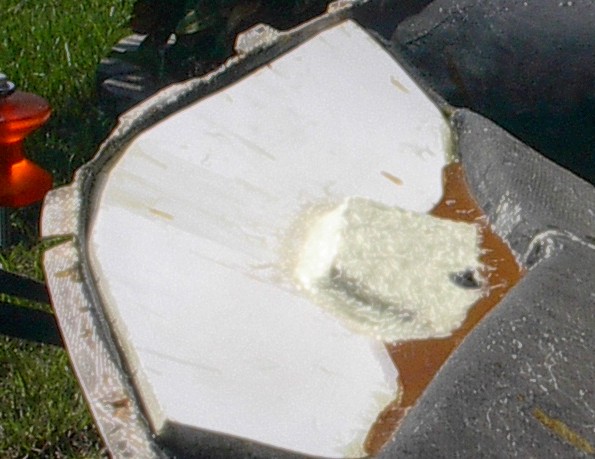

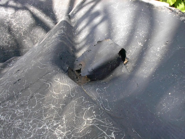

This is how the factory did it on our Manta Ray.
Leaving the corners of the 2x4 wood block exposed and in a spot that collects water was not good. The wood was worm food by the time I got it.
To repair I cut out the FG straps and ground flush. Laminated 2 scrap pieces of 3/4" PVC sheet with epoxy. Covered bolt hole in hull with a piece of clear packing tape(exterior side). Thickened up some epoxy, buttered one side and clamped in place. I also added some backer board around it, nothing to do with bow eye. When cured I removed clamps. Thickened some more epoxy and added 1/4" chopped FG and covered the block. When cured drilled hole.
Some things to pay attention to. Make sure your blocks inside surface is parallel with the outside surface of the hull so the washer will make full contact when tight. For the same reason when you drill the hole make it 90 degrees to the hull surface. Just like when drilling holes in your transom, seal the wood inside the hole.
