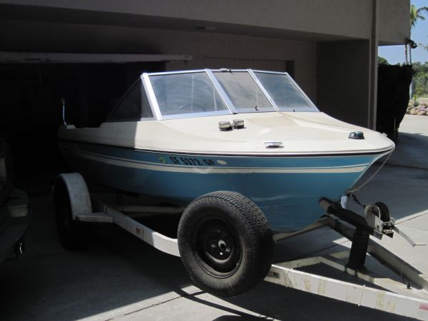

Here's a pic from the for sale ad. This is the fiberform.

That fiberform looks pretty nice for the money- The trailer alone looks to be worth that! Buy it, enjoy it, and keep looking for that classic that you REALLY want...

Wish I could find a Fiberform like that, I'd snap it up in a heartbeat!
Is that a Vee-hull model? Think they called them the "Mosquito". A buddy of mine had one like that, with an old 90hp Selectric V4.
I had an older '69 Fiberform 14' with the same V-hull as his, and ended up installing a '64 Merc 850 with 100hp carbs & exhaust manifold.
He could *almost* keep up with me if he tilted the motor out real far, but normally I would run away from him. We sure had a lot of fun with those boats, and I recall one calm morning going 50mph down the lake with a 23" speed prop. Those were the days, when you could afford the gas to run that fast!!!
The Merc 700 Triple should push the little 14' OK. With a 650-4 my 14' would run 37 mph in the lake. You'll have to prop the Triple to achieve proper Wide Open Throtle rpm, you can't lug those motors.

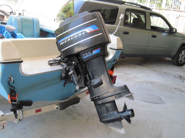

There should be no shortage of burnt-up 70hp and earlier 65hp Triples so you should be able to find lots of parts!!!!
If I'm not mistaken the props for similar-vintages of 40 & 50hp models should fit as well. Important thing is to note the number of splines on the propshaft and be sure they match up. 13 splines if I remember correctly.
The 70hp has an "overdrive" lower unit so you don't want a prop with tons of pitch; she needs to rev to live. No larger than a 15" pitch and that may be too big. I bet a 13" would be right in the ballpark.

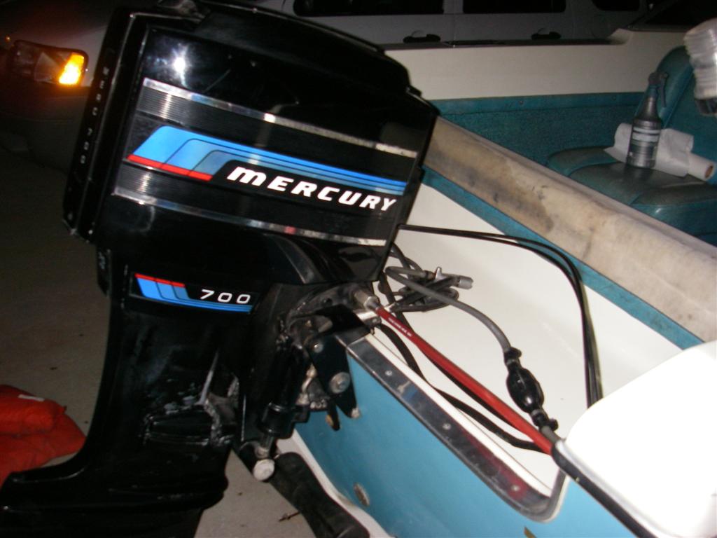

Thanks for the warm welcome. I ended up not taking it home on Monday. I still didn't have a great spot cleared out to keep it and she was more than happy for it to sit in the garage another few days. It's been there 35 years! If I get home in time I will bring it home tomorrow night.
Here are the other 3 pictures from the craigslist ad.
Re:First post, looking for first boat! 13 years 3 weeks ago #62236

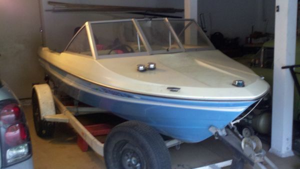

I guess 1 pic per post? No problem!
Re:First post, looking for first boat! 13 years 3 weeks ago #62237

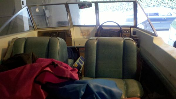

And the last one for now. Not the greatest interior shot. The passenger seat has a small tear right at the top. Lots of boating stuff piled in there, can't wait to use some of it.

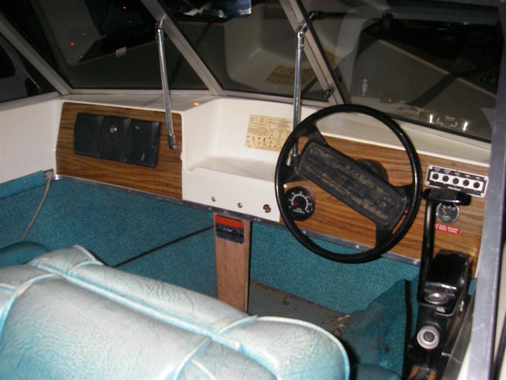

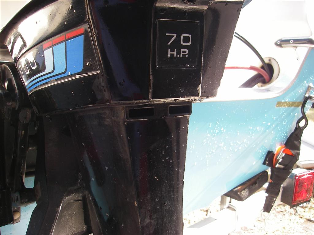

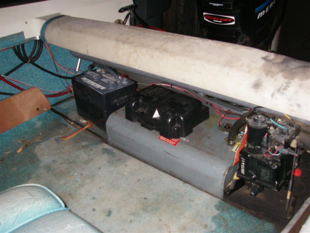

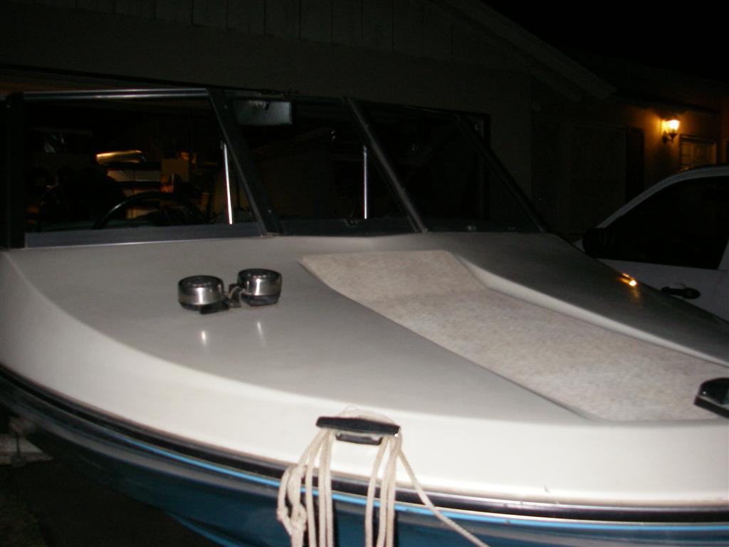

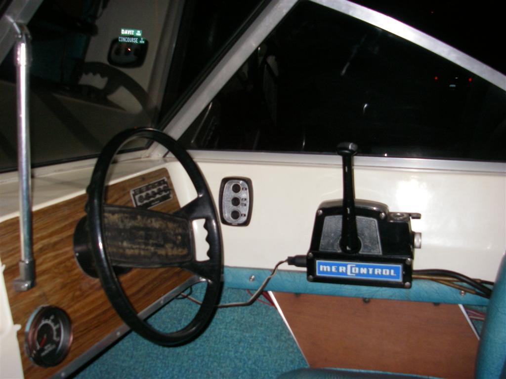

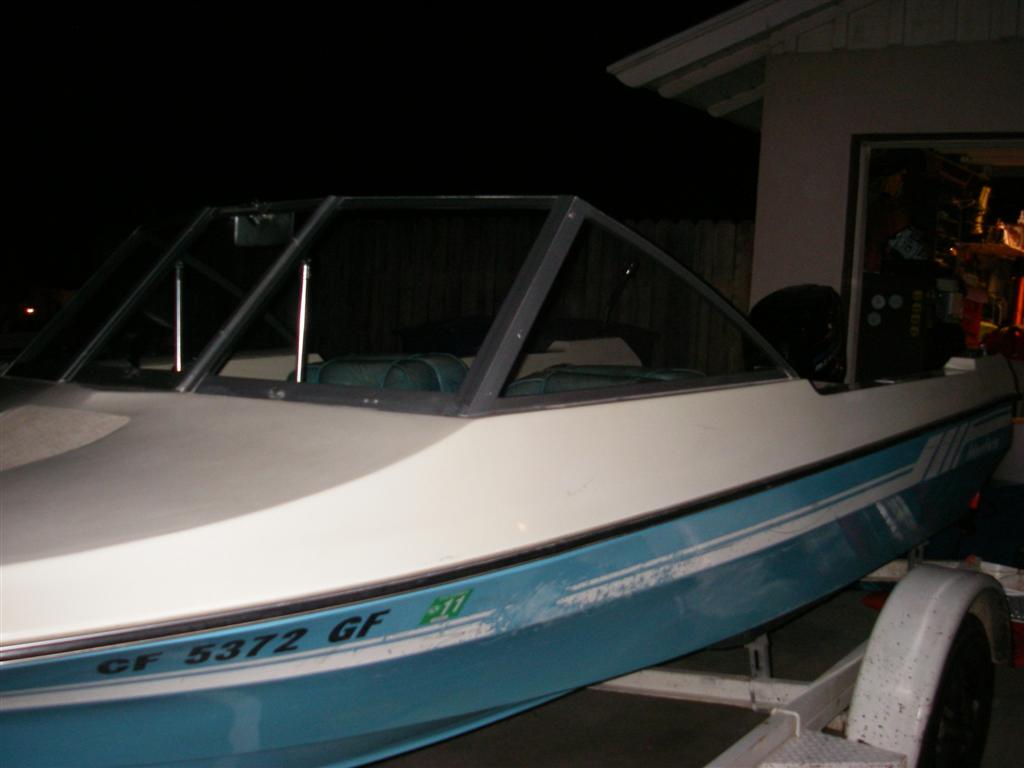

So the boat is home. Ended up getting it for a bit less than I thought I would. $400 and she paid the transfer fees at the DMV.
Spent a few hours cleaning and polishing. I'm very happy with it. Used Mcquires swirl remover, really did a nice job cleaning up the finger marks and brightening the gelcoat.
For the heck of it I threw a charger on the battery that has been sitting for 8 years. It actually took a charge. I'll probably replace it anyways, but it's nice to be able to test all the stuff.
All the electrical works. The battery cable to the motor needs to be replaced. The insulation falls off if you look at it wrong. It's duplex cable, if I can find some I will use it, otherwise it will get regular 4 awg cable which I already have.
I found a useable spare propeller under one of the seats, that's nice.
Added some fluid to the power tilt. So it would go all the way up.
Tires are in good shape.
I sprayed some 2 stroke oil into the carbs and cranked it over with the pull rope. Also squirted some into the cylinders. Feels good and no surprises under the hood.
I might get a chance to do the impeller tomorrow, but don't want to spend all day working on it again. Not exactly in the dog house with my wife, but I don't want to push it, lol.
Here's a few pics after cleanup. It's 1 in the morning, pictures could be better I guess.

Lookin' good there Etc., I'd say she's shinning up pretty nice! IMHO you got a very reasonable deal, looking forward to seeing some "on the water" shots.

No matter how good the tires look, if they are that old the sidewalls have weakened considerably. There is a way to date code them based on the sidewall imprint. Any trailer tire older than 10 years should be replaced regardless of how much tread remains. Hate to have a blown tire destroy such a great find. Enjoy!
Re:First post, looking for first boat! 13 years 2 weeks ago #62569
Good call on the tires. I won't take it on any highway before I get new ones. That'll also give me a chance to put the matching rims on the trailer with the hubcaps. The spare rim is mounted with a new tire and the hubcap doesn't fit. They'll be cheap anyways, 14 inchers.

Great find, but I do have one question. Is that a built-in gas tank? Is it fiberglass? If so, you could end up with some serious problems from the ethanol in gas. Might want to consider using portable tanks instead if it is a problem. ENjoy

Good point Todd. It looks just like the Tempo brand tank that was in the bow of the CVX. Looked great on the outside, but full of rust on the inside. Whatever the case, I'd agree that it definitely needs to be checked carefully before using it. ;)

Thanks for the heads up on the tank, didn't even think to check. When I got home I checked it first thing, it's pretty darn clean. I drained what little gas was in there a few days ago and it was clean also. It's a steel tank.

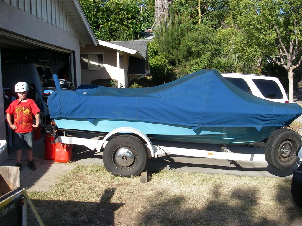

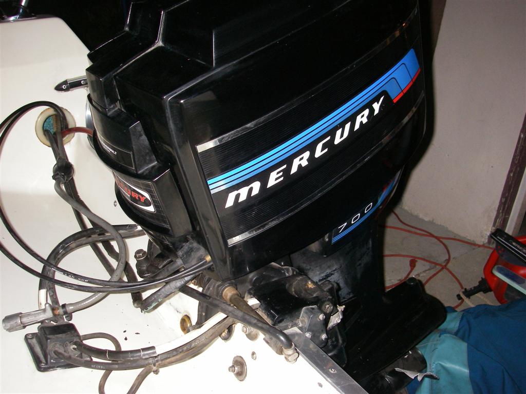

If you could see me you would be looking at the happiest person with a boat. Impeller installed. Check. Fresh gas mixed and poured. Check. Cut down 55 gallon barrel in position and filled with water. Check. Fuel line connected and spark plugs torqued. Check. Primed. Check!
Pushed cold start lever forward, held choke button. Turned key for about 2 seconds and it fired right up!!! I mixed it a little rich because it's been sitting, so it's a bit smokey. At least at idle in a barrel she runs sweet!
Thanks for the advice given here.
Couple shots.
Here's the setup.
Here she is running at idle after the smoke cleared somewhat. Too bad we don't have mosquitoes because the initial smoke cloud would have cleared them all out.

mtdoragary, If the connector or more of the wiring starts giving me trouble I'll do what you say and wire direct. There is about 3 or 4 feet of extra harness coiled up in the boat. I actually considered doing it anyways, but found the big connector and didn't want to mess with it at this time.
Tested forward and reverse, I might be ready to head out tomorrow. Went to full throttle for a second, boys got a kick out of that. Kind of nice having a barrel full of water to test in. Was very careful to no allow the water level to drop below the intake ports.
I have a question for you guys, not sure if this is right or not.
While running water is coming out of the exhaust ports under where it says 70 HP in the picture. 2 rectangular ports side by side. I don't recall water coming out there during the first test. Some exhaust exits there as well, I assume that is normal.
Thanks again for everyone's input. It's great to have a site like this for a relative newbie like me to rely on. If I can get the honey do list whittled down I'll take it out tomorrow.
