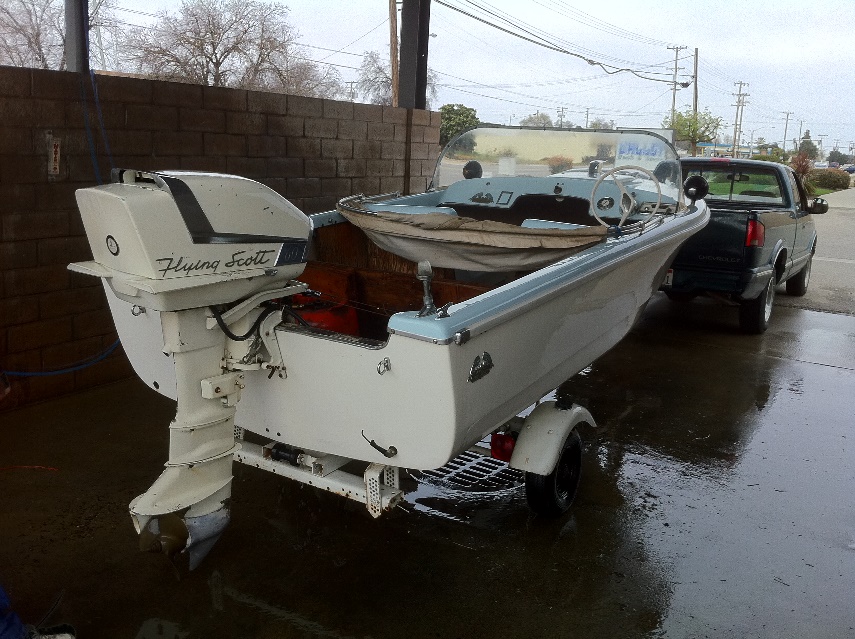

Got this running today! It was a simple wiring mess up to the key switch. That engine has been sitting for about 7 years. It was running very rough and was grumpy (back firing and so) at first. Then after a little while of blowing all the crap out it was running great! This machine sounds BRUTAL! Now that this one is going, its time for the next one. I have another 1959 60HP Flying Scott identical engine sitting, its a little rough to start with but would be fun to have going also. Thank you everyone for the help. Ill let you know how the next one is going.
Re:1959 60HP Flying Scott Engine 13 years 3 weeks ago #62231
Very nice lookin scott! I still have 1 like that, and several a bit newer, Good luck.
