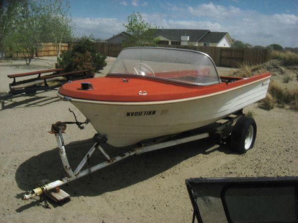

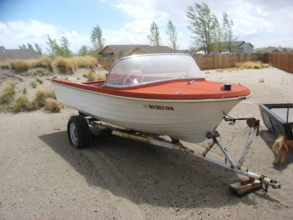

I needed a utility beater for the Shasta meet in late June. I found an ad on the Reno Nevada Craigslist for this 1964 Seaking - price 100 bucks. Only problem - the boat was 300 miles (one way) from where I live. But not to worry - I had a nice enpty trailer, and I'm insane. Lucky for me, I have a buddy that lives down in Reno, which is right along the way to the POS boat out in Fallon. So I justify the boat rescue because I was due for a visit with my old buddy. I can live with that. So, I was smart enough to service the trailer bearings before I left town. The trailer lights even worked. That's pretty good for me...........
Bought the boat from a fellow glasser over in Fallon. Boat was a bit rough, but I've seen way, WAY worse. After driving 300 miles to get the thing, there was no way I was going to leave it there. Turned out the windshield was uncracked, it had a restorable steering wheel & helm, the hardware chrome is perfect (nevada) transom looked good - floor, maybe not so good. I loaded her up & paid the seller 100 bucks. after a tour of the seller's outboard collection, I pulled this puppy back to Redding. No tickets or mechanical problems for the entire trip. Sweet.

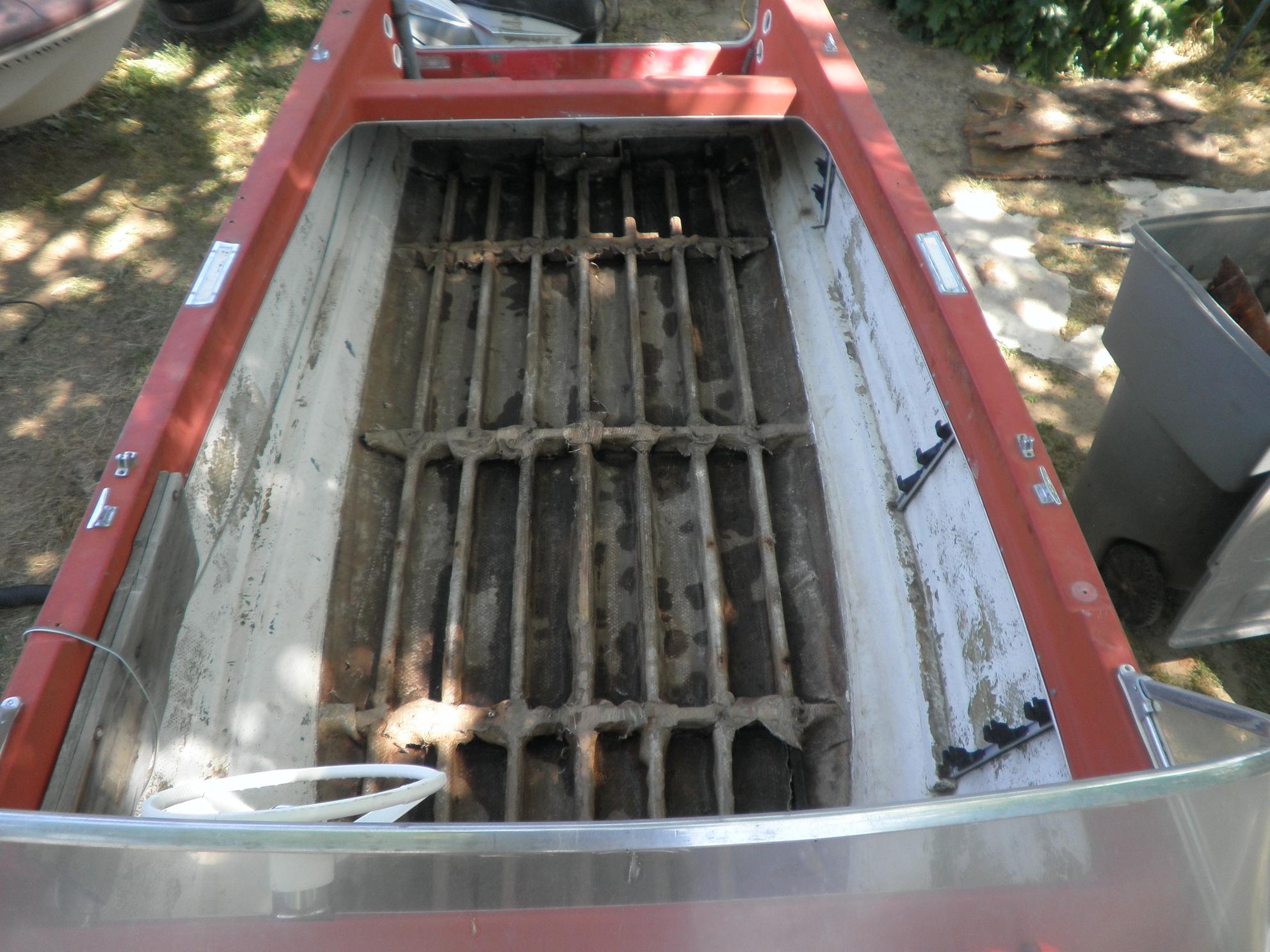

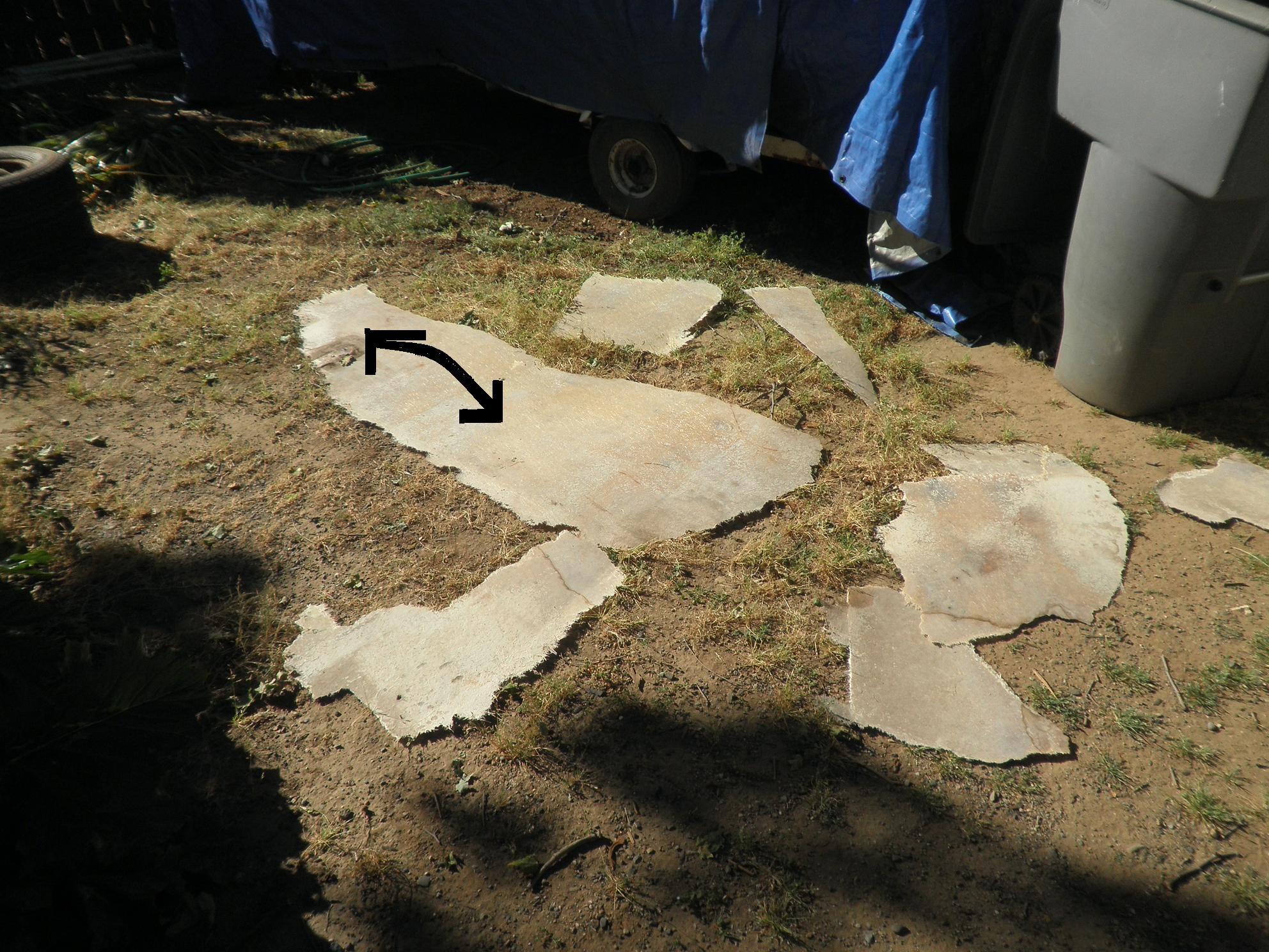

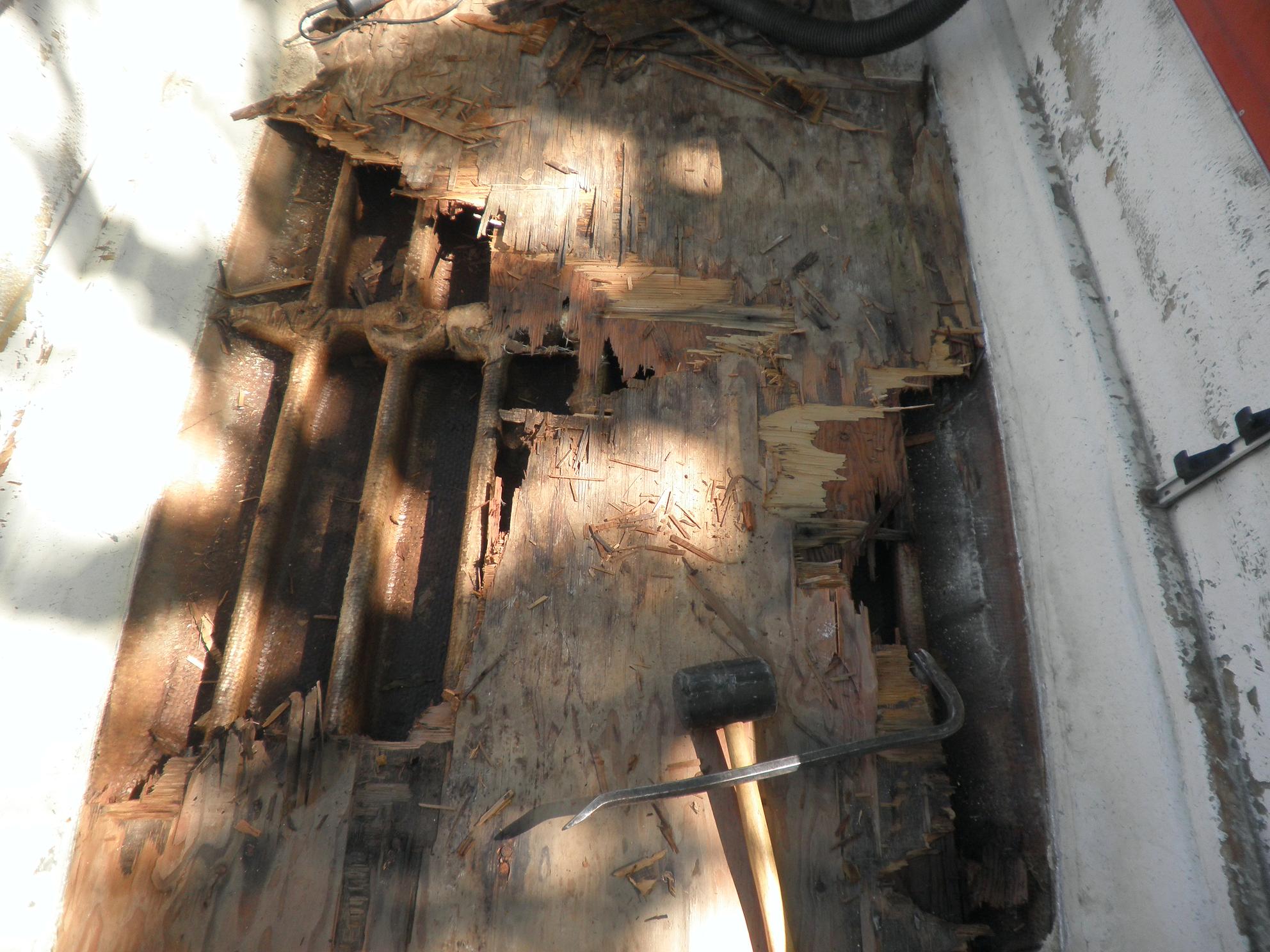

After cleaning out all of the sand and trash, it's obvious that the floor in the Sea King is shot. There is a large hump in the flooring that runs 2/3 of the way across the boat. It's unusual, as the defect is limited to this one place in the flooring. I'm guessing that water was pooled under the floor and froze solid, pushing the plywood upward. Also guessing that it has been this way for a LONG time. If this boat is going to be used for anything but yard art, the floor has to be replaced. Now I'm really feeling dumb. I now need to evaluate if the rehabbing boat is worth pursuing any longer. Keep in mind, the goal is to make an inexpensive work boat - not a pretty restoration. This is a tough call.
I'll update later.

Bruce, if you just want a workboat, saw out the humpy 2X4 and replace it with a treated one, sister some 2X's alongside the other frame pieces and screw down some 5/8" treated over it. Nothing fancy but you will be quickly and cheaply back in the running.Glue some in/out carpet over the top for a little "appeal". This will give you a few years of running as long as the hull is not comprimised.

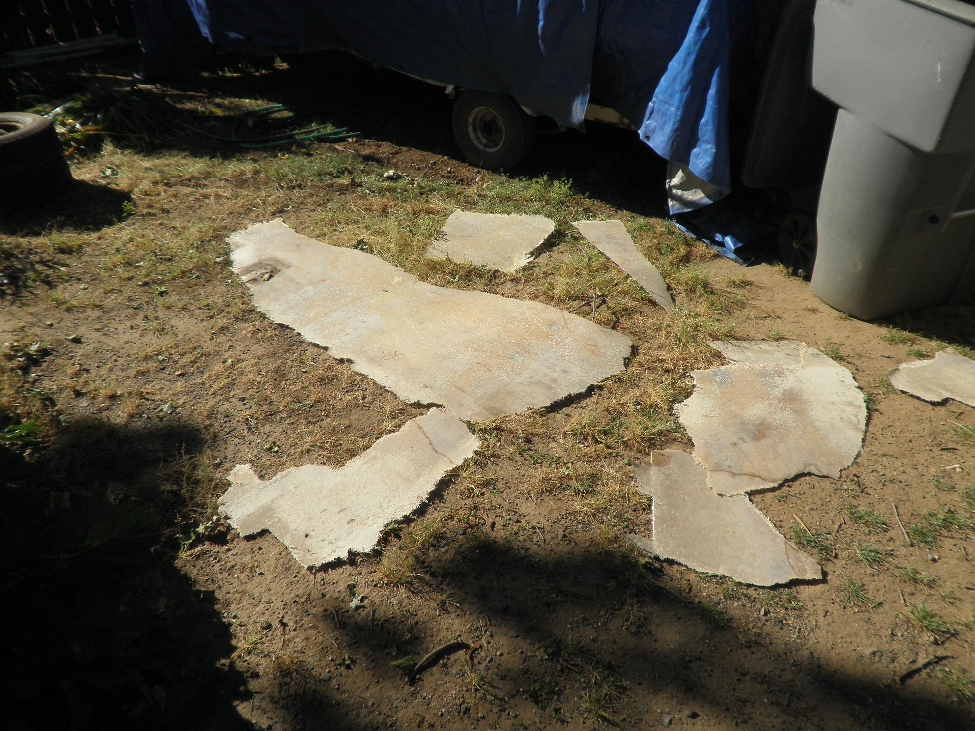

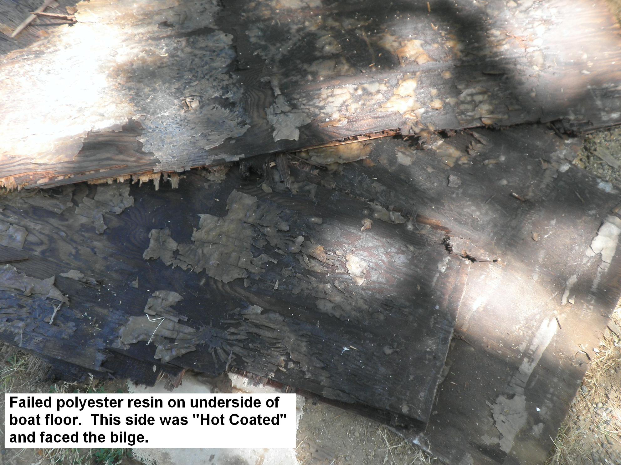

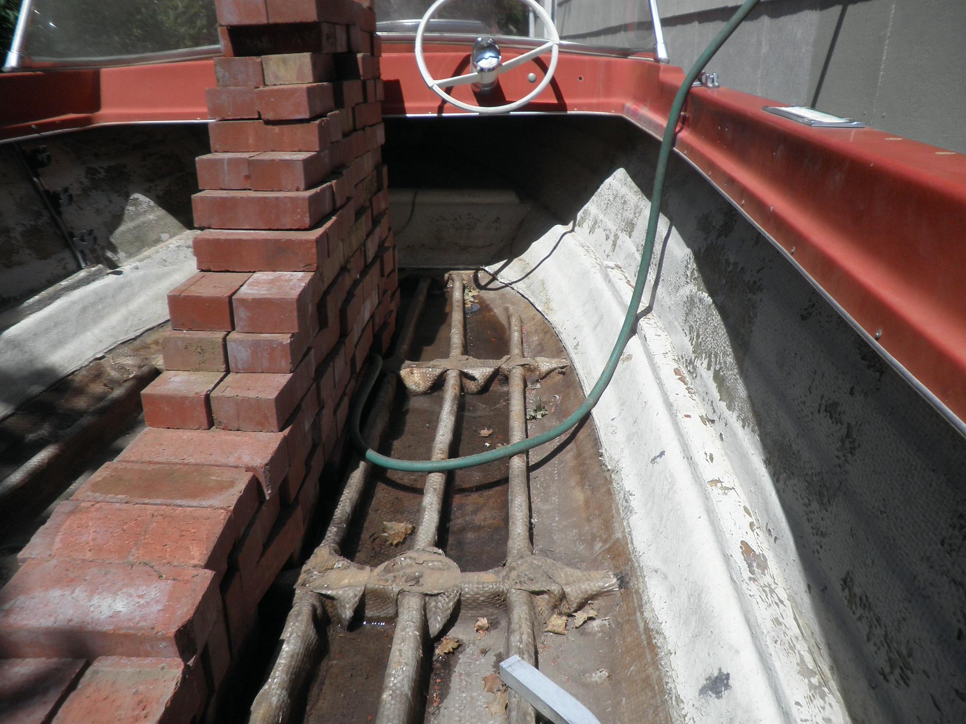

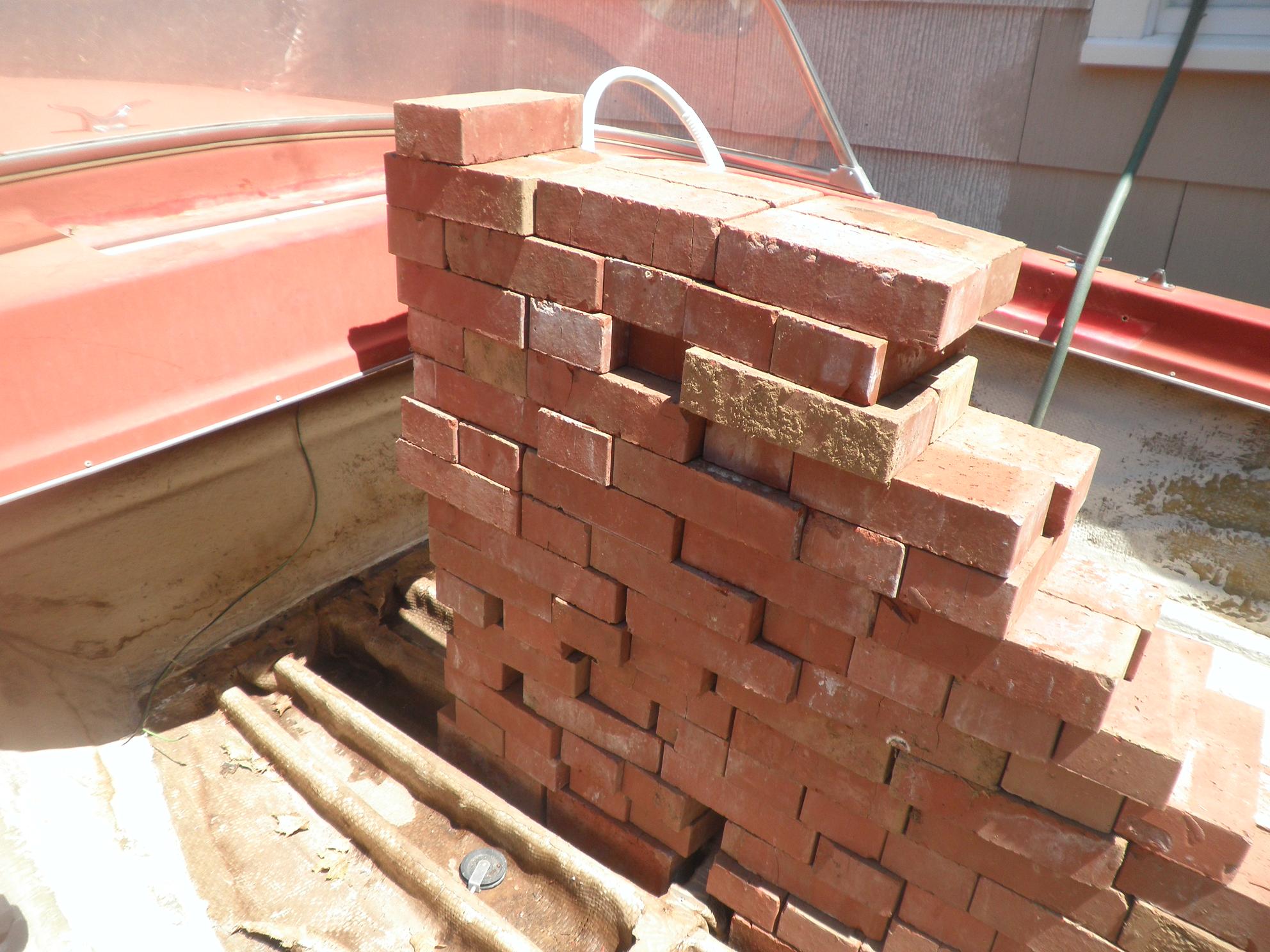

I did some more cleaning & poking around the boat structure. This boat used a cheapo fiberglass stringer arrangement that actually worked very well for a long time. The builder (who I beleive was Span America) made a stringer grid out of 1"X1" fir. They tabbed this to the hull with little strips of CSM. Then they simply draped a layer of roving over the grid & wetted it out with poly. That was it for the stringers! While that may sound horrible - it's actually good enough for most boats. Even though the stringers are very thin, the resin makes them rigid, and the plywood floor disperses the pressure across a very large area. The 1"X1" wood only served as a form to drape the fiberglass over. Those little sticks have pretty much rotted away - but it doesn't matter - because the fiberglass is what makes the structure. Because of water intrusion over many decades, a lot of the polyester washed off, or fell off the roving. Most people don't realize that polyester is water soluable - but it is. It takes a very long time - but water will eat away at the stuff. Since the flooring was only 3/8" thick, the stringer grid probably moved a lot. As the floor plywood started to fail, the problem only got worse. There were rollers on the keel that put a pronounced hook in the bottom. A "hook" is a dented in area of a boat bottom. It is VERY bad news to have a hooked boat. I put a straight edge along the keel and used a sharpie to mark the worst hooks in the bottom. Then I got in the boat & laid the straight edge across the stringer tops. The center stringers were no less than 1/8" higher than the other flanking stringers. In short - this hull was no good unless the hook could be repaired. With little to loose, I decided to try a trick that I have used to fix hooked boats before. Laugh if you want - you probably will - but the "fix" worked!

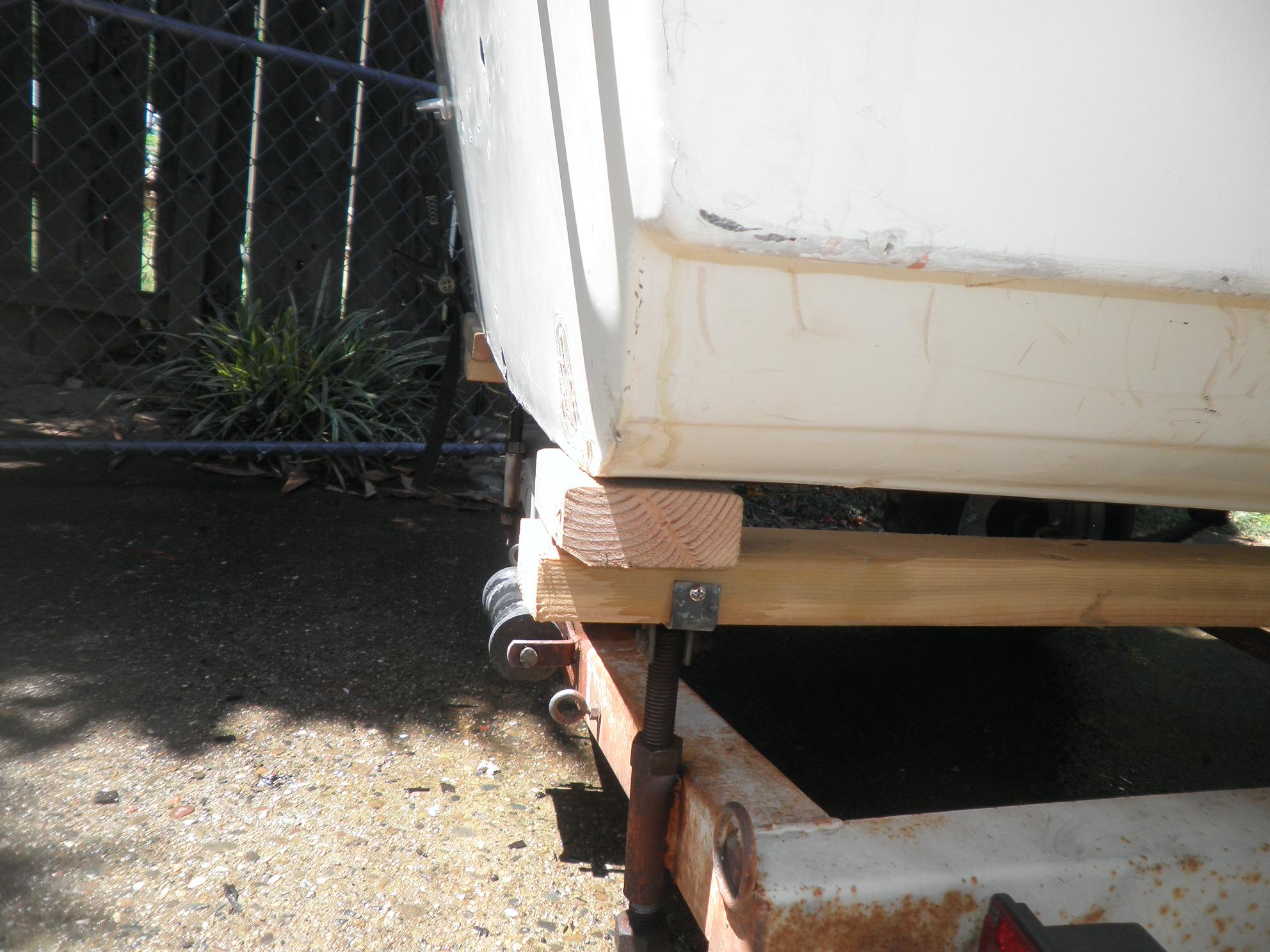

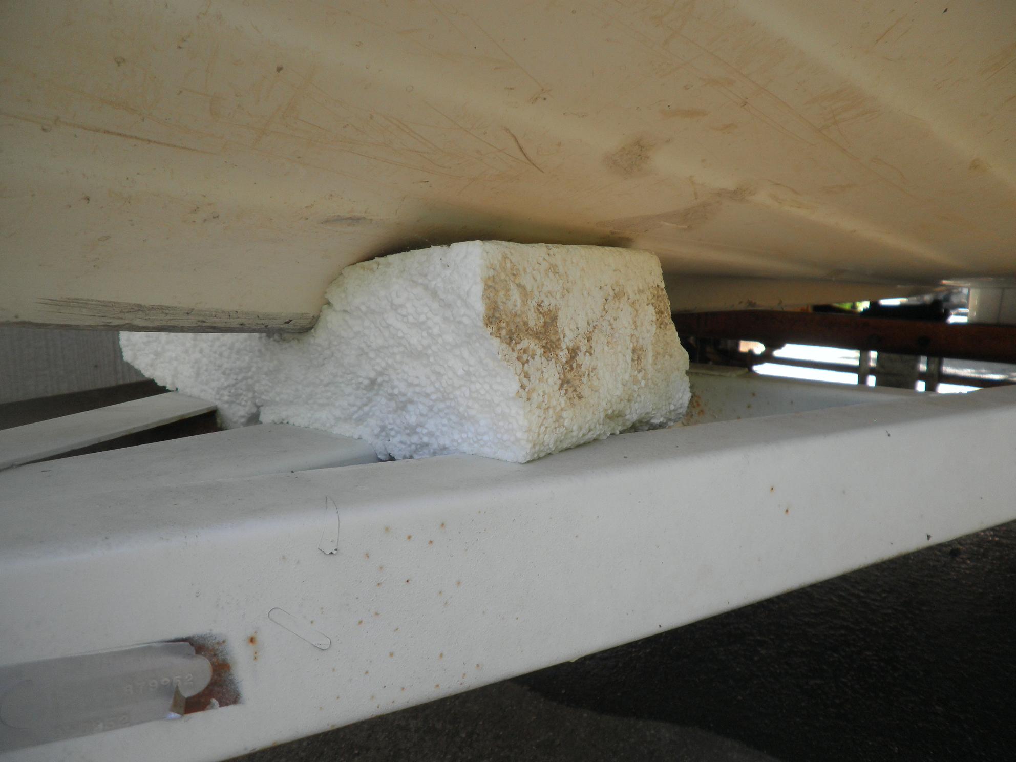

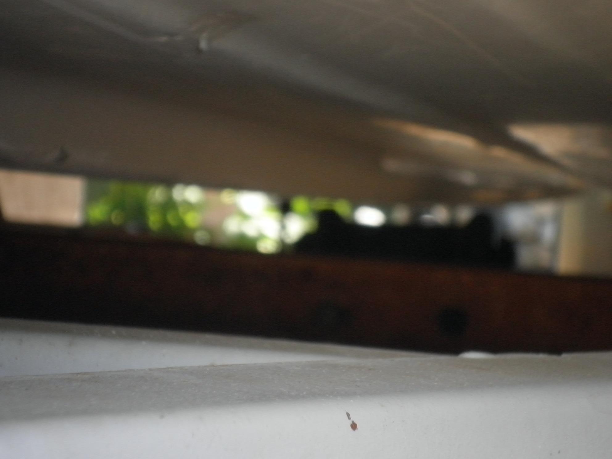

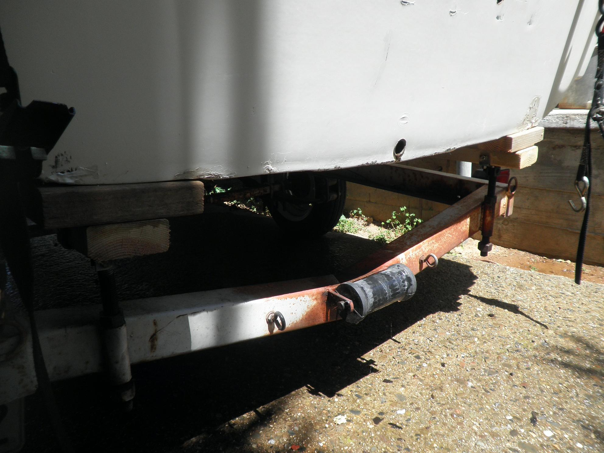

Here is the way I did it - the trick is to suspend the boat on the trailer - so the bottom is hanging by the edges - like a trampoline. I do this by suspending the boat in 3 places. I use a large block of styrofoam under the prow, and 2 small blocks of lumber under the heel of the transom. The hull at the prow and the heel is very thick and rigid. The points are perfect for taking all the pressure of the hull weight, because they will not deflect. This then allows the belly of the boat to relax. I then stacked about 900lbs of bricks along the center 3 stringers to push out the hook in the bottom. Here is the craziest part - I cranked up my house hot water heater to 170 degrees F & waited a few hours for it to get the water insanely hot. (hope I didn't shorten the life of my hot water heater!!) I then sent the hot water directly from the tank to the bilge of the boat. It was 80 degrees outside & the water still was still producing steam 1 hour later! The water was hot enough to soften the glass and allow the hook in the boat to be reversed. The bricks were used to keep the hull "pressed out" after the water cooled. I purposely "over bent" the boat, meaning that I pushed the hook out farther than needed, because I speculated that after the water was drained & the brickes removed, the hull would tent to "return" to the hooked shape. Well, after sitting for 3 days with the bricks removed, I'm pleased to report that the keel is completely straight and the hook is completely gone from the hull. The center 3 stringers are now 1/8" below the flanking stringers. I will apply a fresh coat of polyester resin to the roving, and once that is cured - I will lay down the new floor. The floor will be attached to the stringers with 3M 5200 and no fasteners of any sort. I'm sing 3/4" MDO single sided plywood. The paper side will be toward the bilge - it will last nearly forever. The raw wood face of the plywood floor will be glassed just like the conventional way. Contrary what I have ever read or been told - I don't believe that hot coating or glassing the bottom side of plywood flooring works. It makes the wood rot. Use the paper side of MDO plywood toward the bilge. It will last better than any other wood product. This is my opinion, but it is based on what I have observed over & over. MDO has need around for over 50 years and it's excellent material. Builders didn't use it, because of the expense.
The hook will likely not return to the boat, because the floor will be rigidly attached to all of the stringer tops - preventing any future "crowning" of the floor
Bruce
Re:$100 Dollar Boat 13 years 1 month ago #61818
So the day wasn't a total loss from the looks of it. I like how you managed to get the hook out of the hull with the hot water and wieght. I tryed something the same afew yrs back with pretty good results. The hook should not come back as the fiberglass cooled slowly with the water cooling down. It is good to see that the 100 buck boat wasn;t a total loss. Keep up the good work there Bruce. Skip.

i would suggest that you PAINT the "paper side" of the MDO. - MDO is MADE for exterior road & advertizing signs that are constantly exposed to rain/snow/hail/wind/freezing/sun/etc & in all of those situations it is PAINTED, rather than "raw".

Was the hook just in the keel ? or were there rollers supporting the hull too, to create bumps ? Or was the boat on bunks that were adjusted to low ?
Great trick, I'll have to check my "Fiberwreck" for that.

Stax - While I agree about exposure of the MDO as a sign, the main difference in this application is that there won't be sunlight beating the paper to death. The 5200 adheres to the raw paper extremely well. I restored a 1959 Skagit that had blocks of untreated MDO glassed to the bottom side of the plywood floor - where the seats were screwed into the floor. The MDO was the only wood in the boat that wasn't rotted. Since this is not a "forever" restoration - it think the untreated face will outlive the rest of this thing.
Chuck - the hook was in the keel and the bottom - most of them are that way. The rollers on the trailer were higher than the bunks - so the boat sagged around the roller. I'm using a different trailer - the original one is still sitting out in the Desert, Ha Ha!!
Re:$100 Dollar Boat 13 years 1 month ago #61829
I repaired my keel in a similar fashion. There was no support under the transom and it developed a hook over the years. My keel was internally wood. I put the support under the stern and bow and filled it with water and let it soak. After a week or so it went back where it should have been. I then took the water out and put a fan blowing into the boat until it was dry. It was in the cold months and in my garage. It is still doing well after about 10 years.

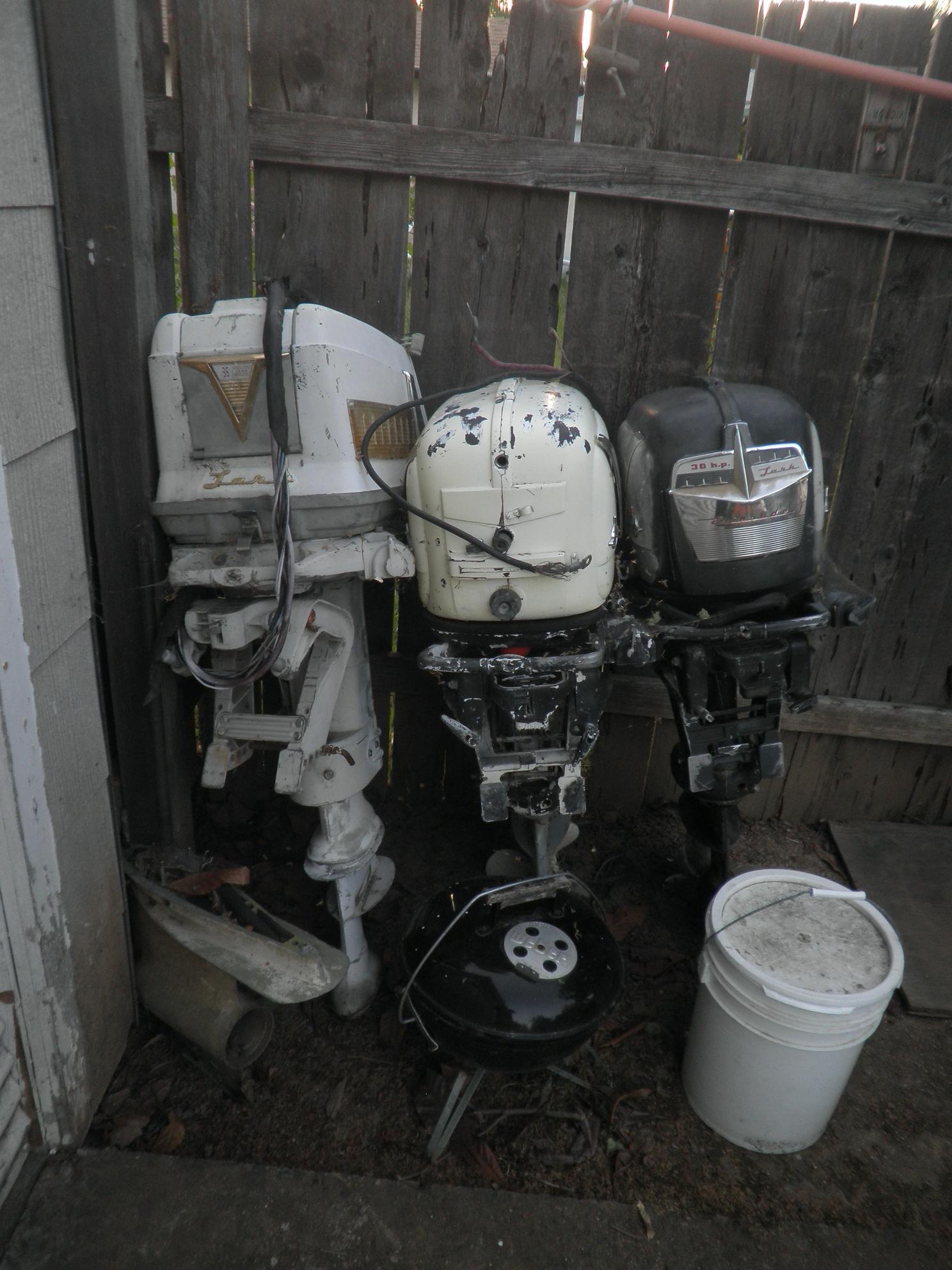

Yes but I will bet the motor is free though isn't it? Well maybe a few bucks for spark plugs, gas n oil, carb kit, float, gaskets, gear oil and the original cost of the motor so it should be free right? Just a couple bucks?
Re:$100 Dollar Boat 13 years 1 month ago #61883

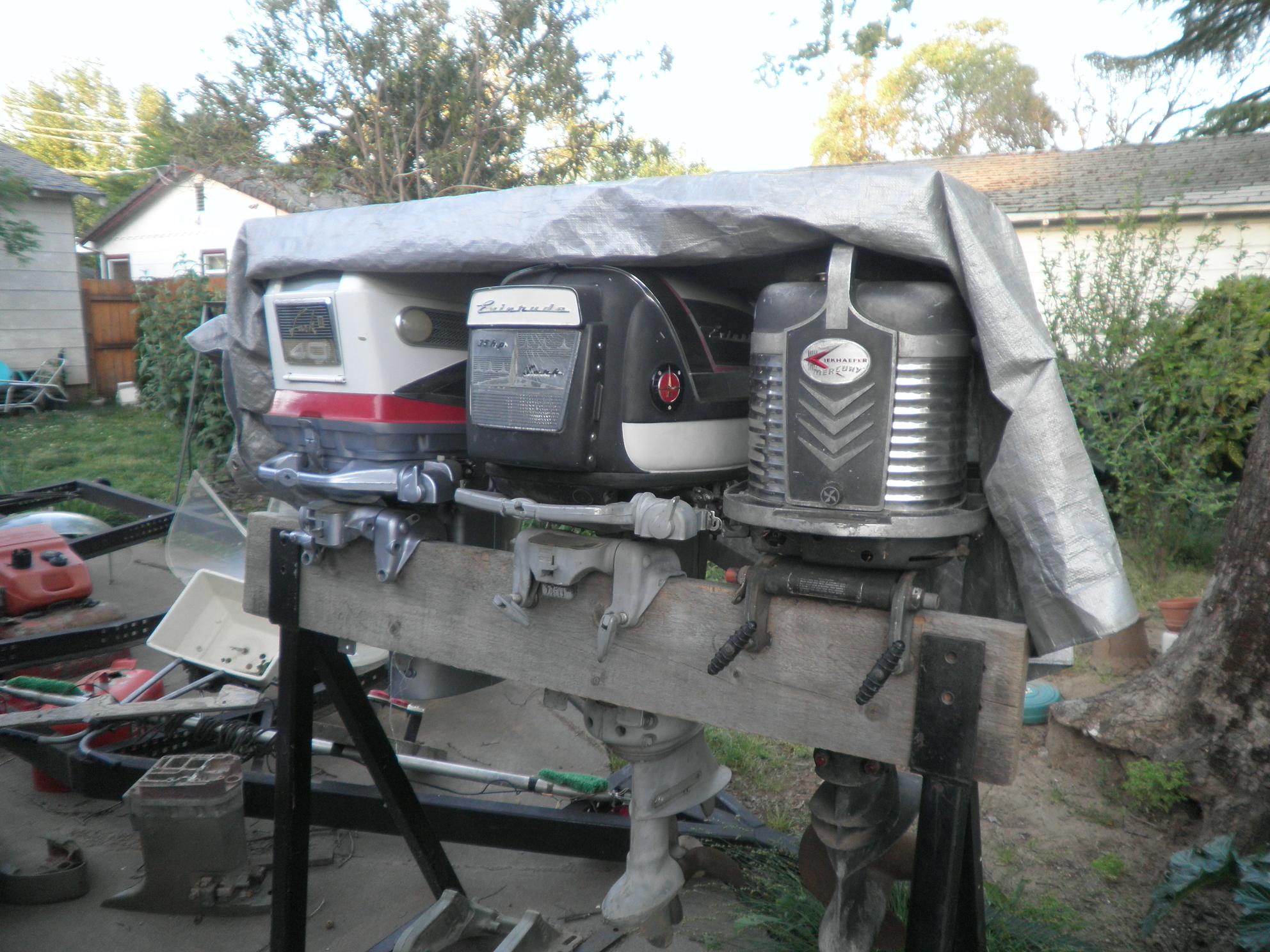

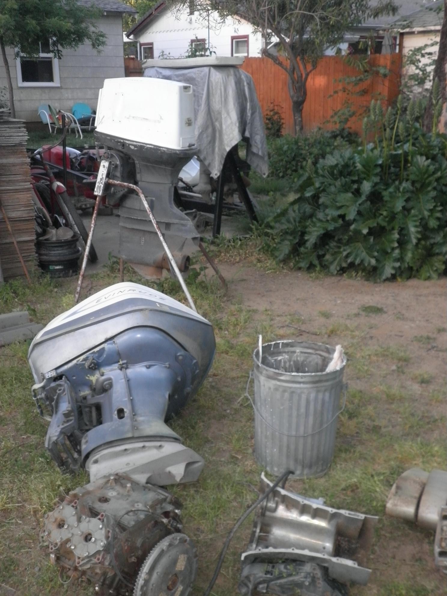

Ha Ha Jim - if it were a normal everyday "sane" person doing this boat, then the motor would certainly be a substantial issue. However, I'm abnormal, and I happen to have a couple motors sitting around the back 40. As ashamed as I am to admit that I have all this crap - some of it is actually good stuff. Most of the engines in these photos do run. The pile of junk motors can provide needed parts - before they go to the scrap yard. And YES many are being taken in for scrap very soon. Have been in the slow process of cleaning up this mess for a couple weeks now. PS anybody need a nice vintage bathroom sink?

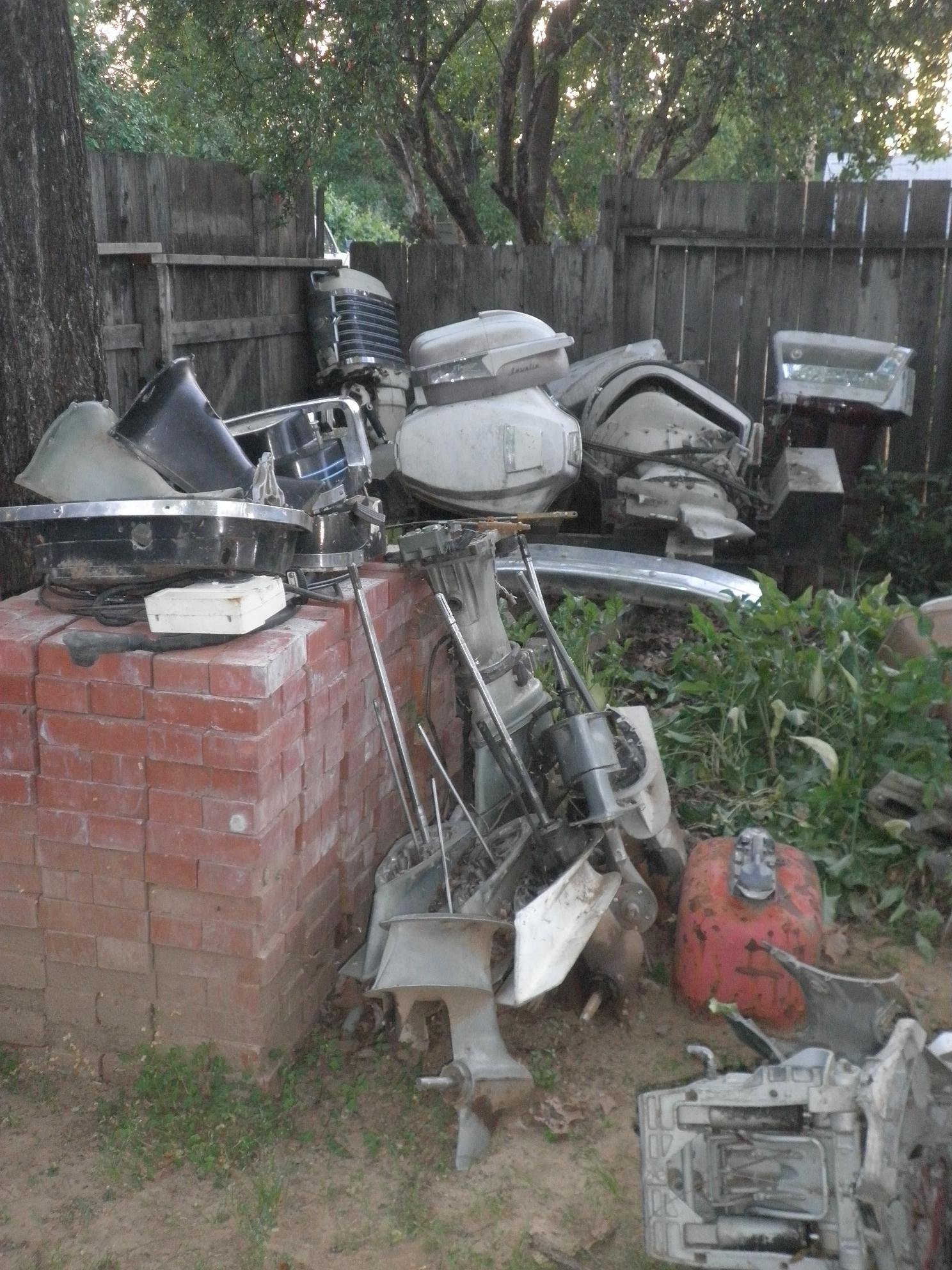

Oh Boy, lets go back to the pics of your yard ornaments! I see all kinds of things I could use more of. Scrap all of that and your yard will look just like millions of other yards. How boring is that?
