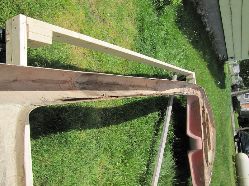

This may be basic, but I will ask it anyway. Behind the inside portion of the deck, there was a 2" strip of 3/8" plywood. Was is the operative word, because it has rotted and needs to be replaced. It appears that the plywood had been adhered to the deck piece and that a fiberglass flap had been used to hold it in place. My plan is to glue and clamp the new plywood to the glass. I was planning on using a two part epoxy. Is that the right stuff or is there something better?

Here's what I did/am doing. I used 3/8" microlam maple-faced plywood (bought from a company going out of business years ago). Adhered it with a straight epoxy. It seems to be adhering fine. I will coat the exposed wood with epoxy, probably with lime mixed in, to seal everything. Before that, I am going to verify the amount of lip that I allowed is adequate and trim out any extra with my Multimaster. I think I'll be good with that.
There's a pic on my projects page.
