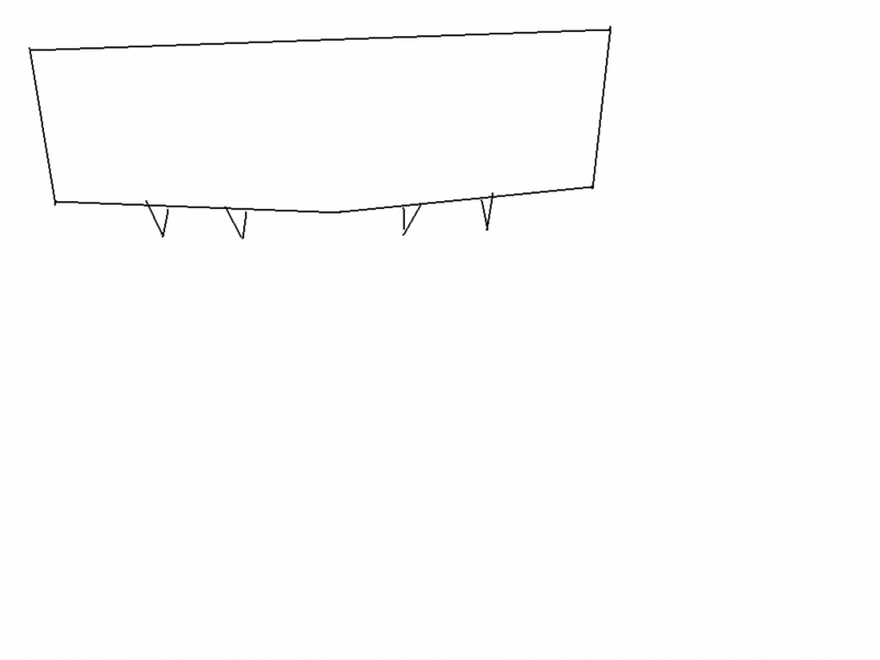

Re:Glasspar del Mar "sliding?" 13 years 9 months ago #61383
My 1957 Endura Craft does the same. it turns great up to 23 mph after that it slides out on truns. I have been thlnking of taking 2 2x2x4 and split them at a 45 and this would make 4 peices. Now I was going to put 2 or each side of the keel about 8ins apart. And was hoping this would stop the sliding out in truns.
Mike aka the pirate
PS
I have had 35 to 75hp motors and its the same on truns
This is a ruff idea of what I mean.

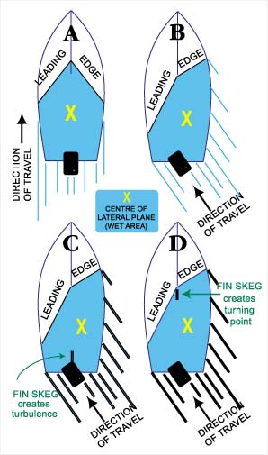

I've been giving this a bit of thought.
Consider a flat bottomed outboard boat, on the plane, going straight ahead. The wetted surface area is symmetrical and all forces are balanced, the boat happily goes where it is pushed. See “A” on the drawing.
Now consider this same flat bottom boat with the motor swung to make a right turn (“B”), consider the activity in relation to the motor: the prop/rudder is (effectively always) going forward, and the planing surface now has a new leading edge (which is the left chine) and the wetted surface is a strange non-symmetrical shape. The left chine is lifting slightly, (making the boat bank). In fact, relative to the prop/rudder the boat is still travelling ahead, but certain forces and shapes create resistance and the hull ‘fights’ the water’s resistance. Now, where to place a skeg?
A skeg close to the rudder will add considerable resistance (and probably contribute air the prop (C”), whereas if placed further forward it will create a turning point (“D”).
With accurate plans the position of the forward fin skeg could probably be calculated if the initial turning wet area was accurately known (but don't ask me to do it).
Ken.

Re:Glasspar del Mar "sliding?" 13 years 8 months ago #61726
  • Nautilus
  • Posts: 1580
  • Karma: 87
  • Thank you received: 58
Damed good feedback, Downunder. Now THAT makes sense to me. It would seem that the only variables left would be the length and depth of the skeg, which I suspect could only be determined by trial and error. For that reason, my idea of a removable (and replaceable) skeg could come in handy.

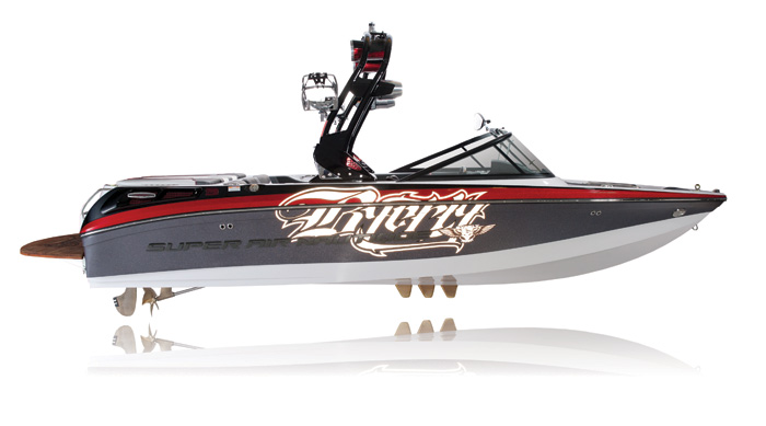

Re:Glasspar del Mar "sliding?" 13 years 8 months ago #61771
  • ed-mc
  • Posts: 1461
  • Karma: 235
  • Thank you received: 128
Just look at the Jillions of tournament ski boats out there with "skegs" "turning fins" "tracking fins", whatever you'd like to call them.
Here's a good example:
