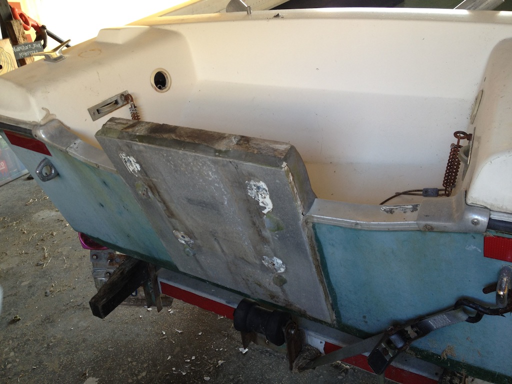

A close visual inspection of the hull will usually show any "patched" areas, it's hard to get them perfect. You can walk around inside on the floor, check for "soft spots" where the floor (sole) gives or feels "spongey" under your feet. To check the transom wood for rot there are a couple ways. You can wrap on the outside with the handle of a screwdriver, good wood will "sound solid" or "ring back". Rotted wood will be a dull thud. (Do it around in different spots, you'll notice a difference in rotted areas.) Also check bolt and screw holes for the color. Black or darkened wood indicates the presence of rot, good wood will be a brighter color. Some folks even drill small holes in the transom (from the inside) to check the color of the shavings that come out.

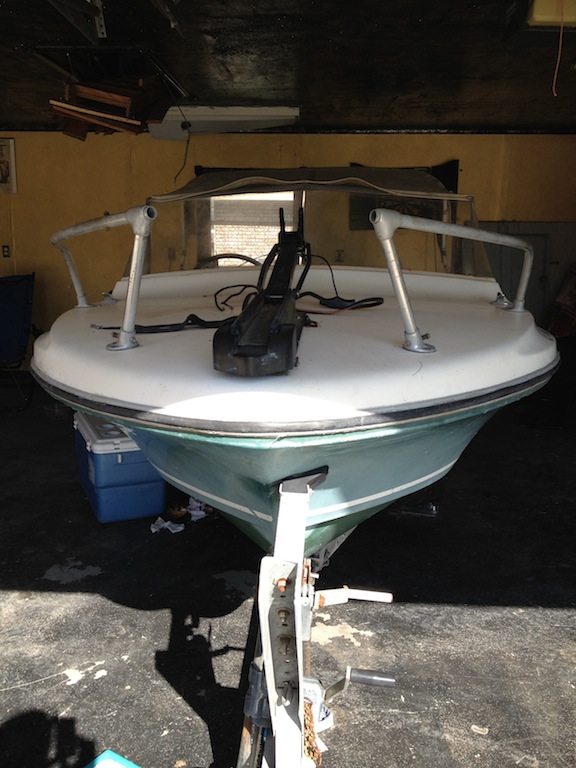

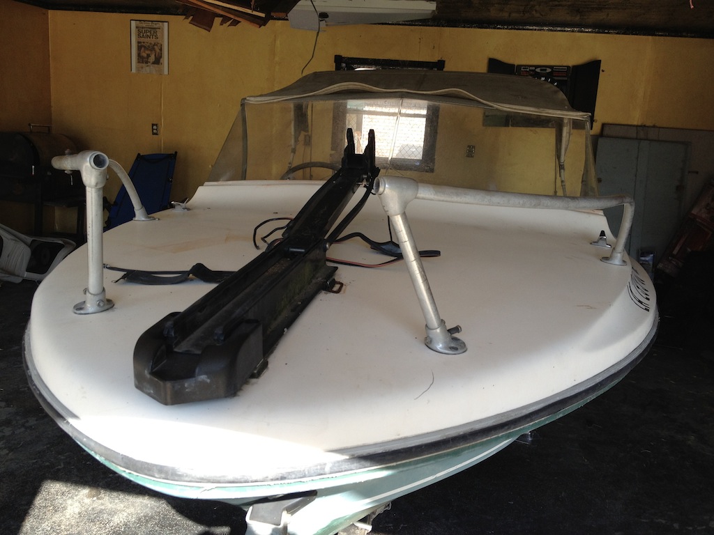

It looks to me like someone modified that transom to accept a long shaft (20" ?) outboard, when it was originally designed for a short shaft (15"). IMO that would probably indicate the need for a total transom rebuild, I don't think I'd trust the craftsmanship there. The trolling motor mount on the bow, and the hand rail being chopped up (probably added after the boat was built anyway ?) are also things that would need to be addressed, they definitely distract from the appearance of the boat, IMHO.
