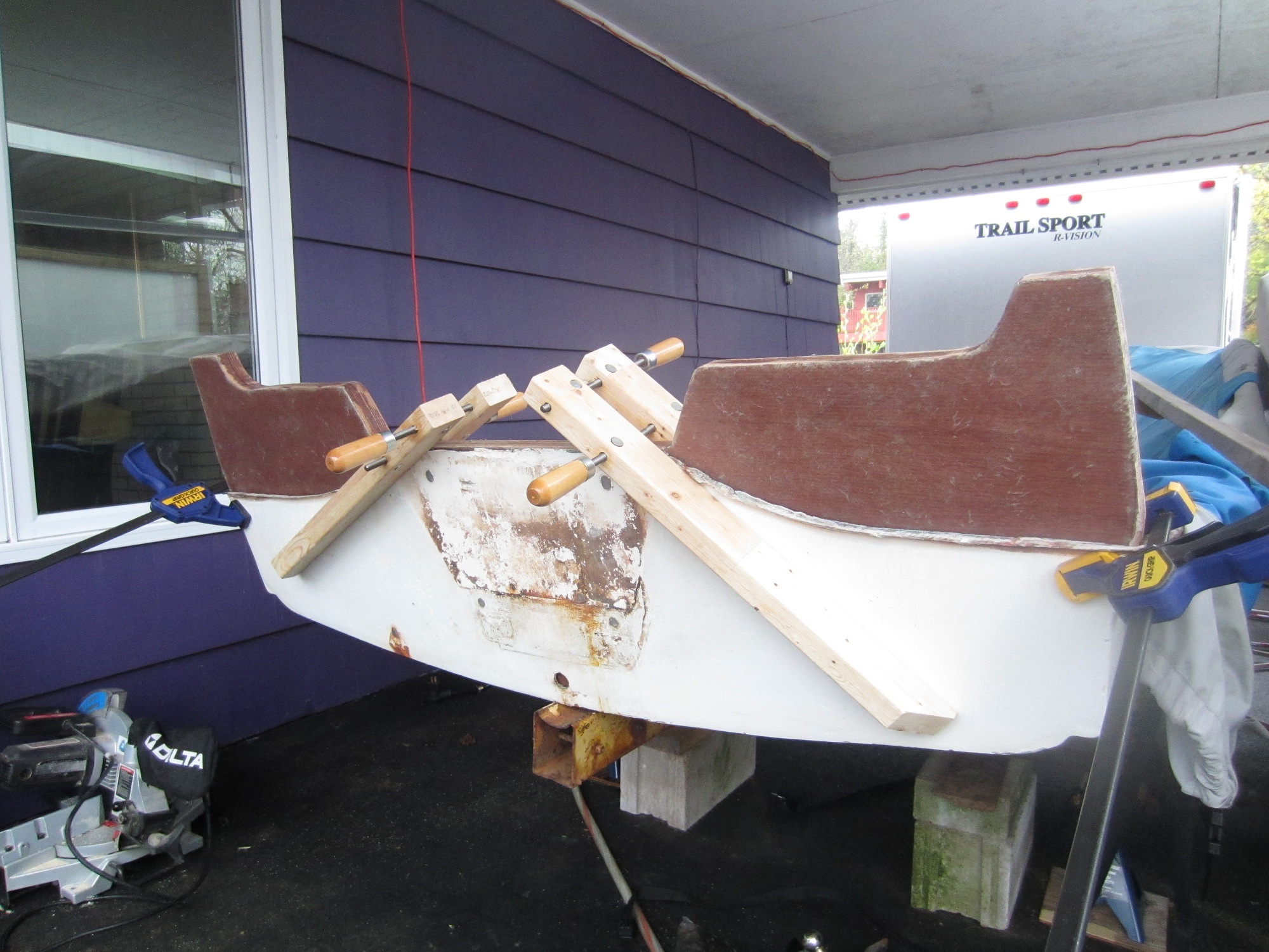

Back from 8 weeks at sea and now getting to the installation phase of the new transom for my RF Capri. Here it is in the "dry run". Tomorrow I will pick up the fresh resin and glass it in. Still need to pick up a few more clamps also.

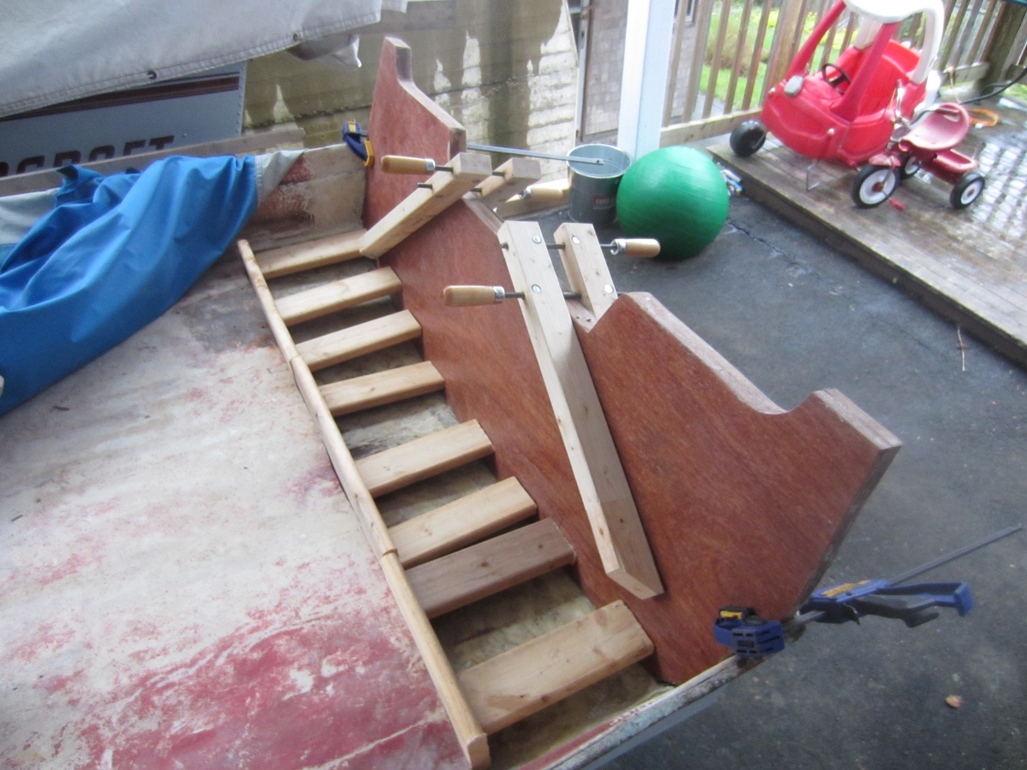

inside with blocking

The old transom was water logged but still in one piece. I was fortunate that I could just trace it onto the new marine plywood.
I will do a tracing for you too. Just pm me your address and I will send it out to you. No charge of course. I still have the original transom and I plan to mount it as``art`` someday in my workshop.

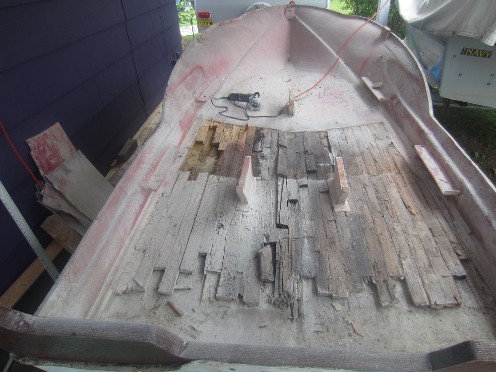

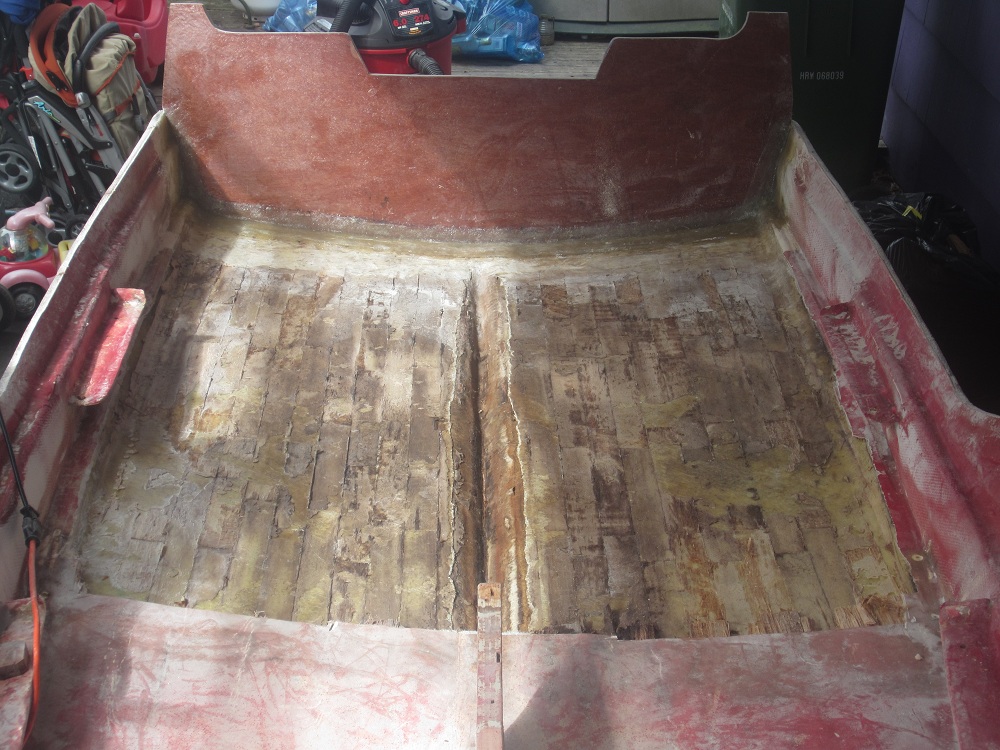

Started on the fun stuff this afternoon. Removed at least 80lbs of wet and rotted balsa. It is really amazing how thin the skin of the hull really is with the floor removed.

I don't envy you one bit... I HATE working with cored construction like that! Just make sure you keep everything well supported- Those thin hulls like to warp and twist all over when the core is out of them. Ask me how I know :(

Thanks guys. It is sitting on the '59 Tee Nee that I am simultaneously restoring. That is enough support right? I also have a cargo strap tightened around amidships so that the hull does not flare out.
