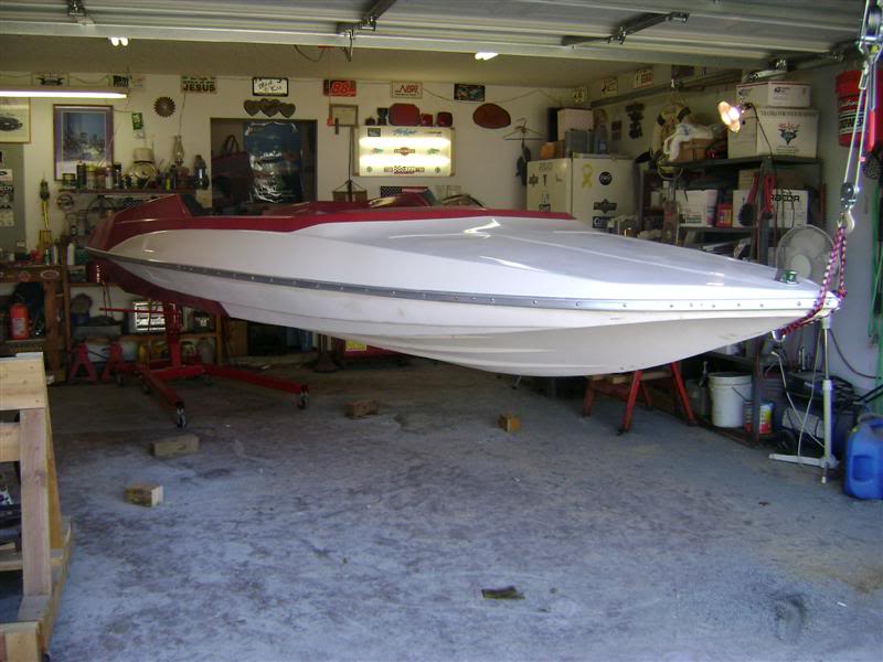

I remember the post you're talking about Wentworth, just having trouble finding it. In the meantime, here's one Andrew posted last year with something similar;
www.fiberglassics.com/glassic-forums/2-main-forum/50701-what-santa-needs-to-bring-me-for-christmas.html#50701

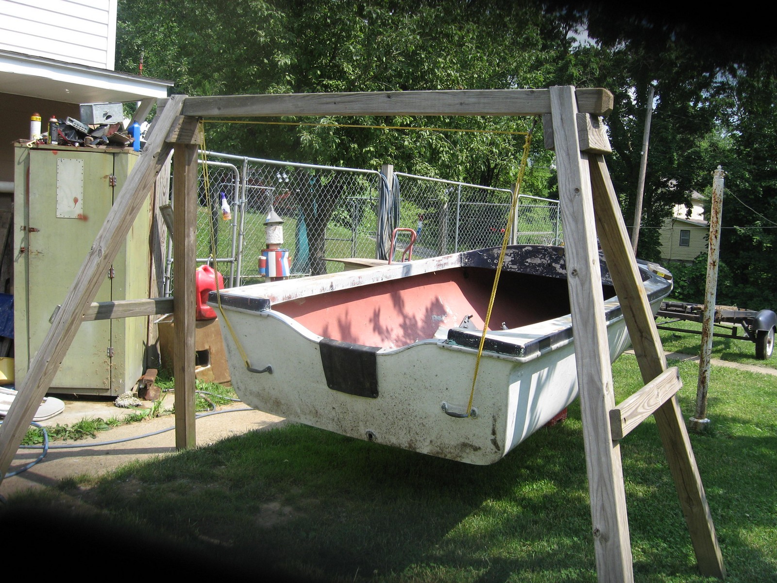

Re:How to suspend boat? 13 years 3 months ago #61033
Just a few weeks ago I used a wooden swing A frame to lift the bow off the rollers and let the boat slide off the trailer very slowly by pulling it with my 4 wheeler and pushing it a little. I needed to do some repair work on the keel area where I hit the gravel on beaching. I had put shoo goo in the hole years ago as a temporary repair. Yes it is still there. I put a aluminum keel protector on that I made. To put it back on I lifted the bow up further and lifted the trailer tongue high and wheeled it under the boat then attached my winch line and just cranked her back on.

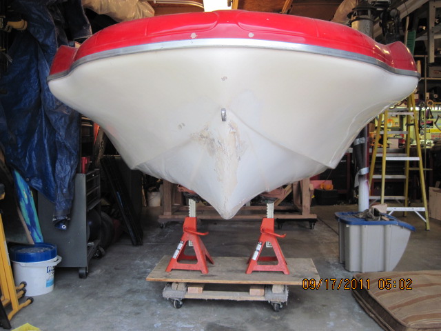

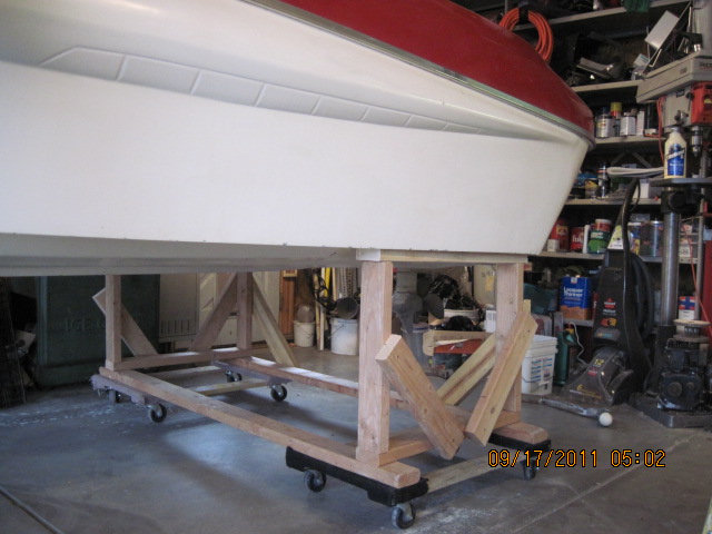

Re:How to suspend boat? 13 years 3 months ago #61081
This set up worked ghreat for me , and was cheap to put together !!
In the last photo the jack stands in nested in the chines,they werent going anywhere !!
