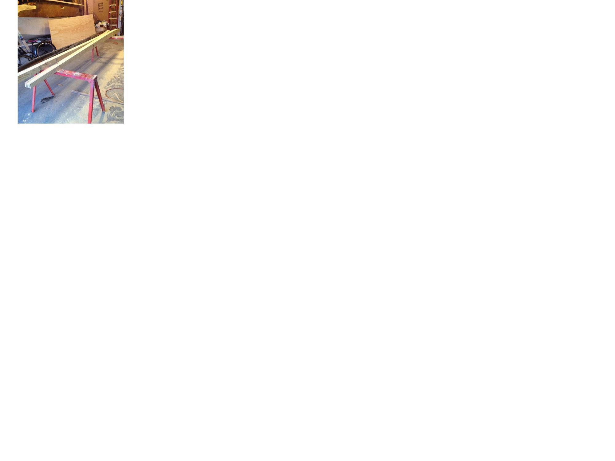

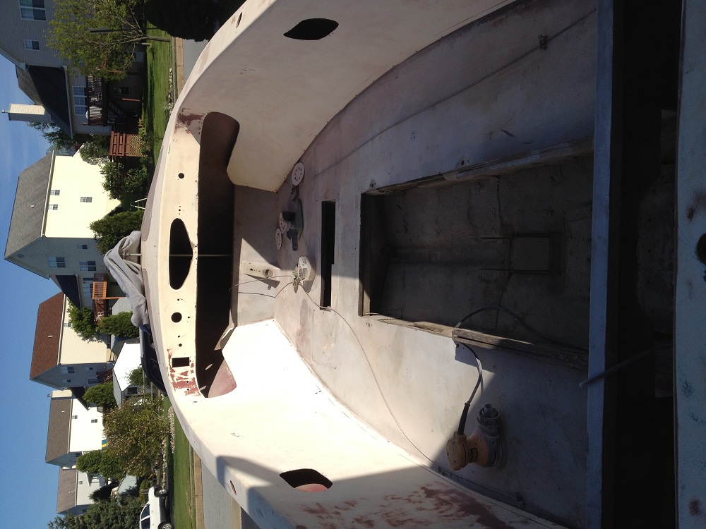

I wanted to share some pics and info from my ongoing project in restoring the 59'
Re:59 Turbocraft Restore 13 years 9 months ago #60899

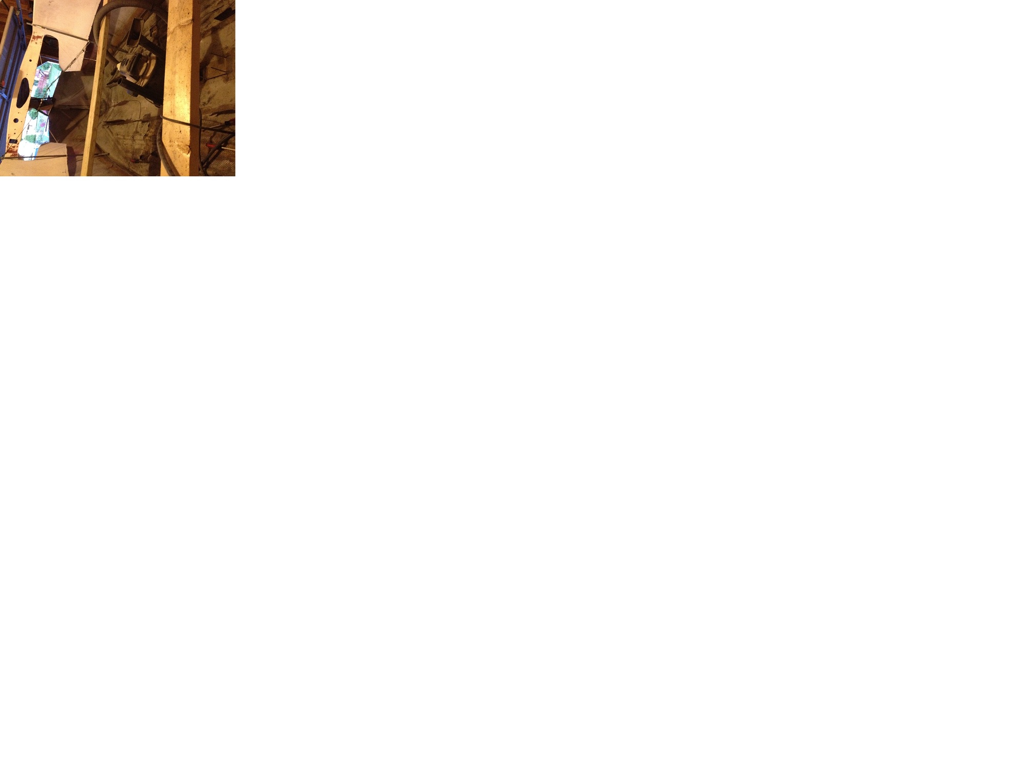

Another Pic. Prior to splitting the hull and Deck.

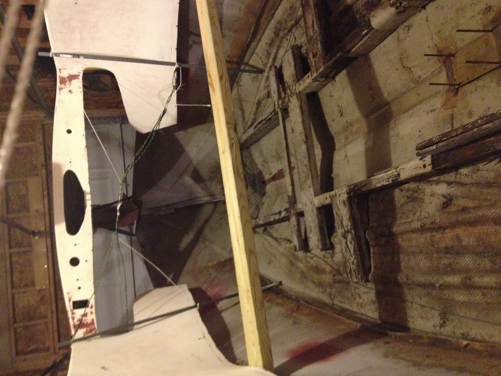

Re:59 Turbocraft Restore 13 years 8 months ago #61808
Buehler with the floor and wood framing removed, some parts were rotted through pretty badly. Ill be replacing the parts as they were originaly. I will add a bit more fiberglass to help reinforce everything, but not effect the weight much more.
