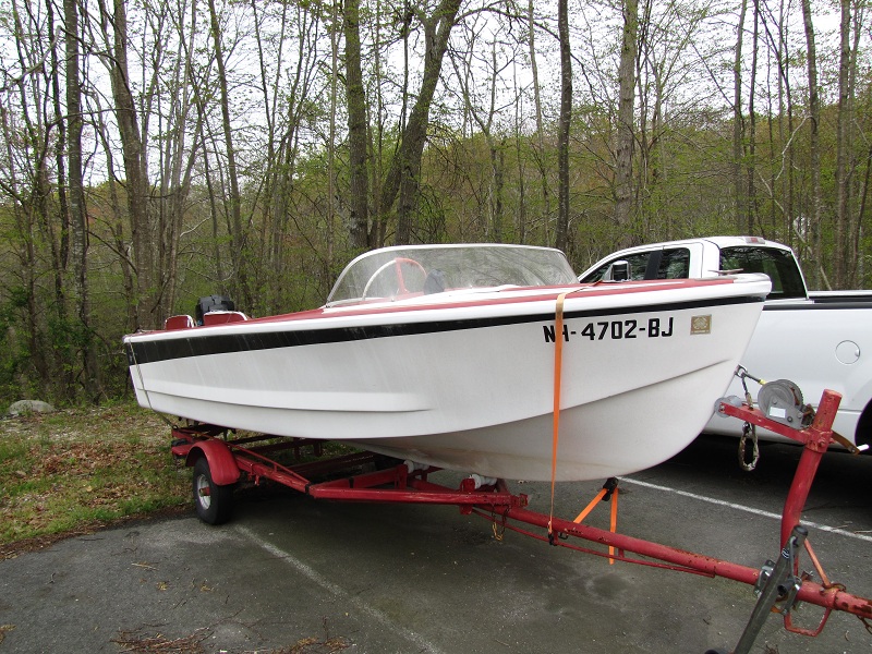

Interesting. There is what I think is a 59 Trident parked in the lot by my local fiberglass supply shop. It actually looks in decent shape. This has the seating option with the rear seats running parallel to the centerline (see brochure). The front and one of the rear seats have been removed and replaced, but there is one original rear seat still intact. If you want, I can go get a picture.
When it comes to deck hardware like horns, there was no standard placement for the most part. Just look at some pics and get an idea of where they typically are.
Love the low profile windshield. Not sure how practical, but it does give a nice look.
Todd (aka thetudor)

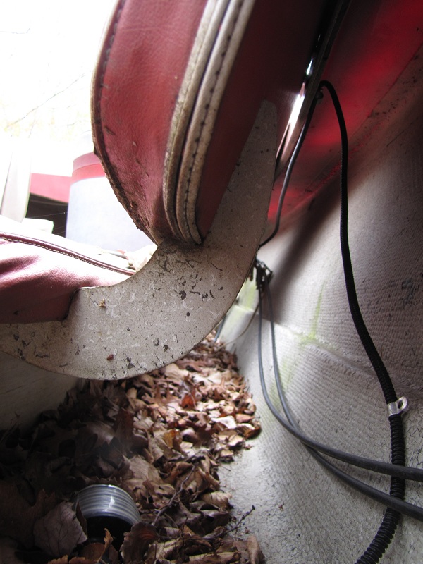

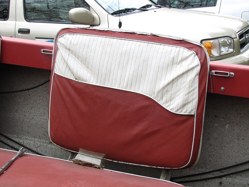

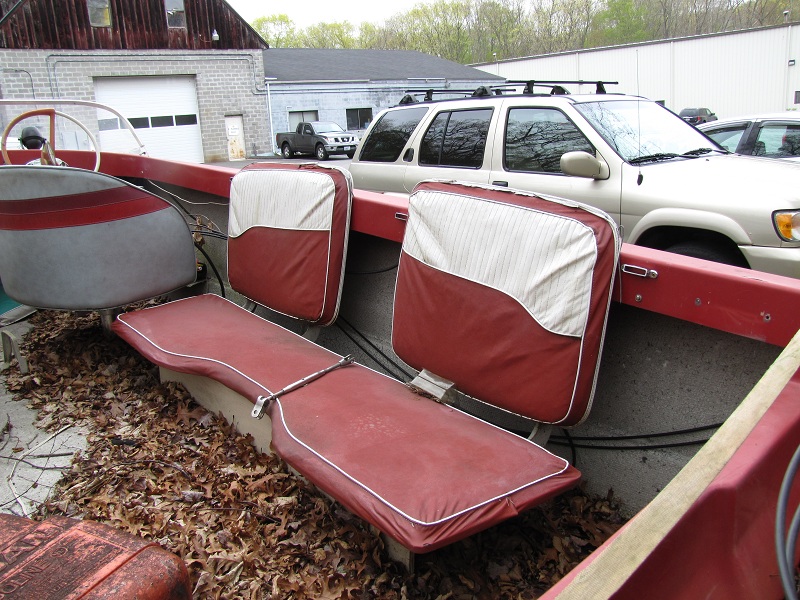

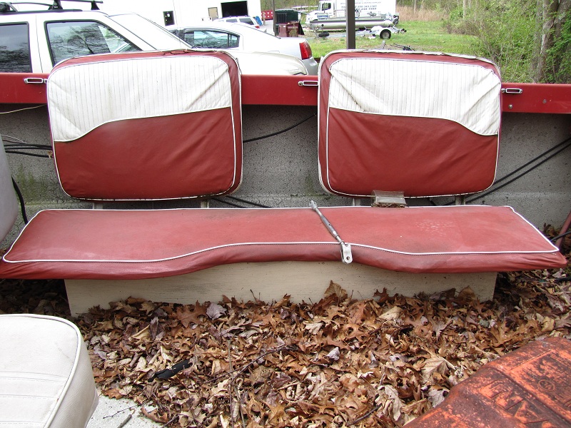

It took me a little time to put this together, but here are photos of the original seats in the Trident near me. The support is the typical plywood frame, but it doesn't look like the enclosed box. The ends are at least partially open. Couldn't really see.
Todd (aka thetudor)
1964 Custom Craft Aqua Ray
1959 Glastron Seaflite
1959 Tomahawk Spirit

Thank you for the pics.
