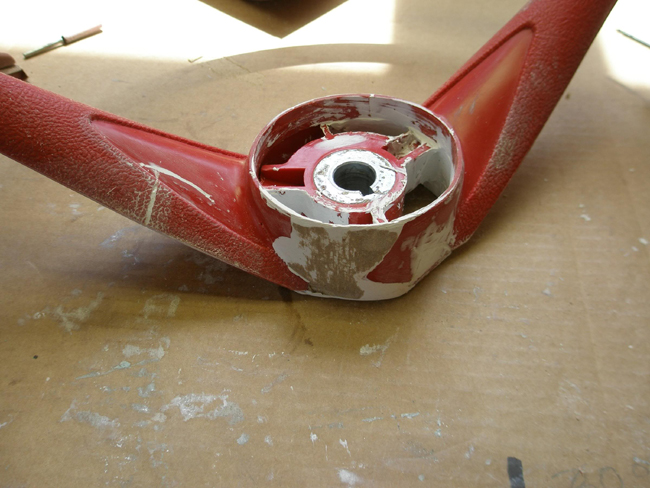

I am in the process of restoring the badly damaged original wheel for my 64 Correct Craft. This pic is kind of over-exposed look close the wheel's hub had pcs missing ..

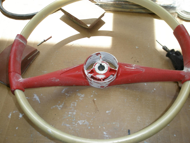

These are pics of the wheel after "rough-in" of the epoxy on the hub and to fill cracks/gaps in the rim...
my question is. Any ideas on how to get the texture in the epoxy repair where the spokes and rim were textured?
