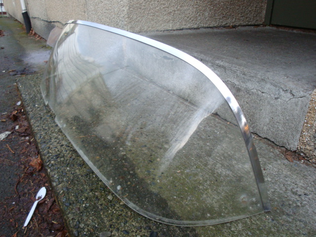

Windshield gone

Short up close video of the windshield. One pretty good crack and a funny spot that im not sure what it is....looks like a bunch of tiny cracks. don't know if it will buff out. I hope it does.

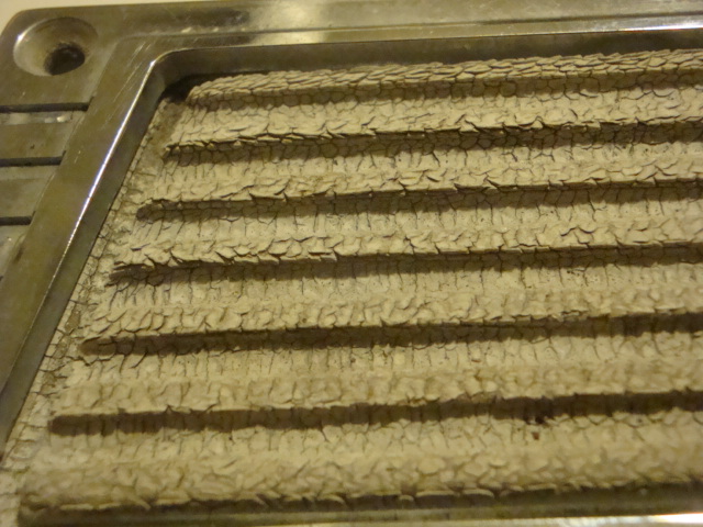

For the step pad frames, I would just polish those babies up and keep using them, especially if you're interested in keeping it stock. You could have them re-chromed, but because they are pot metal, it's very costly. My local chromer wanted $75 a piece.
Yes, there are many step frames on Ebay, but not the trapezoid shaped ones that are on your boat and match your hole pattern. There are lots of rectangular ones that come and go, but strangely, it's usually a pair, not 4.
If refurbishing your white pads doesn't work out, you can check with MadProps. He recently made a mould and produced some new black ones that fit your frame. I don't know how many he made or if he has any more. You can check back through the old thread using the search site.
I have those same frames and just ordered some white ribbed rubber extrusion from Wefco. It was $5 a foot w/ a 10 foot minimum. I'll have extra for sure. If you're interested, I can send you what I have left over (which would be more than enough for your frames) for what I paid for it per foot. Shipping is on me.

I really like the look of the originals. I was also thinking of trying to make the pad myself and have the crosby logo instead of the lines. Wondering if a chunk of ruber tire would work and using a hot knife to cut in the logo and then smooth it out with a torch? Or could i just oder a larger step pad for a lager boat and cut that down to fit? just some thoughts. Here is a pic of the pads ......haven't used any of the 3m stuff yet. Looks pretty bad huh? Also, how can i post more than one pic at a time?

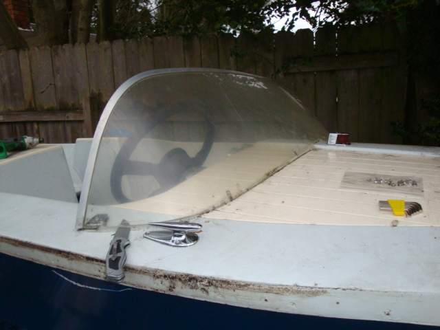

Buffed up the windshield today. Nothing to indepth but it did wonders...trim buffed up nice also.
Re:1960 crosby questions. 13 years 10 months ago #58736
  • Thank you received: 5
Your windshield looks good, nice work! You can post multiple pics by posting with one, then hit the edit button. Add another and post again, hit edit and repeat as often as you'd like. ;)

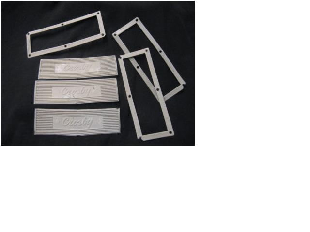

Here's what the pads looked like on the '57 Crosby Capri. These came up on Ebay a while back, but I didn't win them. I wanted them so I could reproduce them.

CLK, the winshield looks great!. The step pads are not my area, but it looks like the center is removable. Ever think of wood? You could replace the existing ones with wood, like teak or jatoba. If you like, I could make you a set and mail them. Are you in a hurry? Wood would look sweet. The outer frames look ok. As far as the rub rail, if you want to keep the boat original, I have been looking on the web for one similar. Also, you can use wood with a rubber insert. Anyway, your project is coming along fine. Once again, is that paint over glass or wood on the top front?

Cool!!! they look almost exactly like i had pictured in my head. think i'm just going to have to make my own cause i really like the shape of the ones i have. My daughters art class my take it on as a project. that would be great!!
