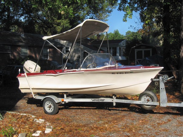

Hey guys, been reading around looking for answers but can't find what I need. I have a stingray project that I have bought and am getting stated on. Does anybody have pictures of the deck (if there is any) of a 61 (I think) stingray ski edition? I am trying to bring it back as original or possible and have nothing but a hill for a floor. It looks like I should be building up a floor, but since I was not alive in 61, I can't quite recall from memory.

Welcome aboard DP, and nice find on the Sting Ray! Don't know if you've seen the Custom Craft section in the FG Library, but there's some pretty good info there;

DP, welcome to the site and world of Custom Crafts. Great boats; have one myself (Aqua Ray). The floors were glass over plywood with foam poured underneath. US Composites is a good resource for that.
In the library, there is a description and picture of the ST-15, which is the ski model. There are also more brochures at nicklecityclassics.com in the gallery section.
Just out of curiosity, under the Custom Craft on the emblum, there is a city listed. Most all of them have Buffalo, but there was a builder in VA for a while that had Virginia on it. What does yours says?

Hello NOrth Carolina, : WELCOME, Great score on nice model .. Has the correct bow deck Light & flag staff. Windshileds are hard to come by... Looks to be even the white pinstripe fabric on the dash
with a speedo ? or tach ..
There is a 61 Tiger ray hull over here in Chattanooga with a member.. maybe on your floor there was some some of removable Lattice wood ,flat grid .?
Post more pics & history story when you can .

Tudor, which emblem are you talking about with the name under it. This boat was actually found in a little marina between williamsburg and richmond, VA
Sunday was a real busy morning for me and my son. He is ten, and my partner on this project. Here is some of the progress.
Thanks for all of the input guys. I am workign on my supply list for jamestown distributors and us composites right now. Hopefully I can get another day off soon to get started. i think teh transom is gonna have to come out, but i am thinking of giving some of the smith system CPES a try first. But you know, when you have it down this far, if you are gonna replace the transom I guess now is the time.
Any input you guys have will be greatly appreciated. My big questions are about the floor, and just reinforcing the fiberglass in several area, and maybe beefing up the transom even a little beyond original. I do have to cut out a small section of floor though. There was literally a small tree growing out at the drawn port. Roots got all up in between the fiberglass and started some wood rot in there
I am planning to take her back to the original light blue top with white inside and bottom. Say a nice mint green adn white ride on nickle city site that I am trying to immitate somewhat.

..D.: The company info city we are curioius about is imprented on the bottom of that WHITE Logo tag saying CUSTOM CRAFT . It is on your dash , also some had two tags on the rear quarters.
Most say BUFFALO " 7 " New York , ( Which was the early fore runner of the US ZIP codes for rest of county ) .
DID you get the company SERIAL # on the transom ALuminum cap .?Was that one foot square cap still with the boat .. Facing inside & STAMPED VERY SMALL Upside DOwn is the year & Model Srial #'s .???
Could be in this format S.R. 7 8 123 61

Nice progress on the boat. Looks like most of the floor is out. I assume you are talking about some hull replacement. Trees growing is boats are never good. When I did the partial floor replacement on my Aqua Ray, I used 4# foam instead of the usual 2#. Gives it a little extra strength. Remember, the foam cures like bread; rises in the middle.
Taking the deck of a CC is way easier that doing it on a Glastron.
