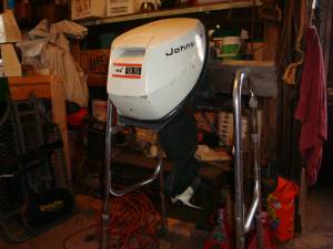

This outboard is on Craigslist here. I got a charge out of the stand. :laugh:

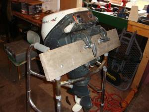

i've been making OB motor stands out of walkers, nuts & bolts & pieces of scrap 2x8 for years. - i get them from garage sales & thrift shops for 5.oo or less.
they will safely hold OB motors up to about 300# & some have wheels so that you can easily roll the motor around.

for 5-6 bucks per OB stand, it's hard to beat & they FOLD for storage or transport, using stainless steel bolts, washers & wingnuts. = i've sold LOTS of them at old OB motor shows for 20.oo each. - a nice little "sideline".
(i buy every one that i see at our local "senior's thrift shop" for 3.99 each & pick up 2x8 scraps at construction sites.)

actually, i've had a Mercury MK 78A on one of my homebrew stands.= at least the ones that i've had, can be extended plenty far for a longshaft OB.

i was told, when Sandra was last in the hospital,that ALL walkers must be capable of supporting at least 400# & that most will support far more than that.
