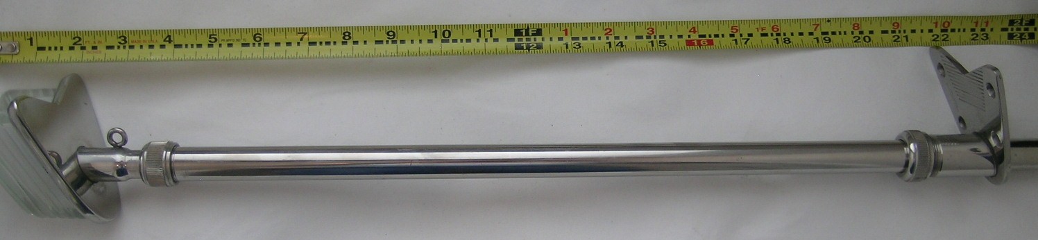

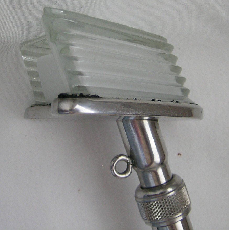

I recently obtained a very nice Vollrath stern light. I need to rewire it, because the wire insulation is all cracked and broken. Can anyone tell me how to get the light off the pole and get to the bulb and wiring? Is it threaded or pressed on? And how do you get the lens off to change the bulb?

i have one of these and the lens is held in by the gasket. be careful prying on it as the base is thin and will come break loose from the pole. then, you will have to weld it. nice find,hard to come by. :)

Glass lens or plastic? If glass, perhaps you can apply some heat to help the gasket material release. You can always fashion another gasket from readily available automotive gasket material or find another means of reattaching the lens.
Re:Vollrath Stern Light Advice, Please 13 years 10 months ago #58142
The lens is plastic, that's why I'm reluctant to apply heat. I'm afraid of applying too much and clouding the lens or using any chemicals to try to help it out. I figured if I do get it out, I can use black or clear silicone to put it back in (if the gasket gets destroyed), but the real trick I see is saving the lens.
