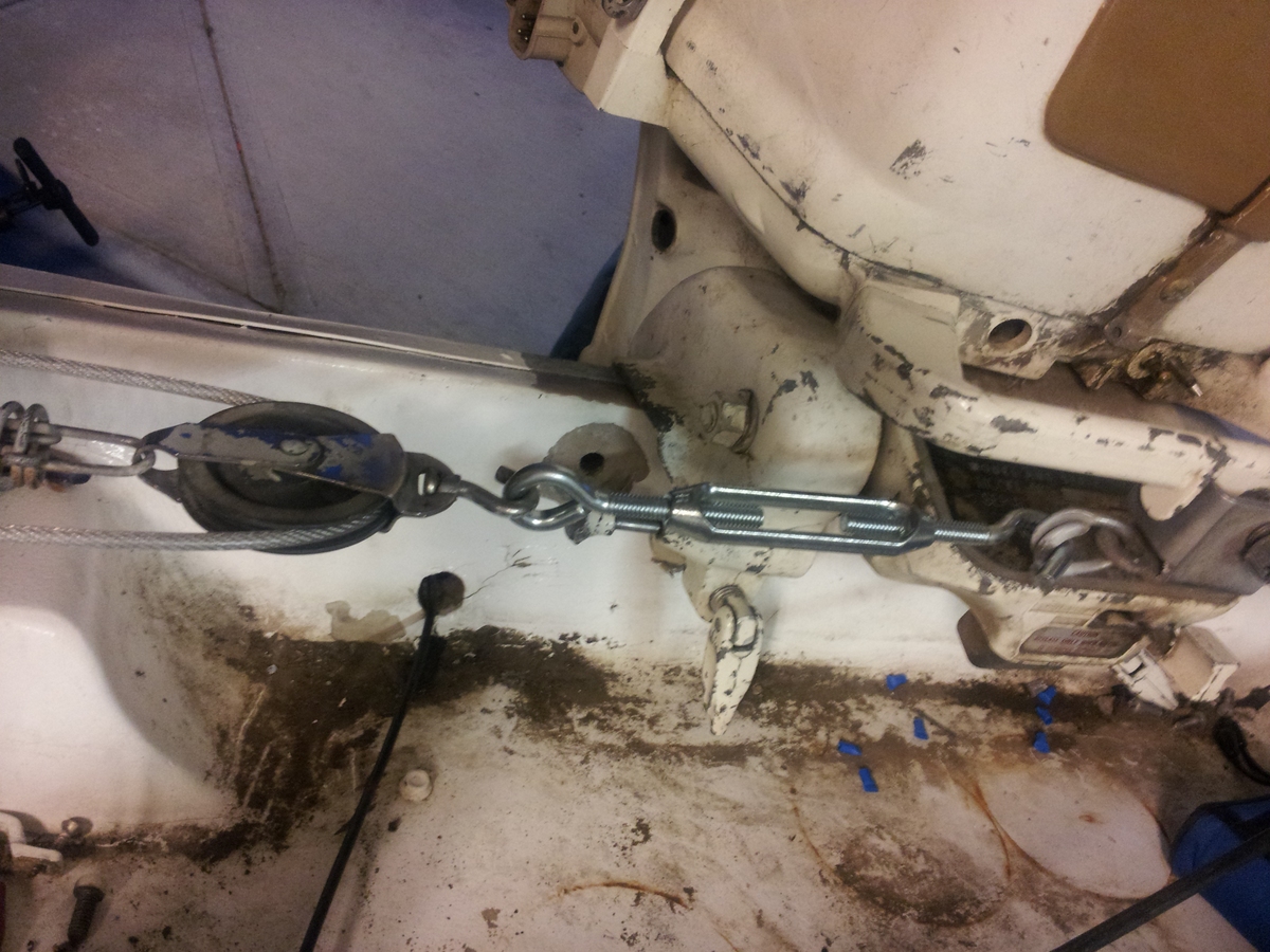

i had an after thought on this. i mocked up my idea with stuff i had laying around the garage, so i know i'd need to button everything up. i just wanted to see if anyone had tried a setup like this:
with the adjustable components on each side, you'd eyeball everything for alignment, and then could fine-tune on the fly until it was perfect and then throw some loctite on the threads. so long as there was room enough that the springs wouldn't hit the pulleys on the sides of the boat when at full turn, i think it'd work... thoughts?

riceman wrote:
i've had some time to try this system out and i wanted to report back on my experiences. first off: REMEMBER THE LOCTITE. or a locknut. or a tack weld. or anything to KEEP THINGS FROM FALLING APART AT WOT. i, of course, would never in a million years ever ever ever forget something like that, so i must only assume that the results of this would be bad.
90 degree turns at WOT all of a sudden and not intentional are not particularly pleasant, IMHO.
second off: this made fine tuning adjustments a piece of cake, and the tensioners don't interfere with the transom bracket of anything. so long as you lock them in place once you're done, i'd give this setup a thumbs-up.
