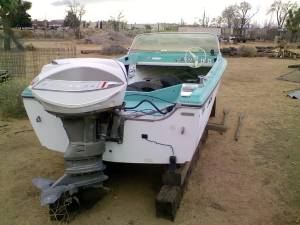

LOOKING AT BUY A BOAT WITH THIS EVINRUDE BUT I CAN'T FIGURE OUT THE YEAR OF THE MOTOR. IT 80HP

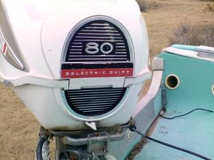

ONE MORE

I'm guessin she's a 66' model Under the cowling the model number will be stamped on the block. Not sure where though.
Re:WHAT YEAR IS THIS EVINRUDE 80HP 13 years 10 months ago #57892
i was thinking some where around there also but the owner does not know much about them and cant kind the #'s. i looked on OLD-OMC.DE and still cant find info or pictures of this model. thanks
Re:WHAT YEAR IS THIS EVINRUDE 80HP 13 years 10 months ago #57893
www.old-omc.de has cyper charts in the Misc..." section.
With model number and HP you should be able to find the year.
Model number and serial number will be on the transom bracket.
Andreas
Re:WHAT YEAR IS THIS EVINRUDE 80HP 13 years 10 months ago #57917
Yep what Andreas said. Should be on a little plate riveted to the transom bracket on the left side when looking at the bracket from inside the boat. Marineengine.com will also tell you what year it is by typing in the serial number you get off the plate.
