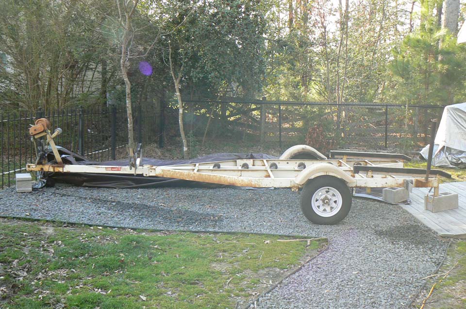

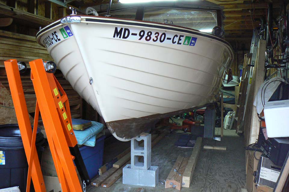

Well it finally got warm enough to start on the Clipper's trailer. Actually been low 70's all week!!!!!!!!!
Took me a few hours by myself to get this done but she's on blocks finally. Got it done Saturday.
Had to put her that high to get the darn trailer out from under her. Thank God I bought that Harbor Freight cherry picker, really helped to pick up the front deck using the deck eye. It's tied to the bow eye inside with 10 guage aluminum "bar" about 4" wide, bent to match deck and bow angle inside.
I guess I have to put the trailer restoration project in the new project forum or can I get away with it in the trailer forum?

I would feel much better if you put you block under it differently. That block is not designed to carry weight on the webbing. I seen them fail supporting weight like that. All it takes is a small crack. Not to make you mad but would hate to see it happen. :ohmy: Can't wait to see it finished.

Robert, thanks, didn't think it would be that bad but for a $1.50 each I can always go get two more. ;)

Bob. DOUBLE ditto what Robert said. Looks good though. Good luck.

Nothing like some warm weather to get the juices flowing again. The 70's are unusual for us especially when the norm high is 38. Is this going to be a tear down project or just a repaint so you can get the boat back where it belongs with a wet bottom. Either way each day is closer to boating season.
Ditto on the concrete block, not good.

Yep, definately stack the blocks on their side like the bottom one is. Those things can shatter at the least little bump , especially when vertical and all the weight directed into that center area.

Thanks for the input guys. New to this block stuff. I guess if I was still down Pensacola Florida way I'd be an old pro by now, trailer on blocks wheels off, car on blocks wheels off, in the yard of course! :woohoo:
I'll get two more blocks tomorrow on the way home from work.
Cal, it will be a complete tear down. Have most of it apart already. I'll post it in the projects forum

I had a good friend had a block break while his leg was under a truck. He was lucky enough to come out with minor injuries.
Re:It's that time! 13 years 10 months ago #57589
bob its great to see you going on your trailer,and the guys are right about the block,but i see another dangerous situation,the blocks at the stern are leaning just a little,and they slide easily when on top of each other,heck with your fantastic wood working skills,you could build a quick rack for the back of the boat,and make it so that the sides are tied together,so that they dont tip outwards,like the blocks might do,i used to put double wide mobile homes together,and blocks slide easily,especially if they are not perfectly plumb.

john, i think that's probably an optical illusion from the camera angle but I'm going to double check them again tomorrow morning. Got two more blocks to put under the front. I'm hoping it isn't up there long enough to really have to worry about it. ;) But I will double check it.
Joe, Yeah would have been a lot easier if I could have used the Gantry I made but the ceiling is only 8' in the shed and I floored in the upper storage area so I can't really mount a chain fall up there so it was a little tricky. Engine hoist ended up working just fine though.

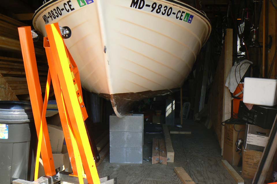

Ok, update pic with new reinforcement.
Thanks for the suggestions guys, now off to the trailer restoration thread to add more pics.
