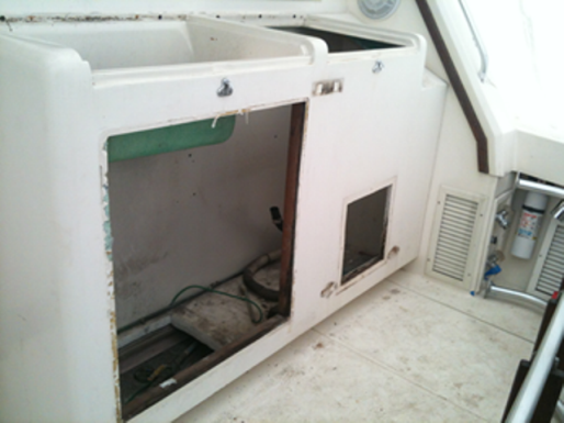

take a look at some of the photos and let me know what you think. Thanks Michael

Michael, sorry been distracted with my trailer rehab project. From what I can see in the pic it looks like it was a separate piece than the main. When you look inside the cabinet do you see any rivets of some sort tying the right side to the bulkhead? What about the let side, how is it attached to the back bulkhead? Also can't quite tell what that is along the back of the top area. Are those holes from where the tops were hinged and mounted? Is there some kind of flange that wraps down the back in order to mount it to the back bulkhead? I'm guessing it isn't mounted to the floor, probably just sitting on it and maybe just silicone sealed around the bottom to the floor. Sorry for more questions but need to know so you can proceed. If it's just riveted to the bulkheads, than you should just be able to drill the rivets out or grind the head off then pull it away from the back and side bulkhead. I wouldn't think it's glassed to the side or back but I could be wrong. Hard to tell without close ups.

I agree with Bob. If you do not want to save the box I would go at it with a sawzall or multi tool piece by piece. Start in the middle to stay away from the bulkhead. As you get closer to the sides you should be able to determin how it is attached.

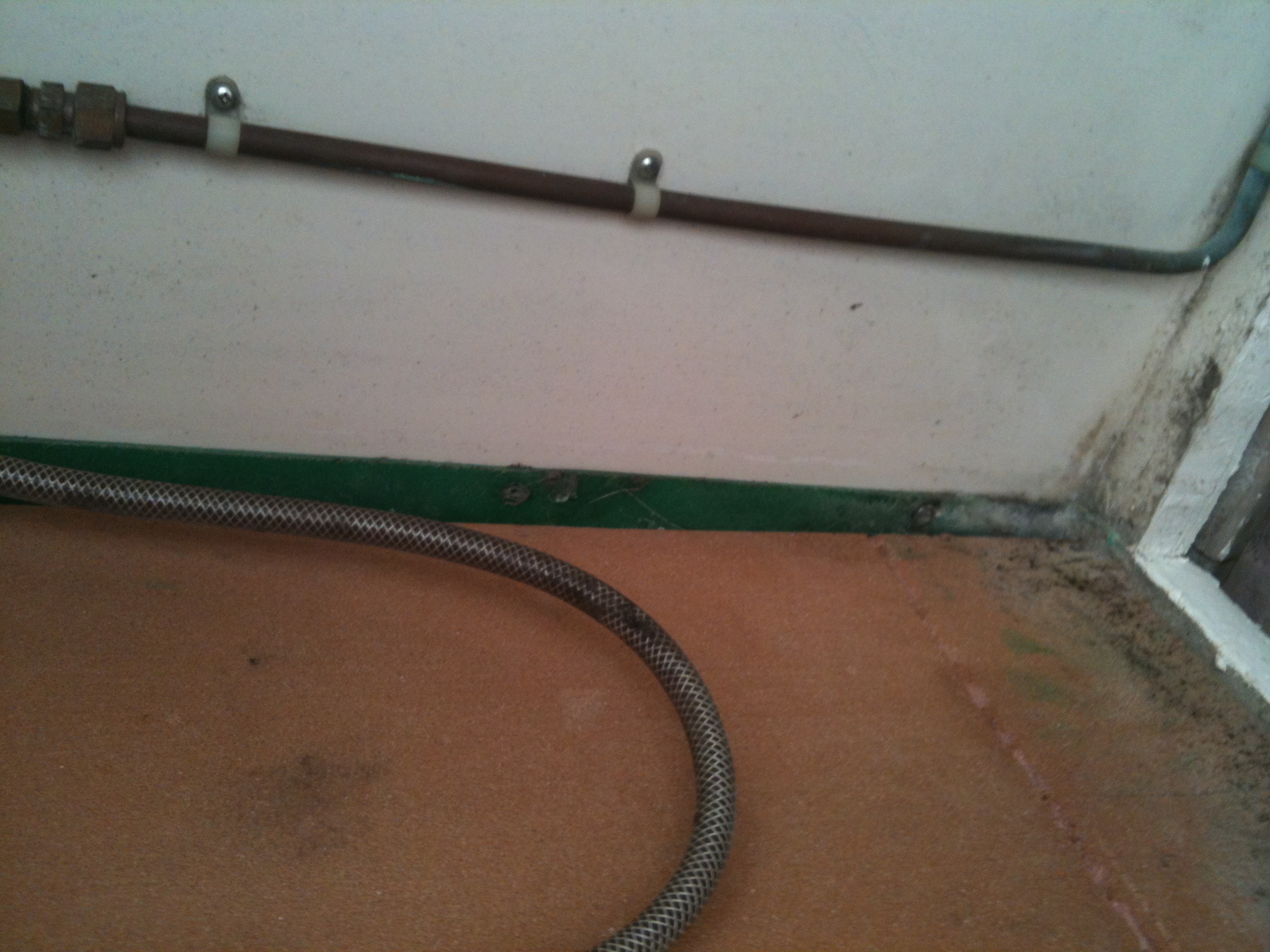

Bob:
I am trying to attach another. Those are ssrew n the back and there is a reinforced fiberglass strip in b/w the biat station and the boat. it looks like screws AND putty or resin even. Take a look. I am thinkng about ripping it out all the wat to the ladder to open up space, and placing a double chair there. I don't dare try to rebuild, but might leave part of it in place and tryo to buildig a bench w/ the guts of it.
Re:removal of fiberglass bait station from deck of 88 13 years 2 months ago #58161
Either one would work. If you know you'll never use it again then rip it out. It would give a lot more room. You could just cut the upper half off and turn it into a bench. Reinforce the inside with wood and build a top for it. Put a cushion on it and call it done. you can keep the big opening by making a door for it and use it for storage. Just a thought.
