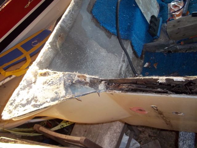

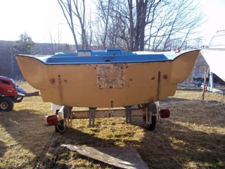

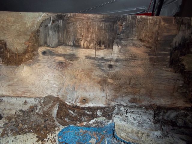

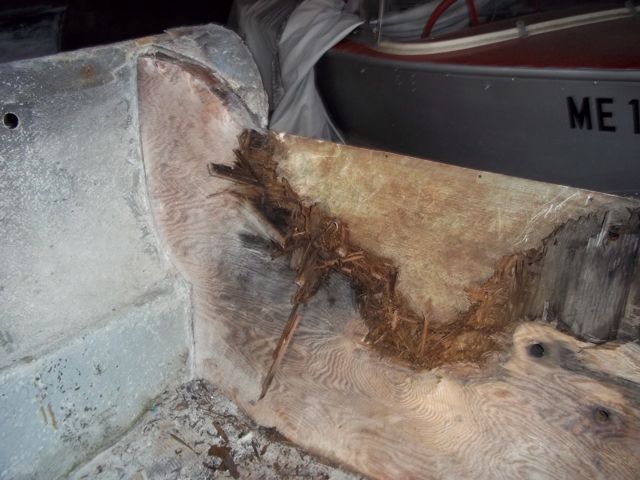

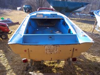

I think this is a 64 Aluma Craft Tangier. The transom had a bow in in from sitting, poorly supported, with a big fat Evinrude Starflite hanging off it. I'm hoping to put a Mer 1000 on there.
I started poking around, and it looks like large areas of the wood core of the transom have degraded to mulch. My question is, how do I get at it? I don't want to mess with the unique molded fins. I pried off the nice fin castings to get a look at the seem.
I've read about guys separating the deck from the hull, but this boat has a nice, rugged, cast aluminum piece strongly bonding the seem. I'm sure I'll wreck it if I try to pry that off.

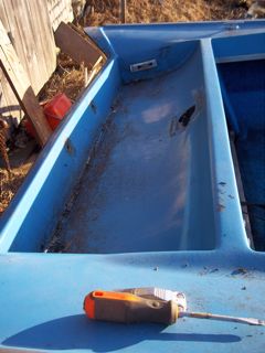

The splash well impedes access from inside the boat. Do I cut the splash, well out, preserving the integrity of the outside hull of the transom, and then try to glass that back in later? Or, do I cut away the outside of the transom?
Thanks for any suggestions!

I would cut and remove the rear section of the deck or remove the splash well.

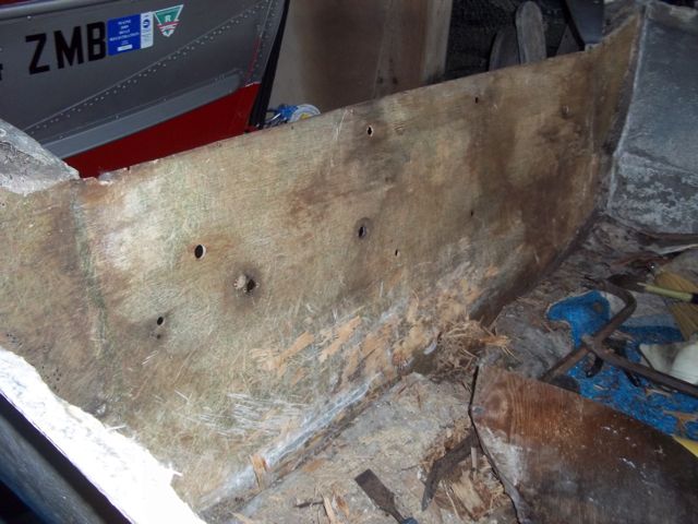

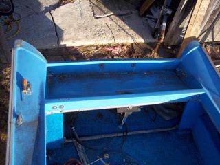

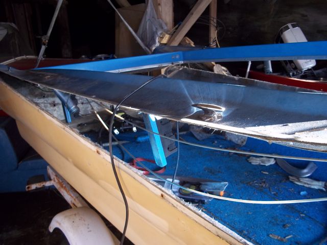

Okay, I separated the deck from the hull. A challenging task, but clearly the way to go! (thanks, again, for that advice!). Now I see that the plywood goes all the way to the ends and supports the wings. Looks to be 1 1/2 inch thick. 71 inches wide. 20 -22 inches deep. Do I need to use marine plywood? I'm going to have to sandwich some panels and encase it all in epoxy.
Any reason to go thicker than 1 1/2? I think the boat was rated for 80 hp in 1961. I want to put a Merc 1000 on there. They didn't have a 100 hp outboard in 1961. Is that why it was only rated for 80?

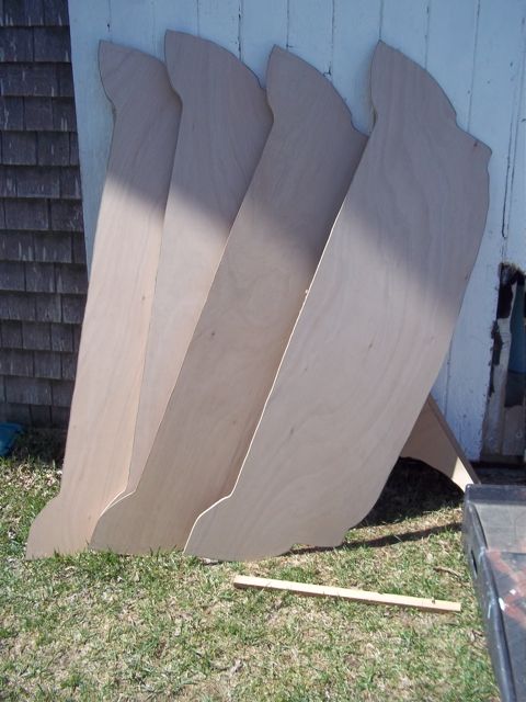

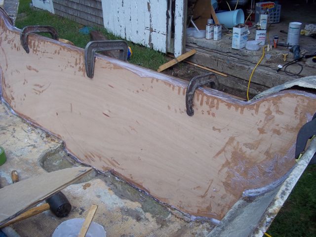

Some updates on the transom:
It was like scooping out mulch in some spots, and then difficult to remove the rest, but DEFINATELY ready to be replaced.
I bought two sheets of 8 mm Okoume Marine Plywood and cut 4 panels, then laminated them together to get the 1 1/4 inch depth I needed
