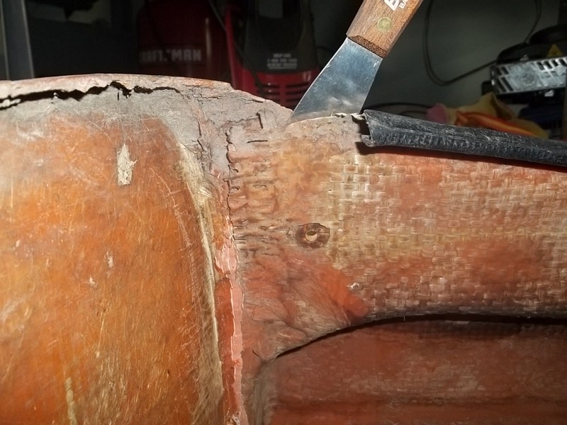

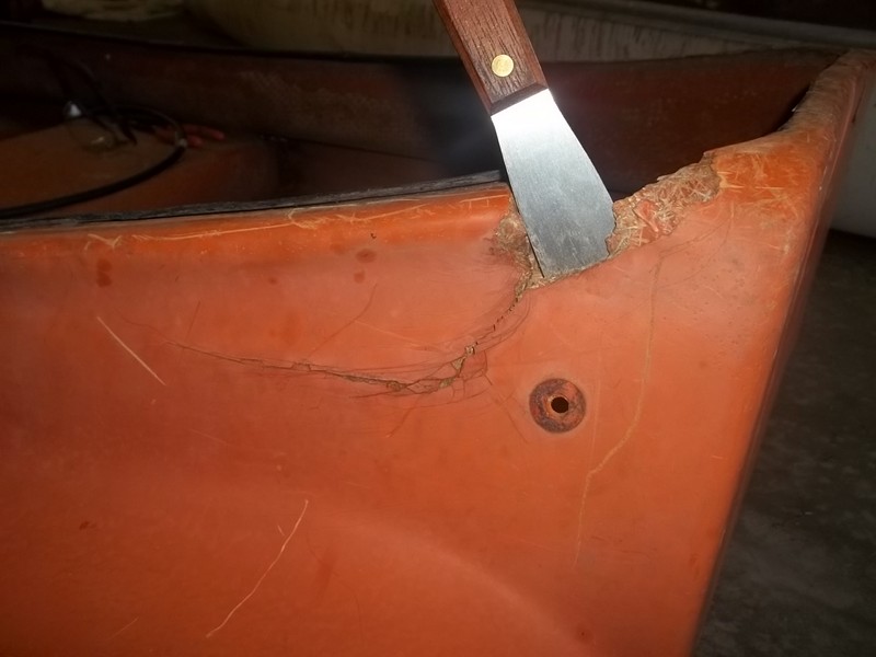

One other question on the resin... I have a "crack" on the side of the canoe that is actually the woven roving seperated from the mat. I can just barely wedge a putty knife into it. The glass seems solid on both sides and top and bottom of crack. Would the polyester resin "glue" this seperation back solid, or should I just grind the roving out and patch it with new glass? It runs about 8" down the side of the boat from the transom. Any advice?
Re:Help! Identify this and give me direction please! 13 years 10 months ago #57249
grind it back and layup new woven roven dont try to "glue it back togther " . you will need at least a 4 inch angle grinder with the coarsest disks you can find and most importantly a very good respirator not just a home depot dust mask but a air purifying respirator. Fiberglass dust and ground up polyester once in the lungs are with you till you go back into the ground . You can get very good results thinning and spraying rustoleum you can also add Valspar enamel hardener for a better gloss and harder finish , again you need a good respirator for spraying with the hardener added , that stuff can and has killed people , it contains polyisocyanate . im not a chemist but it sounds too much like cyanide so i dont mess with it lol .
