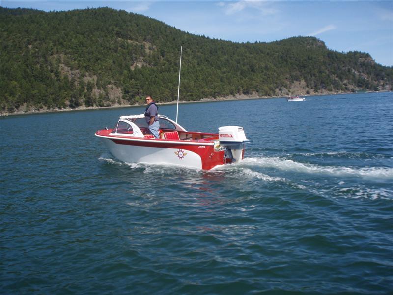

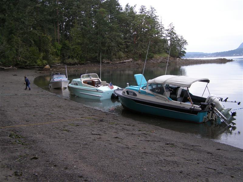

I don't know what a P-14 is but as long as its a nice day and you have all the safety Equipt. Jackets , Kicker motor or Oars ,Radio, bucket to bail , Etc you should be good and it's always better to go with another boat. Here's my 17' Skagit at Cypress Island . Word of advice - don't scare the wife first trip out or she will never go again ! Make sure she has a potty of some kind if she will buy into the bucket you are in luck but she will never hike up to the rail :)Where in Puget sound are you ? There's a bunch of us up here- Check out" Northwest Classic Boat club "
