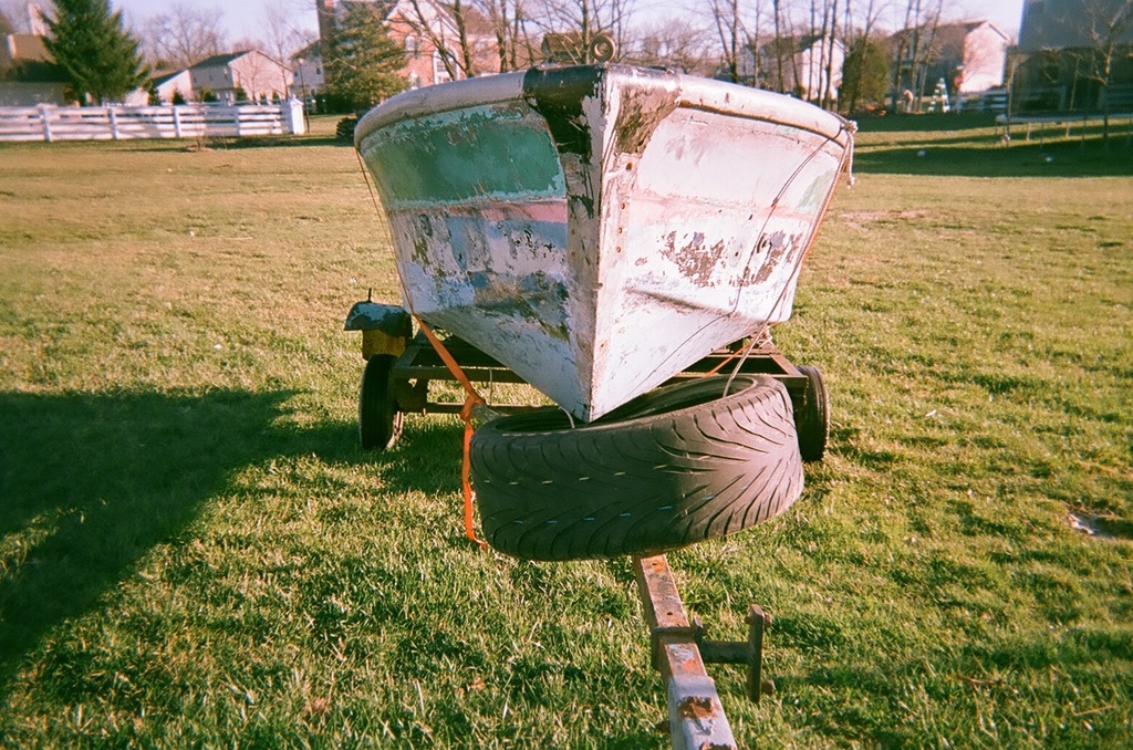

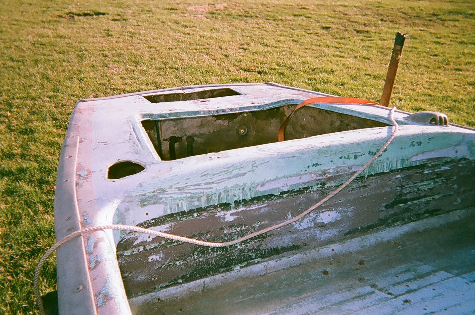

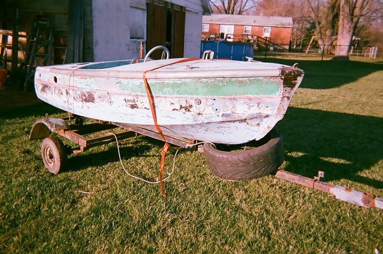

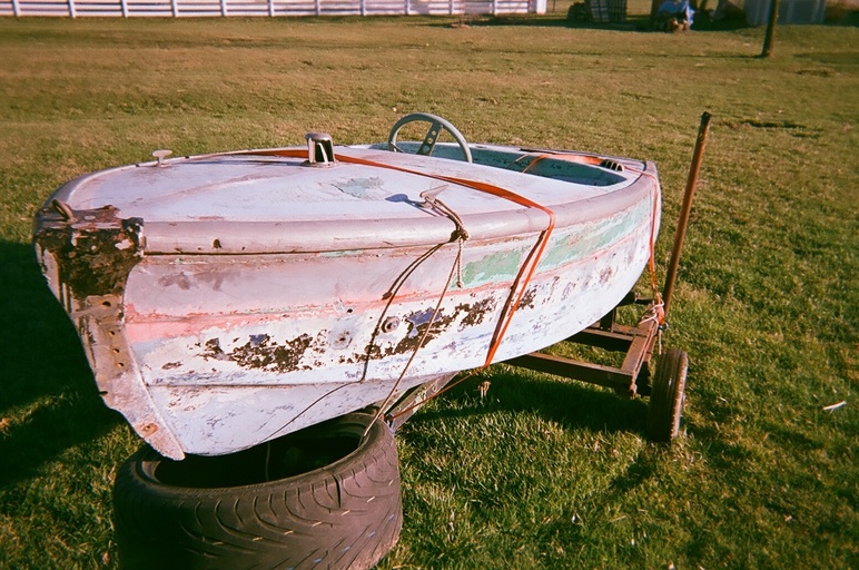

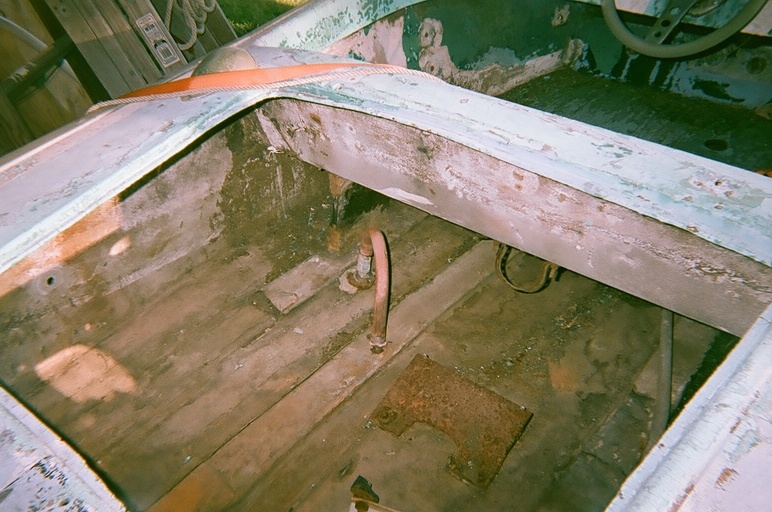

As you can see the back potion of the deck has caved in and cracked. The problem lies with the fact that the rectangular hole in the far stern should not be there, and when that hole was cut, it goes right through one of the rectangular fiberglass deck supports. Long story short, I will be fixing hull stringers that are missing or cracked, but I will have stiffen up the deck first, by fixing the hole and stiffener support. So my first question is : Once the hole is fixed,
will the deck be strong enough on its own ? Or will I have to make all kinds of bracing when I remove the deck ?
