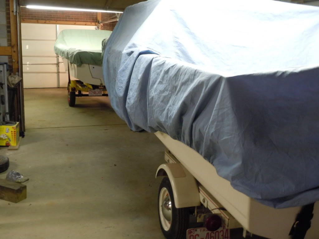

Guys,I have a old canvas? cover that came with the Crestliner that looks to be custom made for it in great condition (no tears),but tends to saturate and leak through. Does anyone know of a good waterproofing to fix this and how to apply it.jim

Thanks for the suggestions all. I'll check into it. Hopefully, it won't be outside too much. It sets in the basement most of the time,but in the spot where I have to work on other vehicles.The cover on the aristo is paper so she stays in. Some might wonder why I cover them inside? You wouldn't believe the dust from the woodstove and some woodworking/autobody work.
