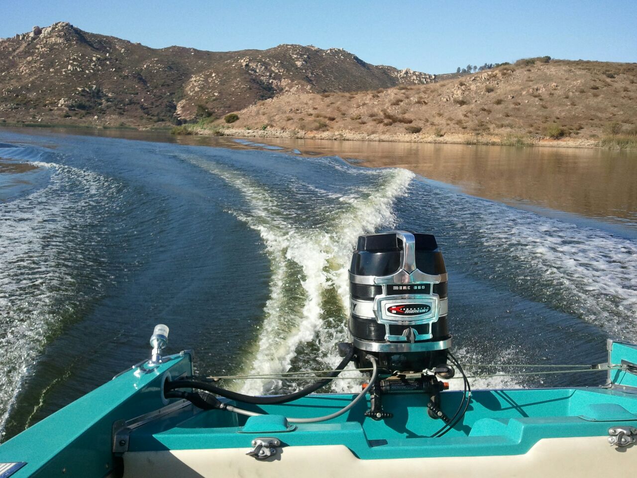

[img/] I have the same year and model. I think the Merc 650 looks great and pushes her well

Thanks for your quick response. I am still learning a lot about the different Merc. What yr. is your 650.

Re:1965 Avalon 13 years 11 months ago #56285
Avalon 65
My Merc 650 is a 1966. Magneto version. Very simple as I am new to this motor myself. Theres some great people on here with lots of knowledge that helped me get mine up and running tip top. I feel completely confident and I swear this thing looks like it was made for the Avalon. Gets her up to about 30-31 WOT with four people and an old two blade prop.

Re:1965 Avalon 13 years 11 months ago #56327
Thanks once again. What a good photo of your 650 Merc. Will look on yakaz and CG.
