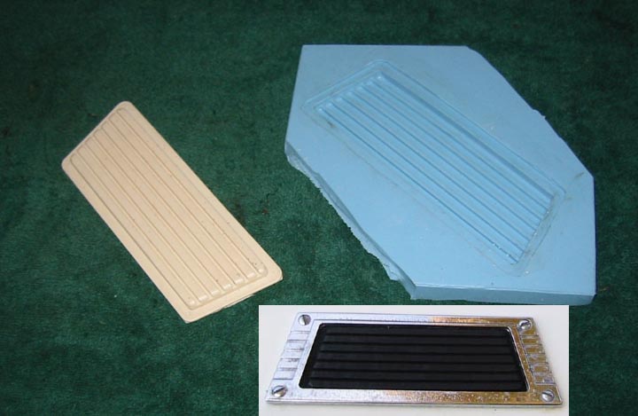

I just did a test pour to get the feel of the project and also clean the particulate out of the silicone mold, "sticky stuff" even when dry and cured
Terrific Success..... if it were dyed black instead of the white they would be a perfect replication
sadly the product is amber in color and the white ends up off white
not white/white
shipster....proceed? go black ?
its been a fun project the RTV 2 part silicone mold is the answer
bottom line...this is worth the effort for those perfect restos, easy for do it yourselfer's
Total cost including shipping for 2 part 1lb RTV silicone kit & 2 part 1 pint kit Poly flex rubber $100 to make maybe 8-9 of what you see ....the step pads I searched on the net are $20 average

I'm not exactly sure what color Amber is but if it is the one on the left in the picture, that looks Pink to me so I like Black. You can almost never go wrong with black. I'll take 4 black ones. Many thanks.

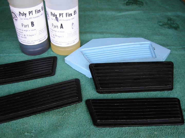

RTV 2 Part Silicone 1 lb.
www.tapplastics.com/shop/product.php?pid=61&
The trick with making the mold without a vaccuum chamber is to lay the part in a carboard box, both the box and part coated in a thin film of vaseline for a release agent, pour the silicone on top of the part .....the gas bubbles will rise away from the part
you also need to level the silcone with a straight edge as if you were screeding concrete
Poly PT Flex hardness 85
www.shop.brickintheyard.com/Casting-Rubbers_c31.htm
PolyColor - 1oz
shop.brickintheyard.com/PolyColor-1oz-PolyColor.htm
I used a shot glass & water to measure the amount of liquid it would take to fill the mold
so that I didnt waste material
Mix poly dye & rubber WELL and pour a thin stream into mold from a 2 ft height to eliminate bubbles
